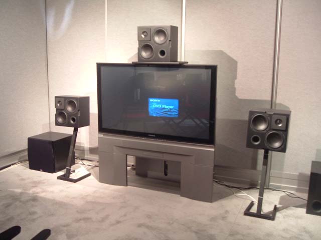

Phase Technology, today unveiled it's breakthrough Digital Reference Theater speaker system at the Consumer Electronics Show. It will be available in 5.1, 6.1, and 7.1 configurations, and will feature complete digital control.
"Phase Technology's Digital Reference Theater system takes expectations for audio realism to the next level," noted Ken Hecht, president of Phase Technology. "By using fully digital amplifiers, crossovers, and processing, our digital theater system can be specifically calibrated to produce the best balance and most accurate frequency response possible for the particular room in which it's installed. CES attendees were able to see their highly stylized speaker and amplifier design, and actually hear the Custom Box version of the system in action. With the all-digital theater system, Phase Technology is advancing the engineering standards for audio entertainment technology."
[day4_368001] Phase Technology's Custom Box version of the all-digital theater system was specifically created for custom home theater installers who design systems with speakers hidden in cabinets and behind projector screens. Phase Technology will offer the finalized all-digital theater system in the second quarter of 2005.
