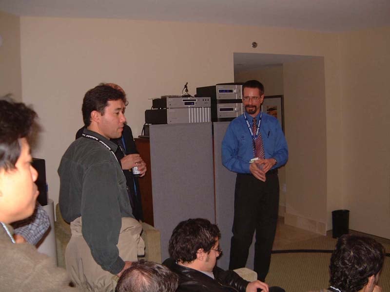

Talking about speaker designers who understand room acoustics, take a look of the four shots of the Lexicon/Revel suite. In the first shot the Lexicon electronics sit atop a wooden cabinet to the left of the left-center-right speakers. Note that the wood cabinet's front face is completely blocked by two ~20"W x ~4.5'H x 1"-2"D absorptive panels. That takes care of first order reflections from the left-front speaker. (Note also the odd size of these panels. This indicates that Revel had the room checked out a head of time and figured the exact size panels they needed for their demo, which would allow the Lexicon electronics to be mounted atop the cabinet. This layout was planned and cleverly so.)

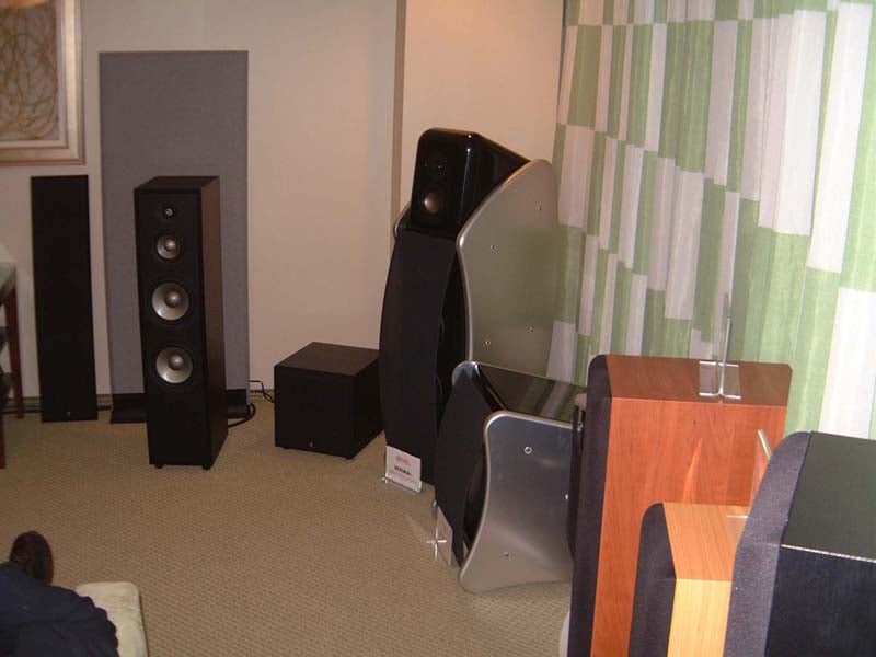

In the second photo you see new Revel C12 center channel speaker (2 x 6.5" woofers, 4" midrange, 1" tweeter, $500), Revel F12 right-left tower speakers (2 x 6.5" woofer, 5.25" midrange and 1" tweeter, $1200/pair) and the Revel B12 subwoofer (10 woofer w/650W amplifiers, $1000).
Not shown in the photo but rounding out this new "CONCERT a " line for Revel are the M12 (6.5" two-way, $600/pair) and the S12 surround speaker (2 x 5.25" mid-woofers, 2 x 1" dome w/waveguide tweeters, $500 each).
[DAY1_074] Note the absorptive panels just behind the left and right front speakers, slightly offset toward the center. The listening position(s) were almost exactly 2/3rds the way back into the room and consisted of a stuffed, cloth-covered sofa where about four Lexicon/Revel dealers could sit comfortably. To the left and right of the sofa and slightly behind were the M12 6.5" two-ways which most times were blocked by other listeners in the room who stood behind the sofa. Come to think of it, those standing listeners along with the two panels behind the front-left and front-right main speakers probably made for an excellent slap-echo killer.

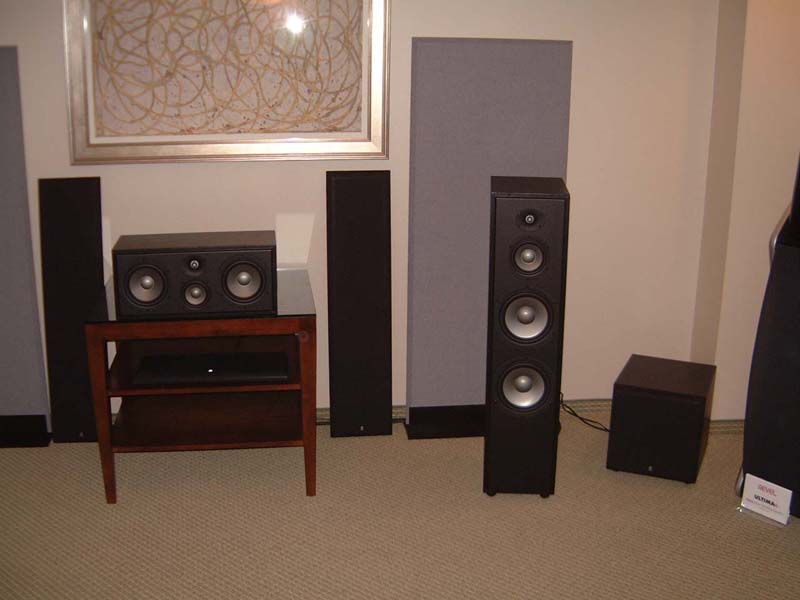

The third photo shows the right side of the listening space. The spacing of other members of the Revel family of speakers serves to break up upper bass region waves and the light but folded drapes do a decent job of attenuating the mid-high to high frequencies. Regarding further room correction that had taken place, Jeremy Frost, Lexicon's newly promoted Product Manager noted that the room had had a significant bass peak which had been removed via the single-band parametric equalizer on the B12 subwoofer. There is a manual toggle switch on the B12 subwoofer with toggle used to switch the single band of room correction in or out. So because Jeremy wanted to be a ble to switch from EQ-in to EQ-out electronically via the MC12 prepro, the single band parametric stayed in circuit (correcting the worst offending peak) at all times.
