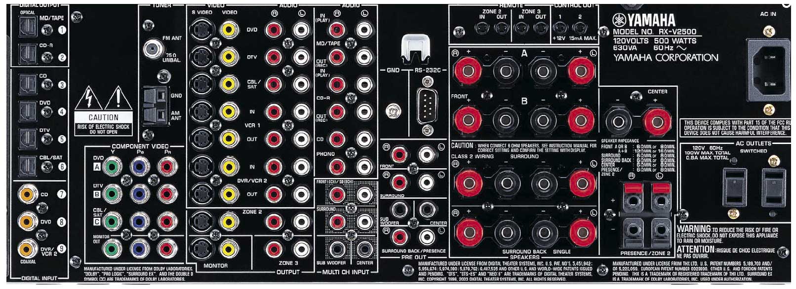

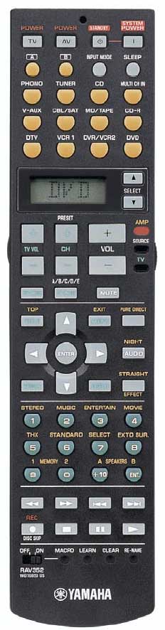

Updates already? You betcha! Still hot from its stunning release of the RX-Z9 powerhouse receiver , Yamaha revealed its newest line of receivers, including the RX-V2500 7-channel AV Receiver. Click on the images below for larger photos:

The RX-V2500 , like the RX-V1500, also has some cool features that make it easy to achieve flexible custom installation in three different rooms (zones) of the home. Zone 2 power amplifier assignability and speaker terminals mean that Zone 2 can be fully independent with its own 2-channel power, while you still enjoy 5.1-channel sound in the main room. The video signal can be output to Zone 2 as well. Zone 3 has its own volume control, and there is an IR port for remote control capability and a trigger output for automatic power-on of other components. There is also an RS-232C interface for using a touch-screen controller or a PC to configure the receiver.

Remote Control with illuminated buttons
Yes
No
Remote operational in even the darkest home theaters
