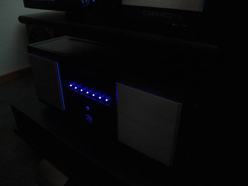

[Picture_0731]
Both the DMC-1 and MPS-1 will be available late 2004
Soothing blue lights make for a stunning visual night appearance for the MPS-1.
