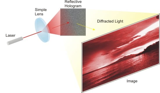

[pocketprojectors21] How does it work?
A hologram pattern, which to the naked eye looks like a collection of random dots, is displayed on a small liquid-crystal-on-silicon (LCOS) microdisplay - a tiny, very fast liquid crystal display built on top of a chip. The hologram patterns are calculated by Light Blue Optics' proprietary "hologram chip" so that when the microdisplay is illuminated by laser light, the light interferes with itself in a complex manner through the physical process of diffraction which, when carefully controlled, results in the formation of a large, high quality projected image on, for example, a screen or a wall. Unlike a conventional video projector, heavy, bulky lenses are not required: diffraction does all the work for you, and the projected image is sharp and in focus at any distance. What will this lead to?
There are a huge number of applications for this technology in fields including business, home entertainment, automotive, aerospace and advertising. At present, the focus is on 2D applications, in particular tiny personal projectors for business and home use. The illustration shows an artist's impression of a potential early product - a personal video projector, which you could download movies to and then play anywhere, using a wall as the screen. In the future, the same technology could be extended into 3D applications - while this is some way away yet, the technology could bring the holographic video displays of science fiction one step closer to reality.
