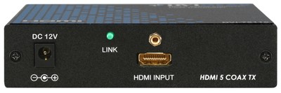

DVI Gear HDMI coax front

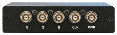

DVI Gear HDMI coax rear

DVIGear’s DVI-7510a HDMI Active Connect™ Coax Extender is a set of two products: DVI-7511a is an HDMI Active Connect™ Coax Transmitter that accepts an HDMI v1.3 input signal and converts it to four (4) coaxial signals for transmission over cable runs up to 100 meters (330 ft.). DVI-7512a is an HDMI Active Connect™ Coax Receiver that accepts these four (4) coaxial signals and converts them back to an HDMI v1.3 compliant output signal without any of the conversion artifacts often found in low-cost CAT-X extenders. Both units may be powered independently using two (2) external 12VDC power supplies included with the product. For retrofit applications, a fifth coaxial connection is supplied on both units; this extra connection allows power to be applied only on the transmitter side.
