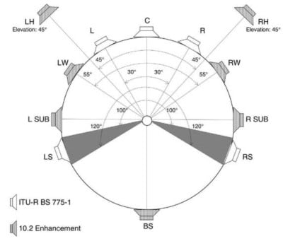

10.2 Speaker Layout Diagram and Explanation
The above diagram illustrates the placement of the additional speakers along with the standard 5.1 ITU setup. The channel naming is as follows:
L, R, C, LS, RS, LHeight (LH), RHeight (RH), LWide (LW), RWide (RW), Back Surround (BS), L SUB, R SUB
To the standard 5.1 layout, 10.2 adds speakers based on both acoustical and psychoacoustical considerations. Side wall reflections in concert halls, for example, have been found to add to the sense of spaciousness when implemented properly. Ando found through extensive listening tests (Y. Ando, "Concert Hall Acoustics", Springer, Berlin, 1985) that there is a preferred direction for first reflections, preferred spectrum, and preferred delay. The LW and RW speakers are intended to reproduce such reflections picked up by wide or outrigger microphones in 10.2 recordings. A second, and equally important, role for the wide speakers is that they shorten the gap between front and surround speakers. This allows more accurate placement and panning of sounds from front to back.
The second most important reflection in a concert hall, after the side, is the one from the proscenium above the stage. The Left and Right Height channels are designed to reproduce the sound from that direction. They are also appropriately processed and delayed to seamlessly blend with the direct sound from L, C, and R.
Finally, the back surround speaker is used to fill in the gap between the left and right surrounds to allow for both discrete placement and seamless surround ambience.

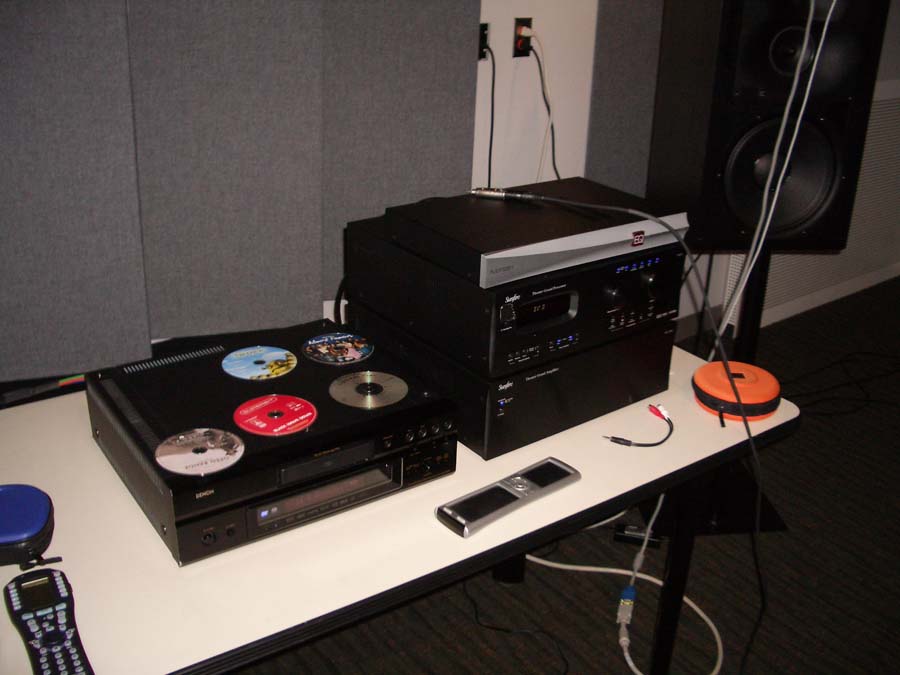

Surround Sound Demos[IMGP2542001]
While we sat in the Immersive Audio Lab, we were given a brief history of surround sound including Tom Holman's direct involvement with the birthing of these technologies. He was the first to call discrete surround sound a "5.1 system". As most home theater enthusiasts know, 5.1 stands for Left Front, Center, Right Front, Left Surround, Right Surround, Subwoofer (a limited bandwidth channel, hence the .1). The demo discussed our previously mentioned limitations of conventional 5.1 formats which included the lack of convincing front to back panning of information. According to research, human hearing has degraded localization capability at 90 degrees. The benefit of 10.2 allows for a more naturalistic surround presentation since it provides the critical height and width data our brains are most perceptually sensitive to.
At this point, our brains were nearly saturated with digesting all of this fascinating information and were finally ready to hear some demos. Audyssey conducted some demos in conventional 5.1 and in 10.2 to compare and contrast the experience.
