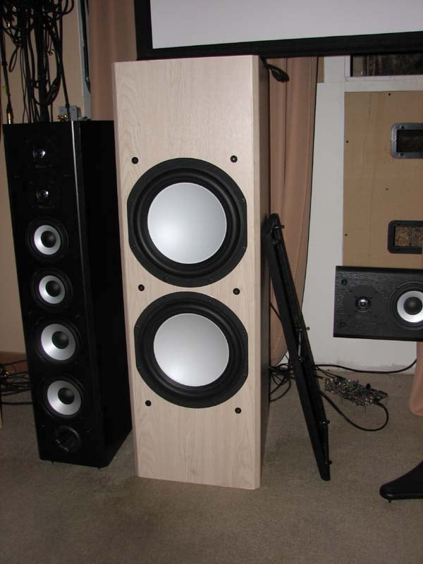

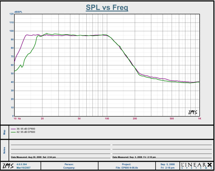

EP800 SubwooferJust when you thought Axiom was content with their EP600 refrigerator-sized subwoofer, they upped the ante by unveiling a more powerful EP800 sub to claim the throne. While the physical size is identical to the EP600, the EP800 is a sealed design. Replacing the port is another one of their 12” long throw aluminum drivers.

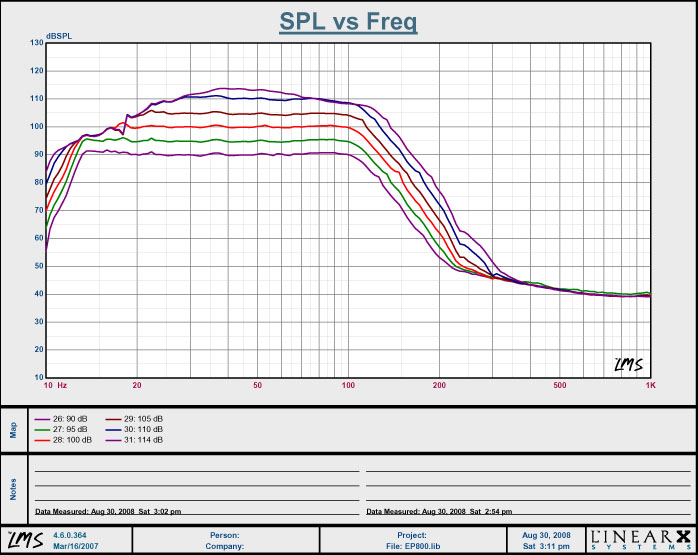

Since both drivers are wired in parallel, the rated amplifier output jumps up from 600 watts to 1000 watts making me wonder why they just don’t call it an EP1000. The EP800 has several advantages over the EP600. - since it doesn’t have a port, it can play lower without having to contend with port noise. In fact, they set the roll off to 12Hz (as indicated in the left graph below) as opposed to 20Hz tuning of the EP600. While there is no musical content down in that region, it is still pretty cool to have a sub that plays down that low. According to Ian, the goal of the EP800 is to have the widest bandwidth linearity and output in a subwoofer in its price class. As you can see in the SPL vs frequency graphs (below right pic), they certainly make a compelling argument.
EP800 vs EP600 EP800 max SPL
Ep600 vs EP800 Bass Extension Comparison SPL vs Frequency Graph of EP800 (1 meter, 4pi)
Once the EP800 is playing at around 110 dB at 1 meter in 4pi space, the -3dB point moves up to 22Hz. Above those levels, we see additional compression at both frequency ends caused by the DSP purposely limiting the output to keep distortion low and thermal compression down to a minimum. In comparison, most subs that don’t employ a form of limiting will simply exponentially increase distortion output and mechanical noise when tasked to play at their limits. Instead, the EP800 will simply play lower to avoid such sonic nasties. Another advantage of the dual driver approach of the EP800 over the single driver ported EP600 is the former can play louder at certain frequencies with about ½ the distortion since each driver will move only ½ as much to do the same work.

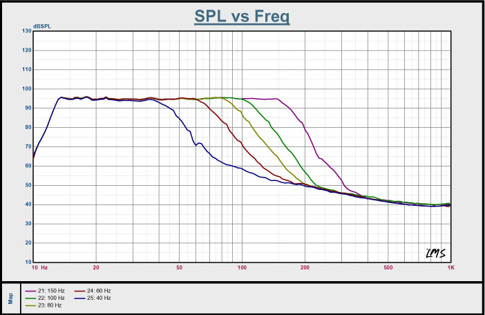

EP800 Xover points
Here is a graph of the EP800 showing the adjustable LPF intended to be used for subwoofer / satellite systems.

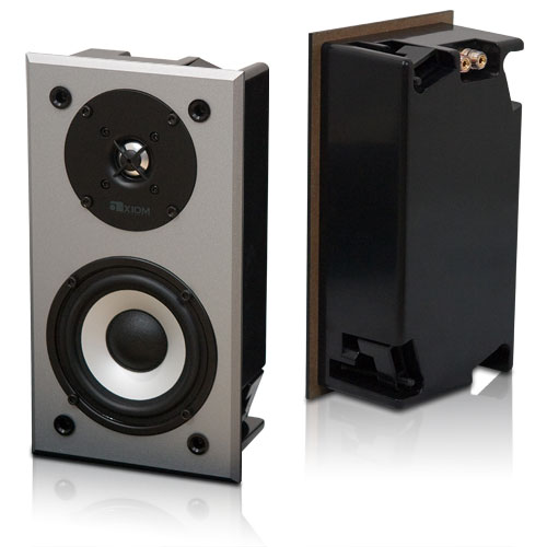

T2 in-wallsAxiom unveiled a new in-wall speaker system with built in back box enclosure that is a snap to install. Unlike their W-series in-wall/on-wall type speakers, there is no mounting bracket necessary to install into the drywall prior to installing this system. Instead, the T2 system has an efficient built-in clamping mechanism that anchors the speaker firmly to the wall or ceiling when the screws are tightened. Whether you choose to mount it in the wall or ceiling, it’s as simple as cutting the correct size hole into your drywall, installing and screwing down the clamping mechanism.
Like the Architectural series (ie. W2s), the T series include built in back boxes to provide the right enclosure volume for the system to work optimally while also better isolating it from internal wall resonances. Axiom claims most in-wall speakers recess into the wall which can result in degrading sound characteristics. Their product instead protrudes 5/8” off the wall to prevent these issues. It’s unclear as to the actual real world benefits of slightly protruding the front baffle from the wall but as I understand Dr. Floyd Toole’s most recent research, one of the main reasons people prefer identical box speakers over their in-wall counterparts is that the former have more numerous and louder lateral reflections due to cabinet diffraction. I respect Axiom’s effort to matching their in-wall speakers to the sonics of their box speakers as closely as possible so perhaps every little bit of tweaking can help in achieving this noteworthy goal.
The T2s are a two-way design in a sealed enclosure with an aluminum 5 ¼” woofer and 1” titanium tweeter. The frequency response is rated at 70Hz to 20khz +-3dB. Price of this system $446/pair, just like the W2s, and come in three standard finished (black, white, silver) or paintable MDF.
For more information on the T series in-wall speakers, visit: http://axiomaudio.com/t2.html

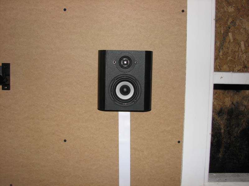

More big news from Axiom came during my recent visit in a very small package. They are gearing up to put forth a 5.1 speaker package that occupies a similar footprint to the infamous “cubed” speaker systems popularized by the company that begins with the letter “B” that many Audioholics love to hate. Unlike the typical cube speaker system, the Axiom Mini is designed with performance in mind with its 3 ½” aluminum woofer and ½” titanium tweeter. The speakers are so small (2.3 x 6. x 6.5 d x w x h)) that they practically disappear into the room once installed. Considering the small driver and enclosure, usable bass extension is limited to around 150Hz. Thus if the best acoustical blend is desired, I highly recommend pairing these speakers with two subwoofers symmetrically placed in front of the room and crossed over at 150Hz or so. If your processor has stereo subwoofer outs, this is definitely a time to consider taking advantage of that feature.
For more information, visit: Multi Subwoofer Connection Guide

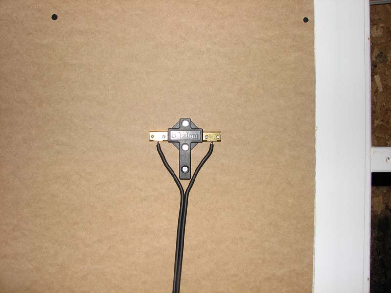

bracket    Mini
Mini bracket (left)              Mini satellite speaker (right)
Axiom came up with a slick way of installing these speakers too. The bracket actually directly connects to the speaker wire as shown in the above left picture. Once you mount the bracket on the wall you simply place the speaker over it to make the physical connection to your amplifier while also securing it to the wall (right pic). If you can’t hide the wire behind drywall, that’s not a problem. Axiom has a new paintable flatwire speaker cable that is 14AWG and the conductors are placed side by side to keep the capacitance and inductance low, essentially making it as transparent as possible. Pair this little system with a small but potent sub like an EP400 and you’ve got the receipt for what the Genie in Aladdin would consider to be “a whole lot of sound in an Itty-bitty living space!” Pricing and availability haven’t been set in stone yet but seeing how this speaker system is closely related to their computer Audiobytes, and I was looking at near production samples, I’d guess it won’t be too far off.
