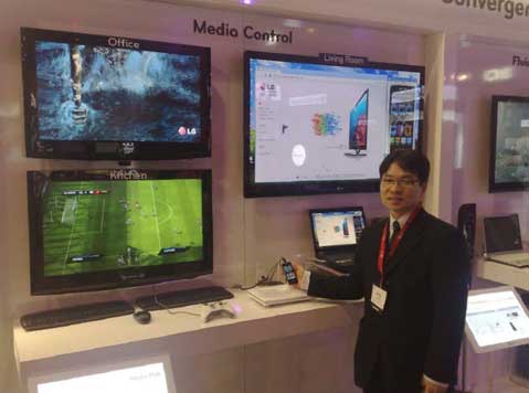

Sure, HDBaseT replaces HDMI with a standard Cat5e or Cat6 cable... but is that really impressive? No, what's REALLY impressive is that HDBaseT's protocol allows you to literally NETWORK your sources and displays just like you do your home data network. They call it 5Play. Want to watch your living room Blu-ray in your bedroom? Check. How about your bedroom's cable box in your theater room? Check. Theater room's Xbox 360 in your children's room? Check? How about allowing three televisions to watch the Superbowl from your single Dish Network set top box at the same time? Check. Check. Check.
HDBaseT enables a network of sources - such as digital video recorders (DVR), Blu-ray disc players, game consoles, PCs and mobile devices — to be connected directly to displays in multiple locations. It allows users an independent yet fully compatible experience. HDBaseT LAN-based technology makes it possible to cut out the assortment of cables for audio, video, connecting CE devices. IR, networking... it's all there. At this year's CES show, LG did a demo where they sent three different sources to three different displays and switched them at will using an HDBaseT hub (and remember, when A/V receivers pick this up everything will be switched via GUI software).
LG HDBaseT demo
Remember, 5Play is concurrent in its ability to send all of these different types of data. It converges full uncompressed HD video, audio, 100BaseT Ethernet, high power over cable and various control signals through a single 100m/328ft CAT5e/6 LAN cable. HDBaseT has the bandwidth to support the highest video resolutions such as full HD 1080p as well as 3D and 4K x 2K formats. HDBaseT is the first to provide all-in-one connectivity, making it possible for a single-connector TV to receive power, video/audio, Internet and control signals from the same cable. Here's a quick comparison against other existing technologies:
