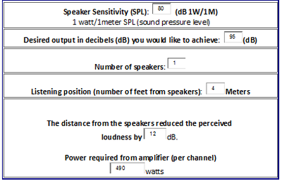

  1. First, a TV's amplifier can vary, but usually they are less than 10 watts per channel with typical speaker sensitivities around 80dB (1 watt/1 meter). However, to experience the 90-100dB peaks that today's blockbuster movies are capable of delivering, consumers would potentially need an amplifier approaching 500 watts for a listening position of 4 meters (or 13.3 feet). This is not something we are likely to see in TV's anytime soon due to cost and physical size limitations.

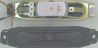

  2. To complicate matters further, the thin chassis design limits the speaker size and location which in turn affects sound quality. TV designs are getting more complicated and in some cases, such as borderless TVs, there is no room for mounting the speakers facing forward - further reducing audio performance with rear projecting speakers.

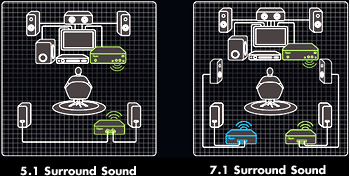

Another attempt to reduce cost and simplify the installation process is to offer a home theater-in-a-box (HTiB) and sound bar solutions. The HTiB typically includes a Blu-ray player bundled with a set of wired speakers. While the sound bar is limited to supporting a left, right and center channels bundled with a subwoofer (equivalent to 3.1) with virtual surround sound.  Both solutions achieve their lower cost by trading off the high performance and connectivity of an AVR with lower performance and less flexible connectivity, but the same setup challenges still exist.  The latest attempt to simplify setup is to offer wireless subwoofers and surround speakers that are a hybrid of wired fronts with wireless surrounds and subwoofers. The approach allows a consumer to use existing speakers, but in the end falls short in reducing the number of wires, delivering CD quality fidelity, and avoiding poor wireless performance.

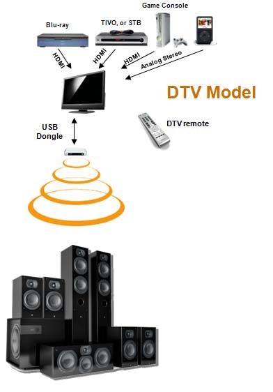

Summit SolutionA new technology has arrived on the scene called Summit Wireless, an audio integrated circuit, which is being embedded in televisions, speakers, audio/video receivers, gaming devices, Blu-ray players, and set-top boxes, enabling them to broadcast high-definition surround sound wirelessly. Summit was designed with the DTV application in mind and offers a standardized API that TV manufacturers can easily integrate into their Linux environment. What is remarkable about the Summit system is that it is self-contained; only a few commands are needed by the master embedded inside the TV to manage the audio network.  A USB 2.0 dongle option is also available to allow DTV manufacturers and other Linux based A/V equipment to claim Summit wireless compatibility now, without adding additional hardware costs to the TV platform.  The appeal for the mass market is the "fast set-up methodology" listed below:
Plug the speakers in, turn the system on and Summit does the rest:
  • Automatic discovery of speakers
  • Automatic channel assignment
  • Mapping of speaker location to within 1 inch
  • Automatic sweet spot configuration
  • Automatic scalability from 2.0 to 7.1 speakers
  • Instant volume and time alignment adjustment from a favorite listening position
Summit's patented SpeakerFinder  technology, identifies the number of speakers in the system, their location to within one inch, assigns the correct audio channel and establishes a default sweet spot in the center of the room. Amazingly this is all done on system power up in less than a few seconds.  With Summit's MyZone technology, the users' location is determined within 1 inch and can be displayed on the TV via a standard GUI application. The audio sweet spot is instantly moved to that location by adjusting each speaker's volume and delay with a simple press of the MyZone button on the remote control. The Summit Wireless solution uses a pure digital path from the source to the speaker that is uncompressed and up to 24-bit, 48k/96 kHz sample rates. Summit uses a dedicated bandwidth network away from the congested ISM band, allowing latency to be kept to a minimum or around 2.2ms and eliminating lip-sync issues. The digital filters in the Summit solution enable the speaker designer to fully compensate for amplifier and speaker characteristics, including time alignment from offset drivers, and the system can be programmed with different filter sets for different listening styles and speaker locations.
