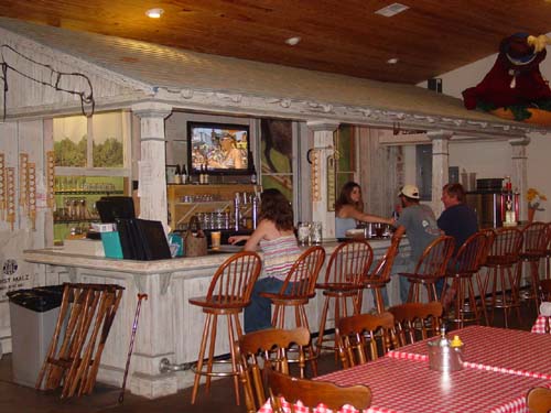

In 2006 Weeping Radish moved the brewery to Eco Farm where they now own 22-acres of organic farming. Weeping Radish resembles a self sufficient little town, with a master butcher, fabulous restaurant, farm, brewery and storefront. They pride themselves on using meats from local farmers to create their culinary delights using steaks and wursts including my favorite, the GlassWurst: named after none other than Brewmeister Matt Glass for it was he who single handedly convinced the butcher to create a Bratwurst using their freshly grown red hot Habanera peppers (and red hot they are). One of the special sites at the restaurant is the bar which is fabricated from an old storefront home built in the 1800s. Bennewitz had the front of the house reconstructed but during the dismantling process, many letters, notes and pictures were discovered behind the walls. Those historic documents are now embedded into the bar top, which adds another element of atmosphere to the place.

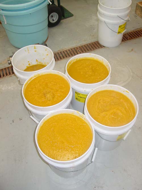

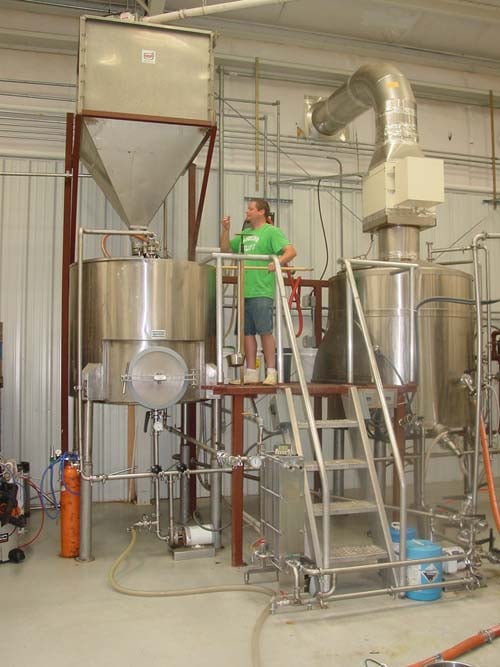

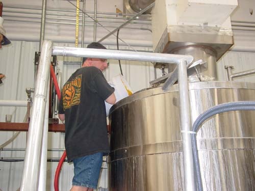

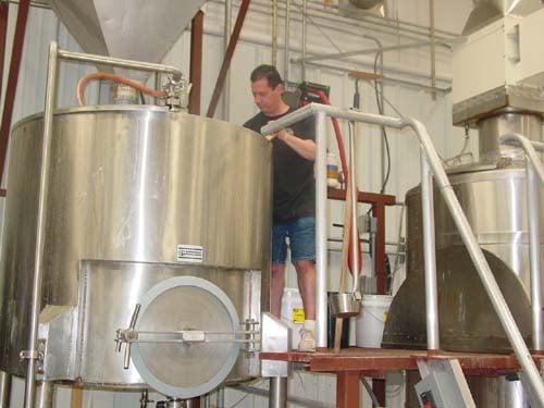

With grains cracked we began the conversion as an infusion mash for 1 ½ hours while monitoring the pH to maintain about a 5.5 ratio. This gave me plenty of time for to tour the farm and taste some of the other locally produced beers. When the mash was ready, we sparged and transferred the wort to the boil tank where we added all the remaining ingredients in the timed scheduled noted in the recipe. We definitely charted new ground for this brew. For starters, we used fresh pumpkins grown on the premises but instead of slicing and baking to caramelize the pumpkin, Glass and his helpers placed the pumpkin quarters in a smoke steamer for 1 ½ hours until they were as soft as can be. They then skinned them and placed the chunks in a grinder to create the pulp you see below.

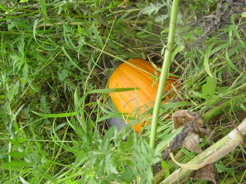

From the Pumpkin Patch
To Pulp
To Brew

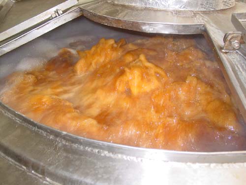

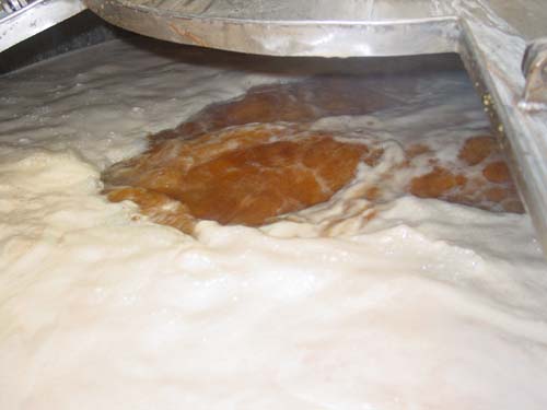

The pumpkin color looked wonderful however we had some hesitation because just about every recipe you read talks about caramelizing the pumpkins, making no mention of merely steaming them. To be safe, after adding the pumpkin to the boil, we skimmed the top surface of foam, removing mainly starches. We also decided to add pectic enzyme to the fermentation tank – something we didn’t do during previous brewing endeavors.

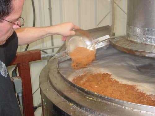

One of many spice additions
Before skimming top
After skimming top
From the moment the pumpkin and the first batch of spices hit the boil the entire brewery and the surrounding area was filled with aromas similar to grandma’s pumpkin pie. The aroma grew stronger with each addition. By the time we made the last addition, it had become so intense that people started dropping by to comment on the awesome aroma and to express their excitement in regard to sampling the final brew. Even Bennewitz was excited.
