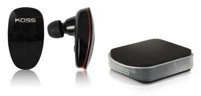

Audioholics: Tell me about the new STRIVA headphones and exactly how its components work together – the headphones, the Content Access Point (CAP) and the MyKoss website
Michael J. Koss: We think it will radically change the way you interact with your music because there is no more need for wires. Take the CAP for instance. What’s going on inside the CAP could be used in software solutions inside other devices. So, we can embed the CAP and the Core (the system inside the STRIVA headphones) into other devices. So, whether it’s a speaker or a headphone you’d be able to stream music directly. But that’s only the beginning.
Think about having all the devices interact with one another (CAP, Headphone/speaker/playback system) the controlling software piece, the big switch is MyKoss.com… sitting on the Internet. So, the backbone conducting all those conversations is really the Internet… we're just riding it.

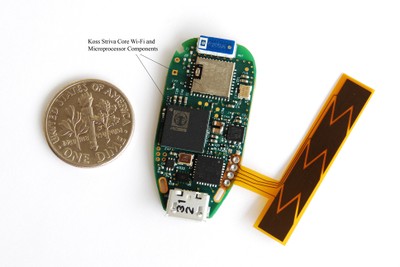

Audioholics: What exactly does the STRIVA Core refer to?
Michael J. Koss: That’s the wi-fi engine and the ARM processor. There are three component parts, there’s the STRIVA Core (consisting of the wi-fi chip and ARM processor) which is inside the headset. There’s the CAP which will provide "Content Access Points" to anything that has an analogue output. Anything that has a headphone jack, the CAP will convert that analogue signal to digital, put it into IP packets and send it to the headphone either on an ad-hoc or infrastructure basis. And then there is the central switch (MyKoss.com).
The key thing about the switch that you were getting at… looking at it as a radio station… is that switch is set up with a sniffer function that goes out and polls the Internet and looks for independent music streams. There are about 25,000 free music streams on the Internet right now. It pulls all that data and looks at the meta tags and filters that data based on the quality of the stream. We don’t want to have streams that have lots of errors on them or serve low quality streams. Then it also categorizes them by genre. So when you set up your channels, you could setup as many channels as you want. One could be Country, one could be News one could be Classical, Hip-Hop – whatever you want.
What happens is that we're not actually rebroadcasting any of the data from the switch, all we're doing is sending the IP address that identifies the location of that stream to the headphones. The headphones make an independent connection using the IP address, to the radio station itself. So, again, the headphone itself with the STRIVA Core in it is its own audio endpoint, it is its own webserver.

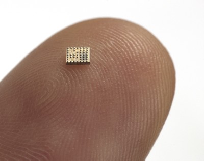

Michael J. Koss: Yes, and the wi-fi chip itself is the size of a sesame seed, the STRIVA Core can fit on the face of a dime.
