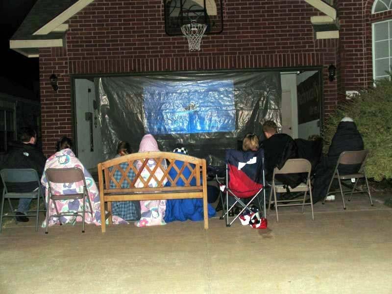

[PIC5] [PIC1] Once you've got the screen in place, the rest is easy. While it may not initially seem important, choosing the height of your projector "platform" is critical for optimum viewing conditions (I don't think anyone is going to bother with a ceiling mount for their garage). The trick here is to locate the projector close to the ground with a slight upward angle so the audience doesn't get the "hot spot" in the viewed image. Checkout the (night-time) picture above to see how I was able to accomplish this (you can see the "hot spot" below the viewed image). I used a TV-tray table to hold the laptop/PC, but just about anything will do. All that's left is cable management, and I was lucky enough to have a couple of AC outlets nearby to power the projector, laptop, and boom-box. The only extension cables required were for the boom-box: one for power and an eighth-inch stereo cable extension for the audio out from the laptop.
