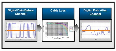

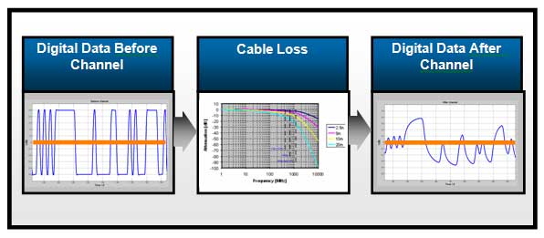

HDMI cable loss
Figure 2. Impact of Cable Loss on Digital Signals
All other conditions being equal, thinner- and longer-length cables cause higher loss. Since there are a variety of potential cable manufacturers, materials, and link distances, each multimedia installation can experience different levels of loss. As mentioned above, this loss can lead to visual artifacts such as snow or streaks, and even loss of audio since HDMI carries audio information. A solution to this, especially at longer distances, is to use actively powered technology to combat the loss and reduce the jitter. Gennum’s ActiveConnectä technology was designed specifically for this purpose. It is the only actively powered solution that can be integrated into a cable (within the HDMI connector), or in a standalone extender to enable HDMI 1.3 Category 2 performance over long reach cables. End products from cable and HDMI extender manufacturers integrate ActiveConnect technology to ensure high performance and robust signal integrity.
