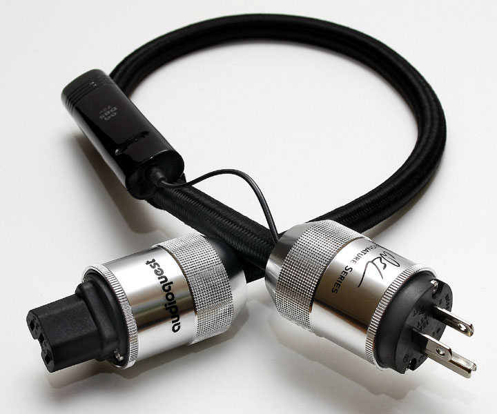

Audioquest PWRAudioquest was adamant about performing an ABAB demo, as opposed to an AB demo. Their reasoning for this was that the B cable, in the AB comparison, will always be viewed as better because people are predisposed to notice more detail the second time they listen to a track. An ABAB demo is supposed to counteract this phenomenon (The Quest Group, 2006). Audioquest’s statement that B will always sound better in an AB comparison is curious, because it is an admission that people can be easily tricked into hearing differences that are not there.
Most recently, we have seen speaker wire, HDMI cables, power cords, and iPod cables demoed. The iPod and power cable demos were the most amusing. They hooked an iPhone into the USB input on a receiver, and started the cable comparison. The first cable was the stock iPod cable, and we slowly worked our way up to the $549 2.5' Diamond cable. I found it very interesting that in the final listening test, going from the Diamond all the way back down to the stock iPod cable, the reps cut off the clip short and said, “We’ll save your ears from that so we can end on a high note.” They openly mocked the stock iPod cable and cable skeptics in one fell swoop. It was the perfect example of the overall attitude of the reps (who happened to be from Audioquest in this case). The demos seem to be configured as a hostile place for cable skeptics, and probing questions were unwelcome.
