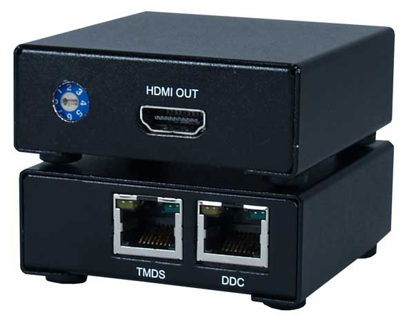

  • HDMI over Cat5Baluns (HDMI over Cat5)
    We've got companies like Atlona putting out active HDMI-to-Cat5e solutions ($329) which will run up to 130 feet of 1080p HDMI (at 1.65Gbps speeds). While that sounds expensive, the equivalent fiber solutions (another alternative to copper HDMI cables) will run you around $1000 or more. Other companies providing these types of Cat5e products include Gefen ($499), Honeywell, Intelix, Brando ($59!)

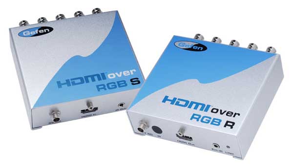

  • HDMI over Cat5eHDMI over Coax
    Yeah, baby, bring it on home. HDMI over coax is the "holy grail" of HDMI signal transmission. First of all, coax is cheap and it can go for long distances without failing or degrading - especially when coupled with an active transmitter and/or receiver. Gefen currently has a unit available for preorder that will transmit 3.4GHz HDMI 1.3 over 330 feet (100m) of coax. The unit takes either 5 coax cables (without outboard active amplification) or 4 coax cables with a 5VDC power supply. The device is retailing for $499 and should revolutionize the affordability of running HDMI over longer distances. Gefen indicated to us at CES this year that they are also working on a single-coax solution as well, though they haven't yet guaranteed the level of expected performance (it may not be able to handle Deep Color like their 4/5 cable solution). Still, we're hoping everyone is working on this solution. I;d love nothing more than to see AV manufacturers everywhere dump HDMI in favor of fully-compatible active BNC coax connections.
