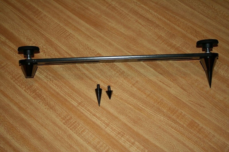

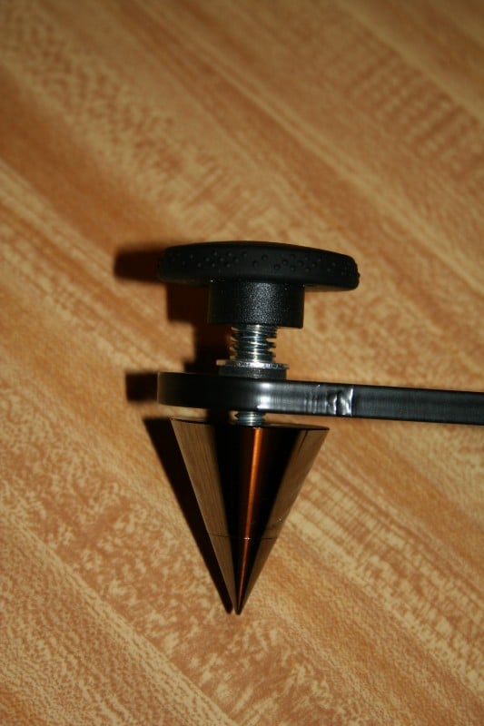

outrigger_tipsI communicated with Paul quite a bit about his product. He asked if I’d be interested in a set, I said yes, and then I had to figure out which set to order. Well, I had no idea. Luckily, I told him the speakers (Axiom m60 v2’s) and the type of floor (medium pile carpet) and he did the rest. I ended up with 9 inch “straight end” Outriggers (there is a “round end” where the metal under the adjustment knob is, well, round). He suggested using the sharper 2.12” spikes (over the 1.5”) but provided both for the purposes of the review (prices change based on the length of the bar and not the style or spike length). The Outriggers were well packed and arrived without incident.
 outrigger_long     outrigger_short

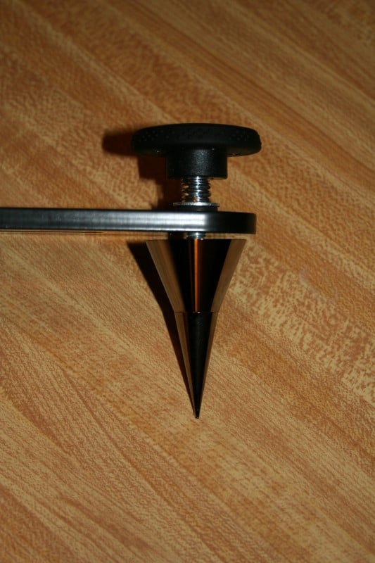

The crossbar is constructed of ¼ inch thick HRPO (steel) with a black powder coat finish. The spikes are brass and come in two finish flavors, gold nickel or black nickel. I ended up with black nickel which should really be called “silver” or “chrome”. Regardless, the finish is impeccable. Each of the cones has a removable tip so that you can install either the shorter, duller tip for a complete length of 1.5”, or a longer tip for a complete length of 2.12”. The tips screw in easily but they don’t lock in any way. I found that during adjustments, sometimes the tips loosened a bit so you may want to add a dab of Locktite on them if you’re sure you’ll be sticking with the same tip forever. The Outriggers did increase the height of the speaker probably only a fraction of an inch. You have the option of using a combination of the shorter and longer tips in order to point the speaker slightly up or down depending on your needs. For someone with a low (or high) couch, this may help a bit in getting the tweeters pointed in the right plane.
In addition to the crossbars and spike tips, I also received all steel mounting hardware (washers and bolts), some dimpled rounds (for installation on hardwood/tile floors), and some all steel with zinc plating threaded inserts… Wait threaded inserts. It was at this point that I started to get worried…

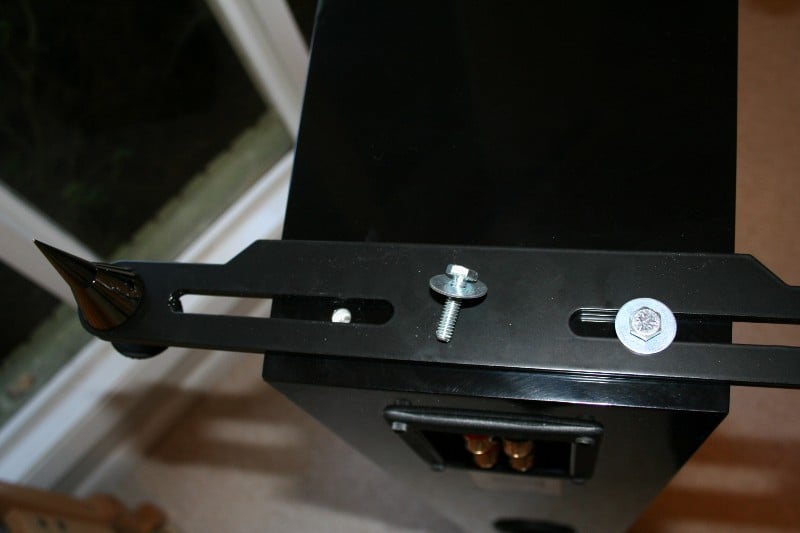

There was no included installation manual so I was off to the Soundocity website for further instructions. I was dismayed when the first picture was of someone drilling holes in the bottom of their Polk speakers to accommodate their new Outriggers. Well, that wasn’t going to be me. I decided that if the included hardware didn’t fit the Axiom installed inserts, I’d look around for something that did. Me + Power Tools = Bad in general. Me + Power Tools + Brand New Axiom Speakers = Fairly Uncomfortable Call to Gene. Yeah. Even if I owned the speakers, I’m not going near them with a drill. And I don’t suggest anyone else does either. Luckily, the supplied hardware did fit the provided inserts so it wasn’t an issue.

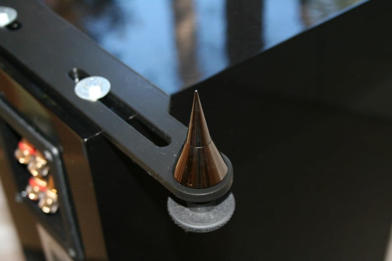

As one would guess, you just slap the things on (making sure the spikes are pointing down), tighten down the bolt (with the washer), and turn the speakers over. It isn’t exactly rocket science. I would suggest a few things. First, don’t over-tighten. I’m not sure how well each of these threaded inserts is secured but if I were you, I wouldn’t assume they are secured with liquid nails or anything. Just get it tight enough so that the crossbars won’t move around and give it maybe another ¼ turn. Don’t bust out your torque wrench, don’t try to make the Outriggers “one” with your speakers, just secure them and walk away. This isn’t a contest. Also, pay attention to the cut-in portion of the crossbar. While there are aesthetic considerations, for installation purposes, it makes it much easer to line up the Outrigger. It is much easier to eyeball how far the edge of the Outrigger is from the cut-in than it is from the ends. This practically negates the need to use a tape measure during the process.
outrigger_screw     outrigger_insall1

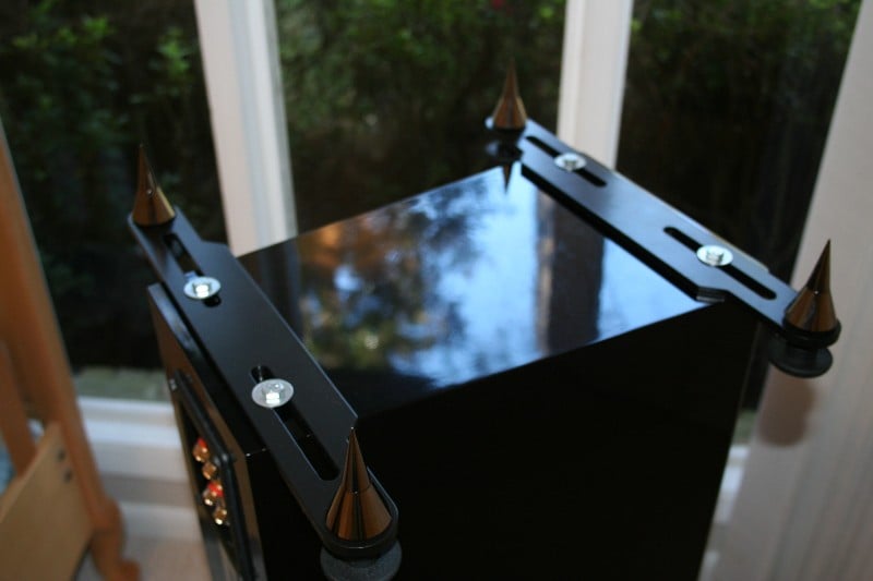

Warning – spikes can be dangerous.
outrigger_intall2Specifically the longer ones. I tried them both but found that the shorter set didn’t really pierce the carpet (which made the speaker extremely easy to level but defeated the whole purpose of the spikes). The longer set is SHARP. I would advise having a friend help you turn the speaker over. Even then, it is a good idea to try and lower the speaker straight down rather than on an angle to avoid damaging the tips. Regardless, be careful. You only have to hear a story of someone setting a spiked sub on their foot once to make you a bit leery.

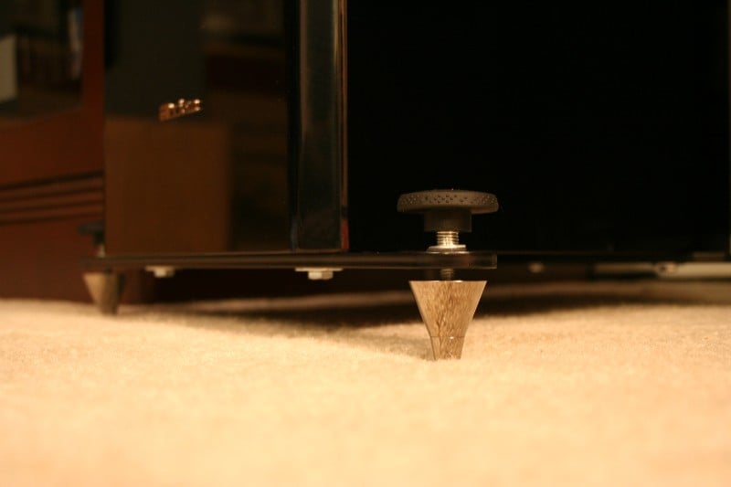

outrigger_incarpetSo, once you turn your speakers over, what can you expect? First, you’re going to have less maneuvering room. The base of the speaker is considerably wider (depending on what size Outrigger you went with). If your room is small and the space between everything is pretty close, these may make thing a bit more difficult for you. If you have lots of room, no worries. In my case, I went from having 4-5 inches to roll out my entertainment unit to only having about 1.5. Not a dealbreaker for me (and really 0” would be OK for most people – I’m one of the few that have to get behind their equipment on a daily basis) but it is a little problematic at times.
I can not express in words the convenience of having the spike adjustment on the side of the speaker. It is… an indescribable difference. I used to dread having to move my speakers. Once I got them set I’d put little pieces of tape on the ground so I wouldn’t have to guess where they once were. Being an Audioholic, I can’t help but occasionally adjust the toe in or position based on something I read, a suggestion from my compatriots, or just a whim. That mostly stopped once I started using spikes. I’d only do it if I was really dedicated to the idea. That just takes a lot of the fun out of this hobby. With the Outriggers in place, I felt empowered to move my speakers at will. Adjustments were easy, convenient, and most of all – effective.
When the spikes are located under the speaker, you end up having to lie down on the ground and either attempt to adjust the speaker while it is sitting on the ground, or continually tip the speaker up, adjust, set it back down and test, and so on. More times than not you’ll finally get the speakers set right just to stand up and realize that they are leaning a bit to one side. Sure, the spikes are level but the speaker is just a little off plumb. Back you go to the floor…
With the Outriggers, it’s a couple of twists here and there, and tada! it’s done. The knobs have a spring on them not for any functional reason other than feedback to the user. Without the spring, it is too easy for the knob to be over adjusted or knocked out of adjustment by a careless foot/leg/animal/child. The 100lbs sq/in tension spring keeps the adjustment firmly in place but is still easy for an adult to adjust. On my “less than even” floor (as Gene likes to call it) it took seconds to get the speaker sitting properly. That’s right, seconds. And when I was done, they were rock solid. Much better than anything I’d ever achieved before.
