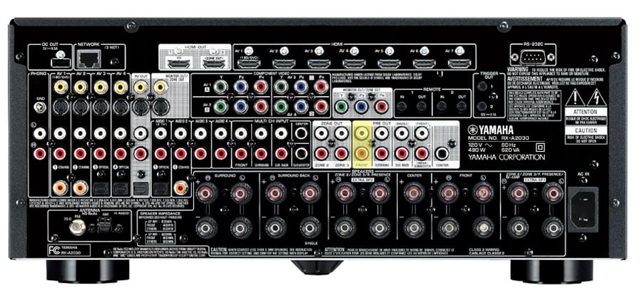

If you're fortunate enough to own an A/V Receiver that has preamp outputs to connect an external amplifier, then doing so is quite straightforward.  You simply connect a pair of RCA terminated line-level cables from the front or main channel preamp outputs of your A/V receiver to the inputs of the external two-channel power amp.
Yamaha RX-A2020 AV Receiver
Yamaha RX-A2020 AV Receiver Backpanel - notice the highlighted main front left/right preamp outputs

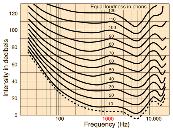

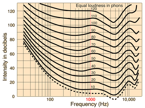

Graphed below you can see the relationship between perceived double loudness vs frequency.  If you want to calculate how much more perceived loudness you can potentially achieve by adding external amplification simply pull out the scientific calculator and plug in the following:
dB(gain) = 10*log (Pext amp / Preceiver)  where dB is log base 10 and P is power in watts
So if you're running a 100 watt/ch AV Receiver and upgrade to a 500 watt/ch external amp, then you simply plug into the formula as follows:  dB(gain) = 10* log(500/100) = +7dB
Equal Loudness Curves
Equal Loudness Curves - courtesy of Hyperphysics
Editorial Note about Equal Loudness:
It takes 10dB of added output to double perceived loudness in midrange region (500Hz to 3kHz band) but much less (around 3-4dB) at bass and high frequencies.  For more information on the relationship between loudness and the DB, please check out our article The Decibel (db) Scale and Audio Rules 101

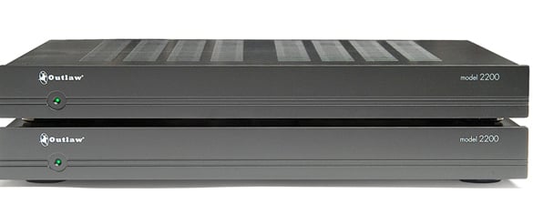

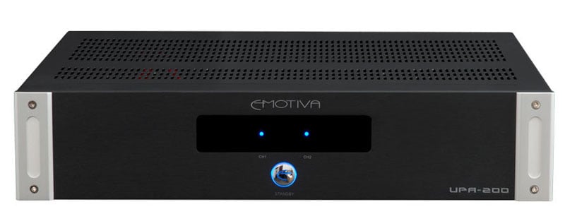

Emotiva UPA-200 Outlaw Model 2200
Emotiva UPA-200 (left pic) two-channel amplifier; Outlaw Audio Model 2200 Monoblock Amplifier (right pic)

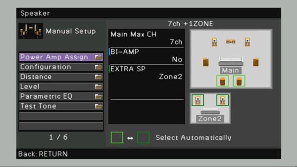

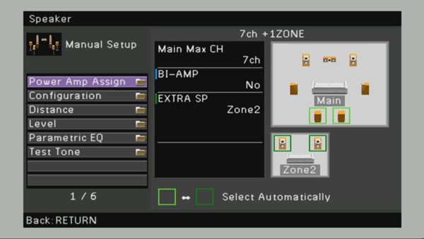

Some may fear that adding an external amp will in a sense "waste" the unused internal amplifiers of the AV Receiver.  Our answer to that is to simply reroute them.  Most modern AV Receivers allow you to reroute them to power speakers in another zone or to add height channels to do a full 9.1 speaker configuration.  Another option would be to power a second set of speakers in another room from the main zone if your receiver doesn't have multi-zone capabilities. You can turn them off by toggling the main speaker A or  B switch.  Fear not as there is always a use for those unused amplifier channels.
Yamaha GUI
Yamaha AV Receiver GUI for Speaker Assignments

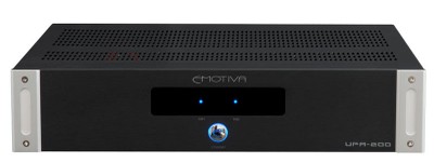

Power is cheap these days so it certainly won’t hurt to add an external amplifier for the main front left/right channels of your A/V system if your conditions call for it.   Some great and affordable options include those from Emotiva (UPA-200 costs only $349 and pumps out 200 watts into 4 ohms x 2 channels) or the Outlaw Audio (M2200 Monoblock for $379/ea delivers 300 watt into 4 ohms).  Of course if the budget allows, it's always a good idea to buy more power.  Please share your experiences in what adding external amplification has done to elevate the sound quality or listening experience in your A/V system.
