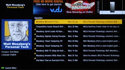

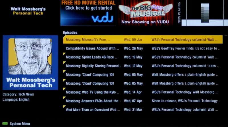

The Widgets feature of the 46UX600U are really just video podcasts that are brought int through a system that seems to be branded as "VUDU apps". They do include such services as Pandora, Flickr, Picasa, Facebook and Twitter, but for the most part they seem to be video podcast channels. YouTube gets called up as a separate application and Netflix, the popular media streaming and DVD/BD rental service is completely absent. In addition, there seems no way to download additional apps of any kind, save for those installed during routine software updates. - Gaming Mode

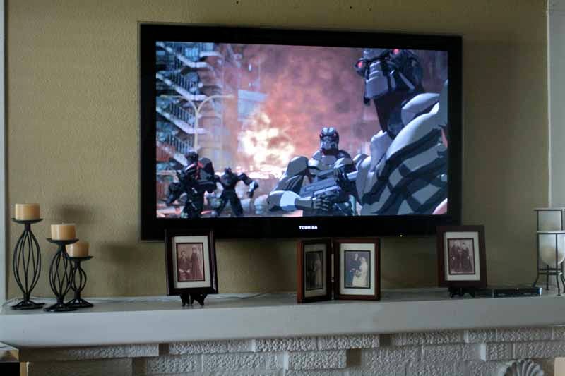

While it comes with a stand, this set really demands to be installed on a wall in a "floating" configuration. With the wires hidden, this is a beautiful television and one that will work well with almost any flat panel mounting system on the market. At 2-inches thick it will also have the correct depth with which to match up to most soundbars and on-wall speaker systems.

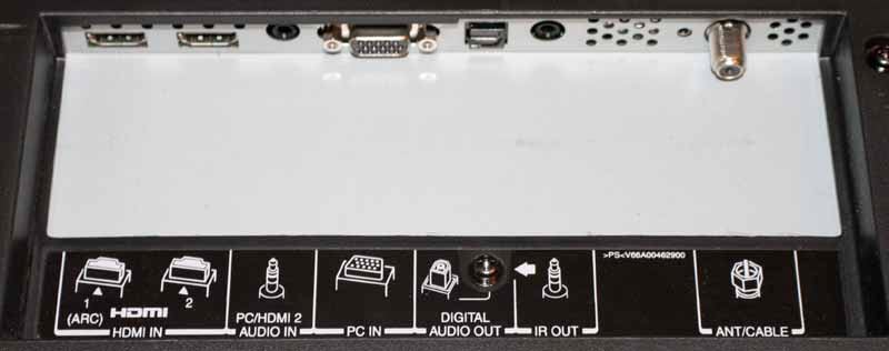

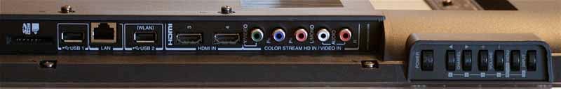

There are two locations where the display's inputs are to be found:
On the rear we have two down-firing HDMI inputs, an optical TOSlink output, RF antenna/cable input, an HD15 PC input and an 1/8-inch analogue audio connection
On the side, Toshiba's 46UX600U has two additional HDMI inputs, two USB inputs (one is dedicated for the included WLAN adapter), SD card, and composite/component video inputs, This is also where the hard controls are for channel, volume, menu and input.

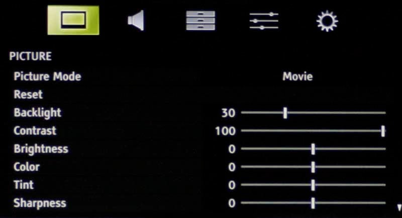

The Picture menu contains the primary color and video processing settings you'll use. Basic picture controls like Backlight, Brightness, Contrast, Color, Tint and Sharpness are all located here. Scroll down and you'll also have access to the Advanced Picture Settings that deliver access to Color Temperature controls (with RGB gain/cut), Noise Reduction, and the processing modes like Dynamic Contrast, DynaLight, Resolution+, and gamma control. We found that Sharpness continues to do its best when set at its default of 0 for best result. Any other setting either artificially blurs the image or generates halo artifacts.

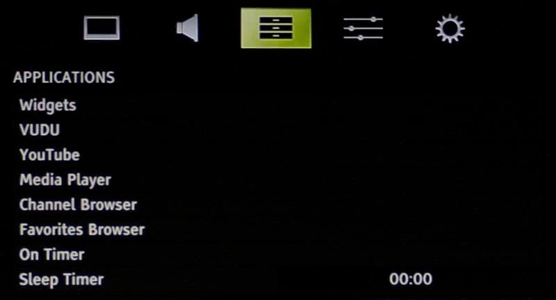

Applications
A bit of an oddball, this menu actually grants access to the Widgets, YouTube, VUDU and media player applications included with this television. Widgets and VUDU are brought up through the use of the Widgets button on the remote, but this menu provides the best way to access YouTube and the integrated Media Player (for playing back files on USB or SD card). There is also an integrated media browser with DLNA compliance, so you will be able to stream media from your PC (but not from a Mac). Other features in this section include a Favorites (channels) Browser, Timer settings and the Channel Browser.

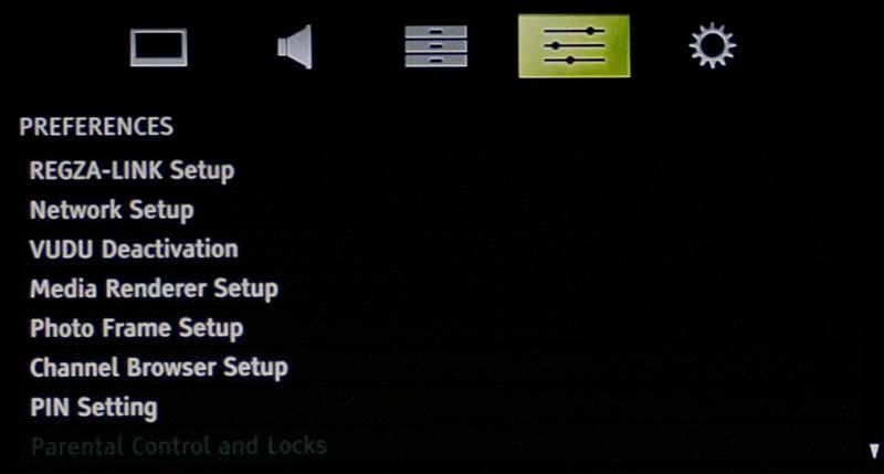

Preferences
Parental controls are located here, as are the REGZA-LINK setup, Network Setup (for configuring your wired or wireless network), VUDU deactivation and setups for Photo Frame and Channel Browser. There is also a Media Renderer Setup. What we learned from this, is that Toshiba (and others) have a lot to learn from the likes of Apple, VUDU, Netflix and Google about media streaming and interfaces. The complexity of the system, its setup, and especially the convoluted descriptions and components involved in the user manual make this something we doubt many users will take advantage of.

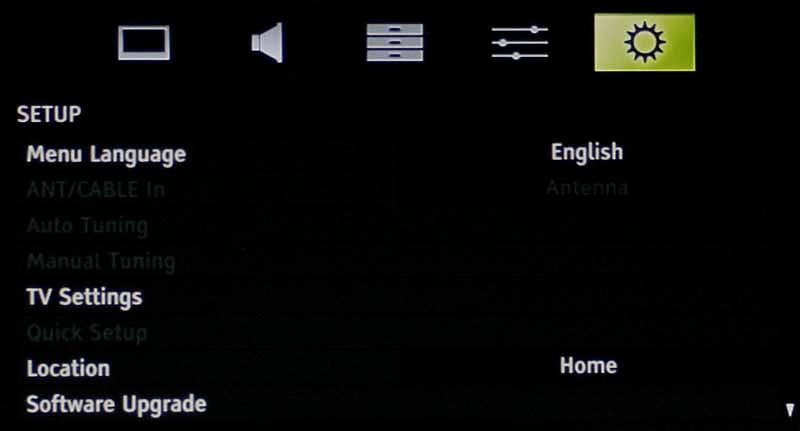

Setup
The setup menu is a sort of catch-all place for configuration options like Menu Language, Antenna/Cable preferences and other tweaks. It also manages the Software Upgrade control and Quick Setup functions. It's also here where you can do Manual or Auto Tuning of the incoming antenna or cableTV channels. For the most part, this section will be handy in the beginning of your configuration and not be touched once the set is configured and ready for use.

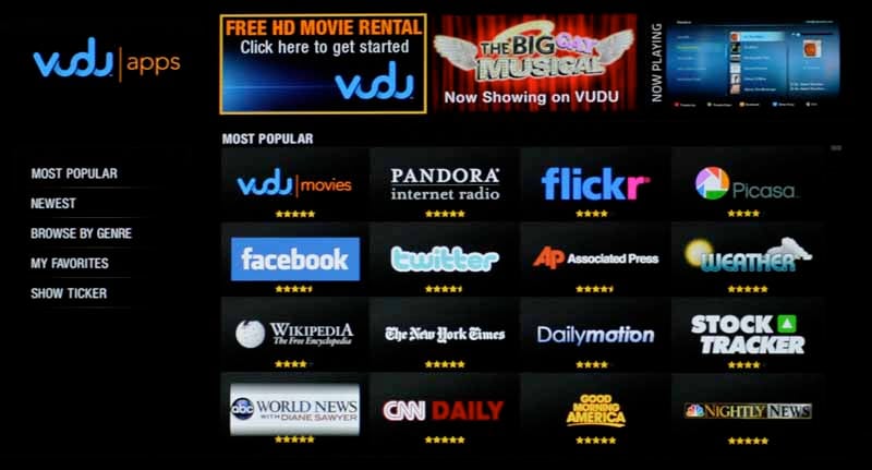

VUDU Apps, Widgets & YouTube
Toshiba is very selective in what network applications are available on their TVs. This appears to be largely the result of working closely with VUDU. While applications like Pandora, FaceBook and Flickr are available, YouTube is relegated to a separately access application and Netflix is nowhere to be found (seemingly because it is a competitor to VUDU). What this means is that while the system for Network applications is dubbed "Widgets" the visuals suggest that they are, in fact, "VUDU Apps". Either way there is a lot of content to be enjoyed, just realize that you are essentially getting a managed VUDU+ experience with this Toshiba rather than a truly open system that can handle all manner of third party applications. Given the availability to bring in Netflix and other apps via Blu-ray players and other set-top devices like a gaming console or Roku device, that's not exactly a whole lot to complain about.
The VUDU apps can be brought up by pressing the 'Widgets' button on the remote control or by accessing them from the Applications menu. As we mentioned, there is a lot to choose from. Aside from select apps like VUDU, Pandora, FaceBook, Twitter, Flickr, Weather and Picasa, the system is largely filled with select video podcasts. While there is a nice selection of podcasts, you cannot add your own favorites and the system isn't customizable with the exception of adding favorites from the existing titles. When going into one of the video podcasts, it was unfortunate to see that the titles and show notes didn't scroll, so on many of them it was hard to see what, specifically, we were browsing beyond the first few words of the description.

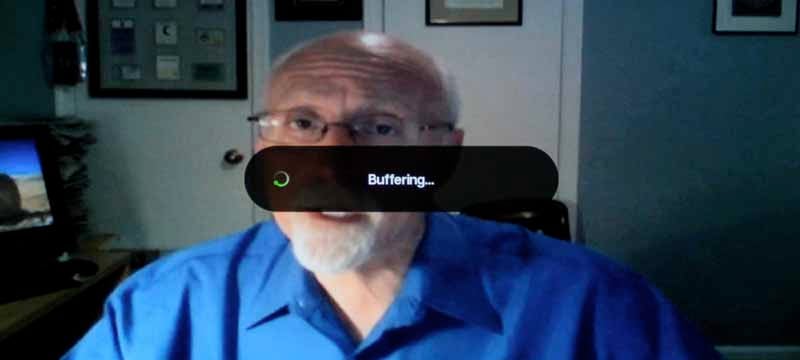

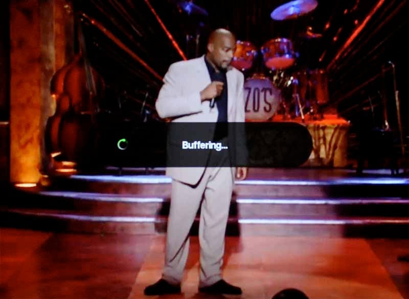

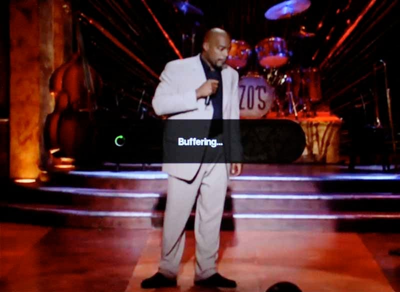

We also ran into the situation where the video podcasts would buffer while the audio continued to play. We agreed with this prioritization, however it was nearly endless once it began and the buffer ran in the middle of the screen, with the frozen video behind it and the continuing audio running. This happened quite a bit and wasn't relegated to a particular show or time of day. We aren't sure why the buffering system isn't configurable to prevent this or why Toshiba didn't specify a larger buffer in order to avoid this common occurrence. Given that we can stream HDX movies in full 1080p from VUDU, we're perplexed at why the system has issues with what is essentially highly-compressed standard definition web-video.
Yikes! Stop buffering already!

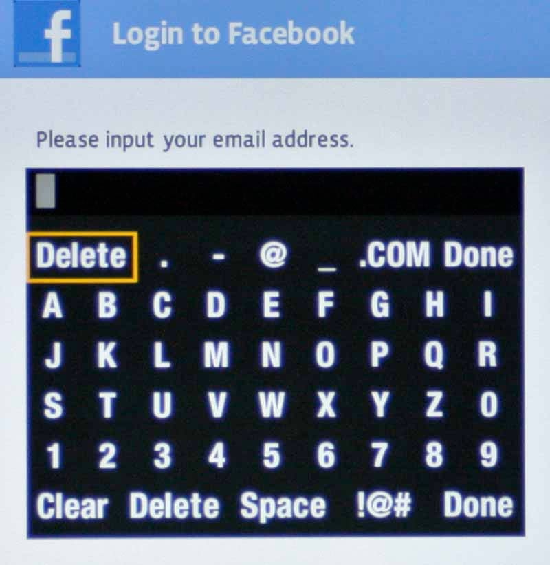

The YouTube app is only accessible from the Applications menu, another odd decision, but one that appears to be tied to the fact that YouTube isn't considered a "VUDU app". To engage in any Facebook or Twitter action, you must first log in, which is a pain as you can guess with a television remote. The good news is that the system can store both your login and password information.
Much harder than texting, but you only have to do it once...

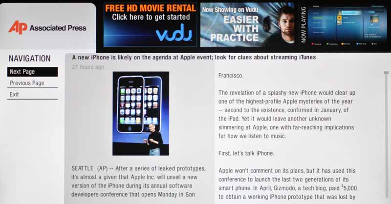

For the non-streaming apps, like the Associated Press, we found the information to be well-presented and easy to read, even from 12 feet away. You could even, on that app, change the content to be white on black instead of the default black text on white.

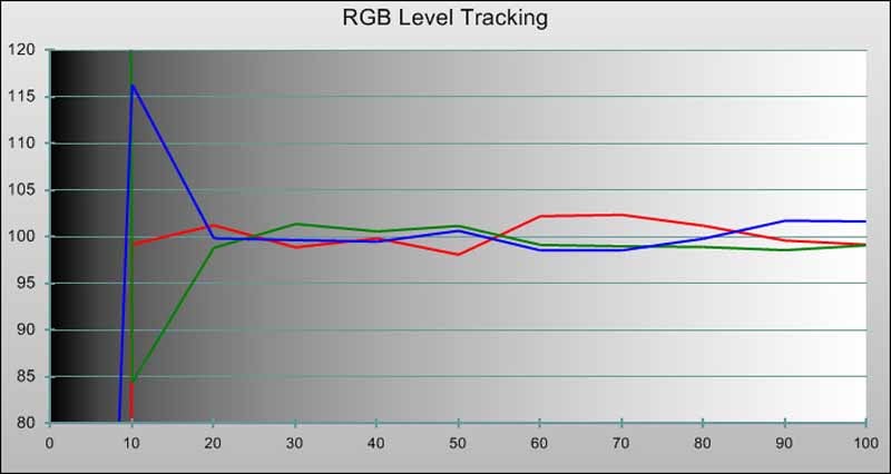

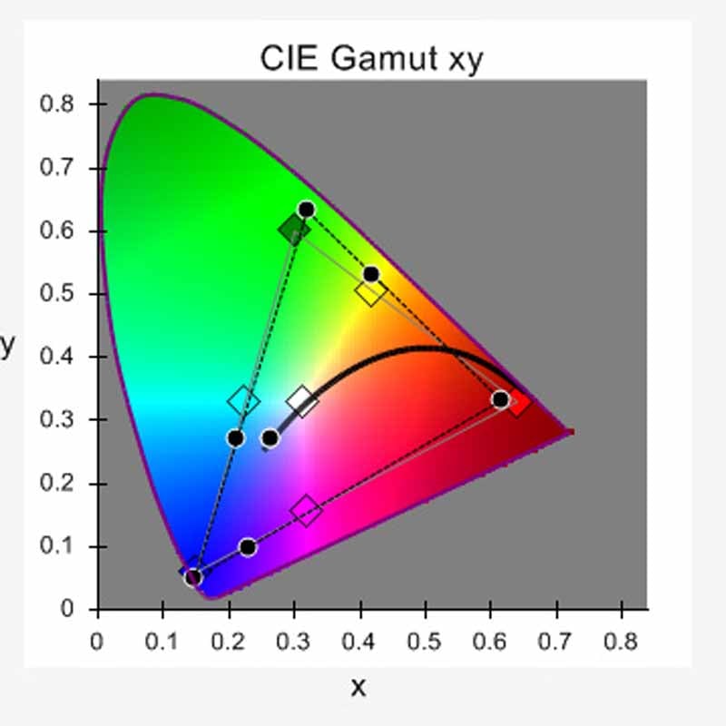

For measuring and calibration, we utilized SpectraCal's CalMan software (v3.7) and an X-Rite Chroma 5 meter. This is a great combination for reviewing LCD flat panel TVs and the newest Chroma 5 now handles LED backlit televisions. The Toshiba 46UX600U offers tons of controls, from RGB Gain & Offset controls, to Base Color Control which allows you to adjust Hue Saturation and Brightness for each color. To begin, we set the white and black levels, using several key test patterns that allow us to dial in the settings exactly how we like them (in particular we pull out either the Spears & Munsil Calibration BD or AVIA's Pro Calibration DVD). Once we dialed in the Brightness (which we happened to set to '1') and Contrast (which could go all the way up to 100 without overdriving the display) we took a measurement. Our contrast ratio came in at 2698:1 - and this was without any of the software Dynamic modes engaged! Considering the average movie theater might net you a contrast ratio of 300:1 or so, this is a very dynamic picture that holds up well to bright ambient light as well as light-controlled or darkened rooms
It was nice to see the measurements back up my initial observation that this was a very dynamic set. We got several measurements depending upon where we set the backlight, however they didn't differ much (nor should they). For night time viewing, and our evaluation, we set the backlight at '15'. This seemed to deliver a good mix of vibrant whites and deep blacks. In a completely darkened room this was the perfect setting, though some may prefer a slightly brighter display overall.

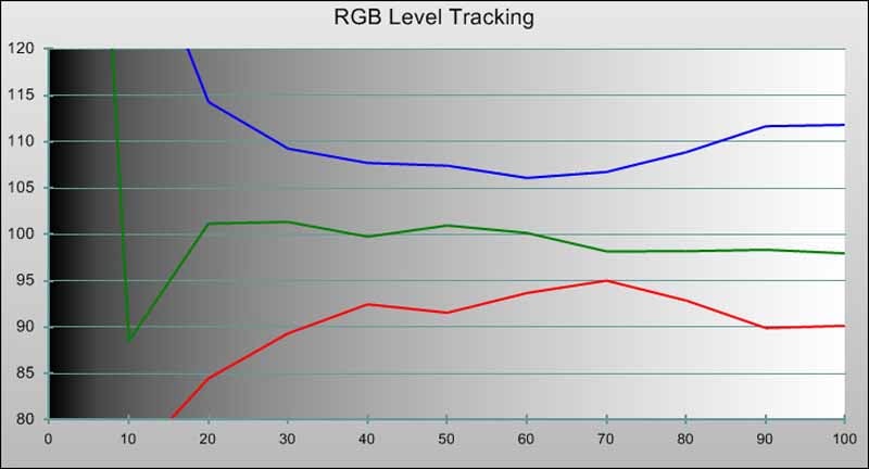

We started in Movie Mode, that being the obvious choice for best color and performance. The display is initially set to Color Temp 2, which we found to be much higher than our desired target of 6500K. Once we dropped it to '1' we measured an average of 6700K from our two test points (30 and 80 IRE) even before calibrating the television.
After we dialed in the RGB grayscale, we were able to make some pretty impressive improvements. Here is where we started and how far we were able to bring the television into compliance (all calibration started with Movie mode, though we switched the Color Temperature to '1' before calibrating):
The above results were based off using the Movie Mode with a Color Temperature 2 setting.
Our final results were much closer to what we wanted to see.
Initial color temperature, defaulted at '2' tended towards Blue, with the color coming in at over 10,000K - way too high for our tastes. After switching to '1' it was at a fine place to start calibrating - and we noted that even those who can't calibrate their TVs will enjoy a more accurate picture once you are in that mode.

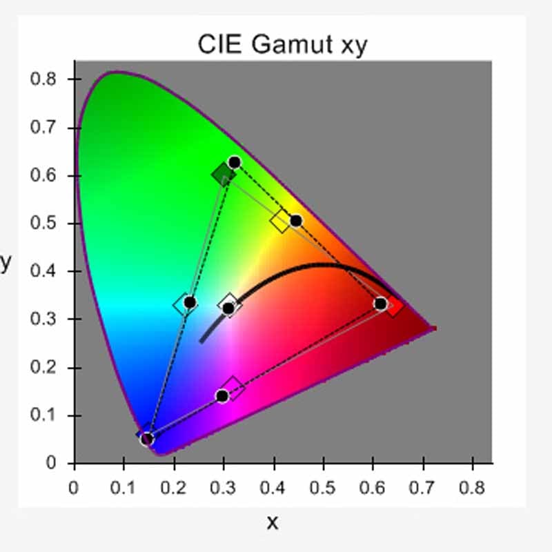

Color accuracy as represented by the CIE chart snapshot was quite a bit off on the secondary colors when we began (leaning dramatically towards Blue), and we'd attribute this to the shift produced by the Color Temperature control. After calibration the color gamut actually looked pretty good, with only a slight narrowing of the color dynamics existing between green and red. This was not something that we could notice apart from measurements, however. We also found that the entire system could technically be made to bring green and yellow into better alignment by adjusting the global Hue control - this simply didn't seem necessary, however, and we were pleased enough with the other colors to not want to compensate in this manner. Incidentally, the Base Color Controls, which are designed to allow you to adjust Hue, Saturation and Brightness for each of the six primary and secondary colors, seemed unpredictable. We couldn't use them, for example, to truly dial in the Red, Yellow and Green colors to bring them closer to Rec. 701 (the high definition ATSC color standard).
CIE chart before calibration (left) and after (right)

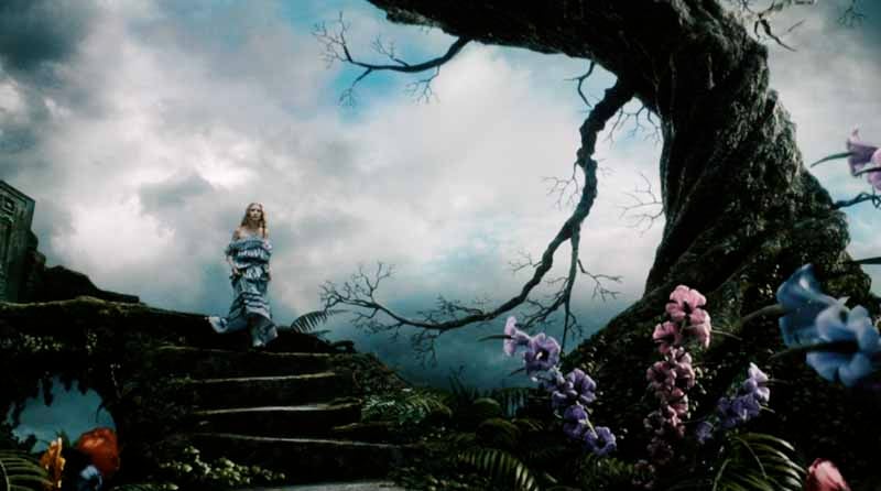

VUDU HDX: Alice in Wonderland
Vibrant color meets detail and deep, rich blacks.
All the detail of this brush and the texture of the wall came though, and the colors of the reconstitution scene were absolutely stunning post-calibration.

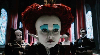

THAT is a big (but colorful) head.

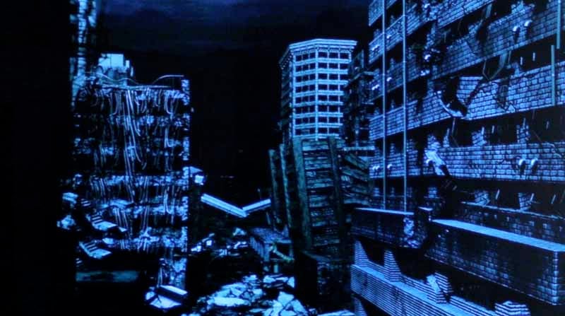

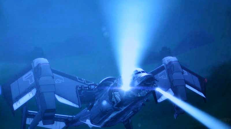

Netflix HD: Appleseed
This show is dark, both figuratively and in the way the material is presented on the screen. While not showing a lot of color, we actually stumbled across it and found it to reveal something about this television that we hadn't expected. Appleseed uncovered just how well the Toshiba's latest LED backlit television could handle streaming content and reproduce fast moving content. But what was really interesting was how the TV handled some of the embedded artifacts of this piece. This movie actually looked better on the Toshiba than on my reference Epson 9500UB Projector, largely because of the 46UX600U's ability to handle a mismatched deinterlacing error that had been made during mastering. It still wasn't perfect during pans, but the effect was rendered more tolerable by the Toshiba's video processing.
