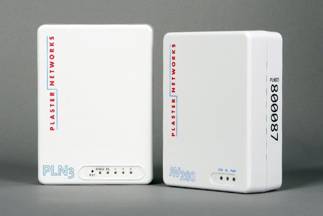

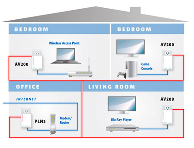

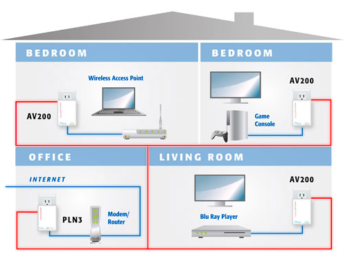

There are a number of different ethernet-over-power line solutions out there so it is hard to get excited by another one. But hold on, there is something different here. Plaster Networks (which at first had me thinking they had found a way to send a signal through drywall which would have been amazing) has a network-over-existing-powerline solution that is a bit more versatile than the others that we've seen. First of all, you can use one of two adapters (both pictured above). Usually you have a receiving unit (near your modem/router) and any number of sending units. Not so with the the Plaster Networks solution. They have two different adapters - the PLN3 and the AV200. In order for the network to work, you'll need a PLN3 near your router but then you can use other PLN3's or AV200s all over your home. The difference (other than price) is that the PLN3s have two Ethernet ports and the AV200s only have one. The PLN3s retail for $89.95 each and the AV200s for $64.95. You can get a starter pack with one of each for $129.90.
But that's not all. You can use any HomePlug AV compatible unit with the Plaster Networks products. So if you have NetGear XAV101, Linksys PLE300 or Belkin Powerline AV adapters (or can find them on the cheap from somewhere) you can use them in your network. There is a handy guide to tell you how integrate them on the Plaster Networks website and it seems fairly straightforward. One of the best parts is that the Plaster Networks solution supports up to 64 devices per network with speeds up to 200 Mbps.
