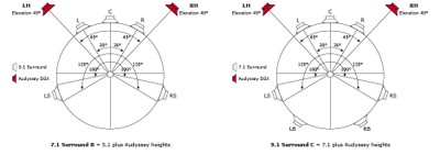

3) If you pan front from the front to the surrounds, it is nearly impossible to get the sound source to appear to go behind you with only the two rear channels at 110 degrees.  For this reason and others, 10.2 employs a center back channel, located 180 degrees relative to the listener.
4) Because height is also an important element in recreating acoustic space. (Not as important as width, but important nonetheless) a pair of channels are added at 45 degrees off the center front, and 45 degrees high relative to the listener.   A sound source with height can best reproduce reflections from a high ceiling, adding an additional dimension of space to the recording.  We were able to listen to some choral music during the hour or so spent in the USC multimedia room, and the high speakers made a dramatic difference in the source height and sense of space.

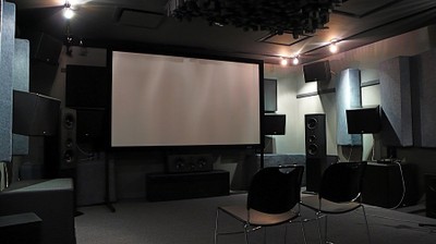

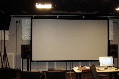

audyssey surround room
Audyssey's Surround Sound Room
