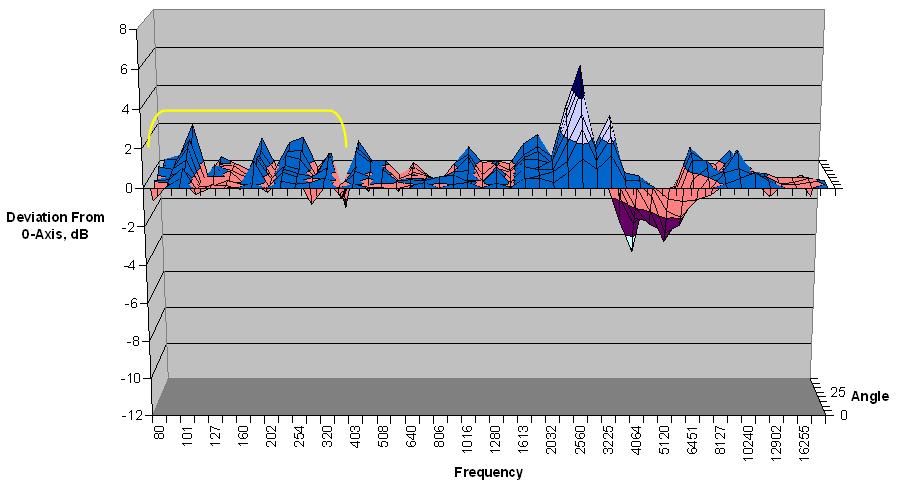

The 1/24 octave chart below shows a generally inaudible difference in the speaker’s response across various angles. The frequency range of the redundant drivers, from 80 to 350 Hz, is highlighted by the yellow bracket.

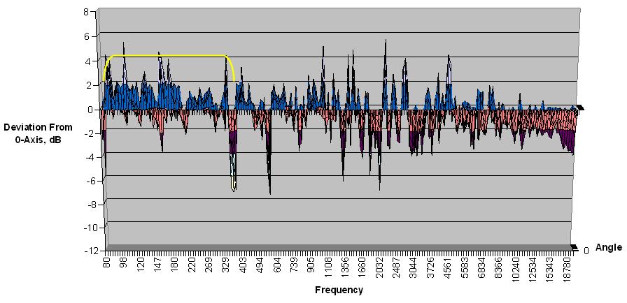

In the 1/6 octave chart below, the off-axis response of this speaker was nearly perfect. We can see one significant -5 dB wave cancellation from the woofers interfering with each other just above their crossover point at 360 Hz. Even though this would be audible, because the entire effect is such a narrow bandwidth, this really isn’t something to worry about. The off-axis response of the tweeter is fantastic.
The standard deviation of the frequency response from the two woofers calculated to 1.02. This was by far the best performing horizontally oriented configuration.
