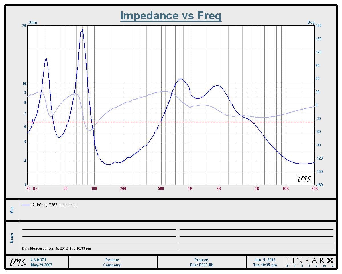

An impedance analyzer is used to measure the loudspeaker’s impedance as it changes with frequency.  The lowest impedance is measured at DC, which is also known as the DC resistance. The IEC method of specifying nominal loudspeaker impedance is set such that minimum impedance must not fall below 80% of nominal, so for an 8 ohm speaker this would be 6.4 ohms minimum, and for 4 ohms would be 3.2 ohms.
Infinity P363
Infinity P363 8 Ohm Rated Speaker Failing IEC Specification

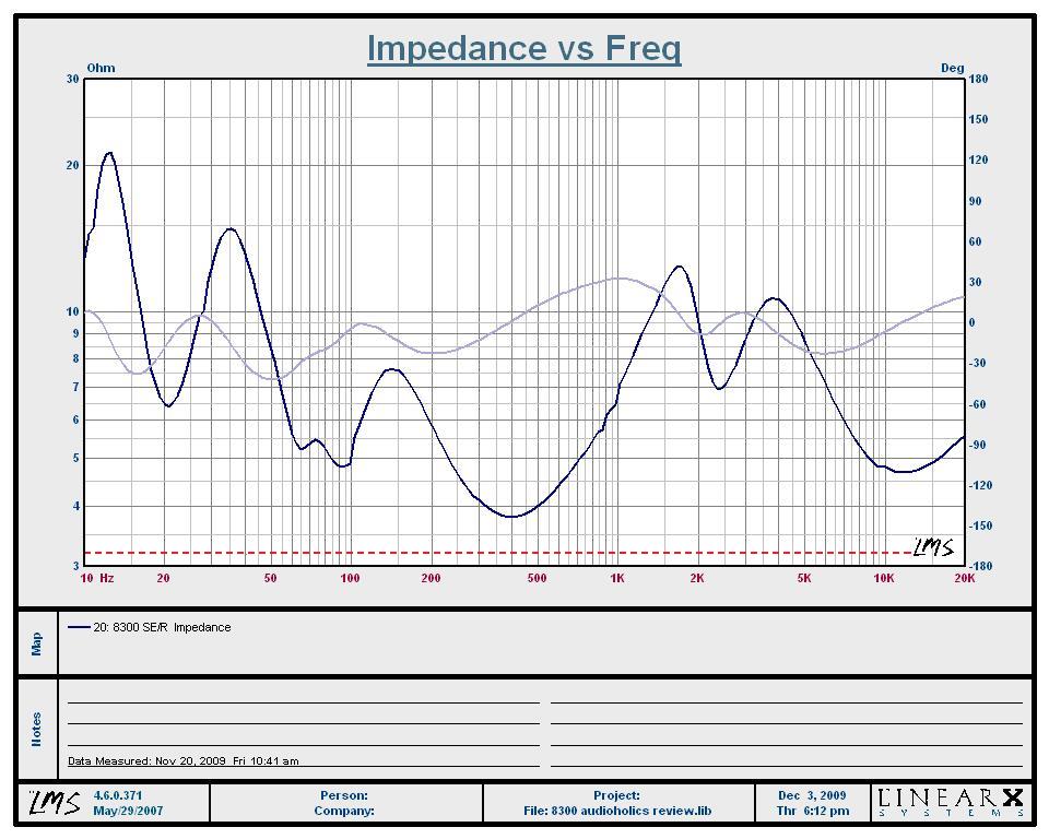

RBH 8300
RBH Sound SX-8300/R 4 Ohm Rated Speaker Passing IEC Specification
As you can see in the above impedance graphs, the Infinity speaker measured well below the 6.4 ohm minimum to be classified as an  8 ohm speaker by the IEC method.  In fact, it's off by a great margin. This speaker purposely utilizes a 4 ohm tweeter to boost sensitivity which affects its overall impedance value.  The RBH Sound speaker truly is a 4 ohm speaker as specified by the manufacturer. In fact, as you can see by the dotted red line, the impedance stays well above the minimum 3.2 ohm mark to be classified as such by IEC method.
