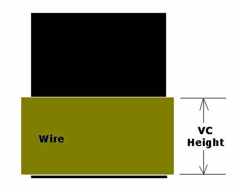

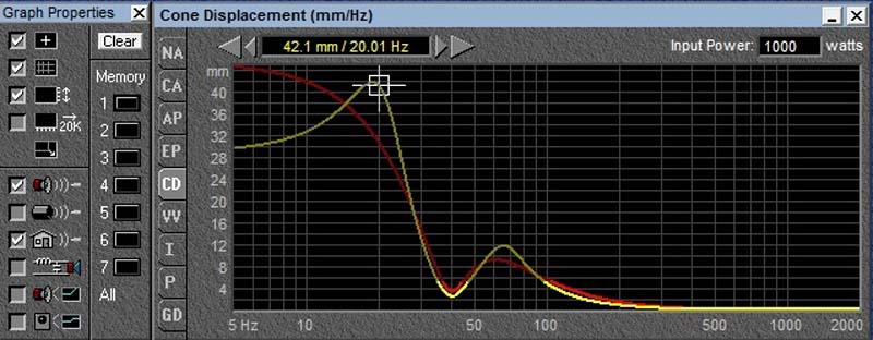

Let us look at an example where the B*L falls off by about 37%, a very modest and realistic figure for a VC coming slightly out of the gap. In the graph above, the orange line represents a speaker with a BL product of 19 T-M versus the yellow line which is 12 T-M (37% less). As we can see from this model, we need the speaker with the 12 TM to move 42mm (1.65 inches off center in each direction) if we attempt to drive it with 1000 watts at 20 Hz in a box tuned at 40 Hz. This would require a VC on the order of 100 mm in height (not diameter) but VC height. (See diagram below)
Voice Coil
Voice Coil
A typical VC is around 1 inch in height, and has perhaps 8-10 mm (about 0.35 inches) of excursion available by virtue of its height exceeding the top plate thickness. (We call this overhang). So what will happen if we attempt to power 1000 watts into this typical speaker at 20 Hz? In all likelihood it will break by smashing its parts together (bottoming) long before the VC even has a chance to get hot.

We know from the earlier example at middle and high frequencies the excursion is small and as we go lower, the excursion increases dramatically. If the signal used is placing its power across the full bandwidth of the audible spectrum in varying amounts (as it should be) then this signal will most likely burn the VC before it breaks the speaker. Suppose now, we go back to the earlier example of the vented speaker tuned at 40 Hz and drive it at 20 Hz.

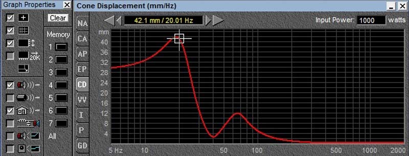

1000 watts 20Hz
1000 watts @ 20 Hz
We notice that at 20 Hz, the excursion of this speaker is predicted to reach 42 mm at 1000 watts. I said predicted, because the program running the model assumes (as most of these programs do) that the speaker can actually move that far without destroying itself. Well, it cannot. In short, we are asking this speaker to destroy itself. Suppose instead of using a continuous signal of 20 Hz, we simply use a tone burst. Ten cycles on, Ninety cycles off. That means for 90 percent of the time, the power applied is zero watts. Since we need to break this speaker with 100 watts, we will make the tone burst (during its short duration) 1000 watts. Divide that by 10, and this averages to 100 watts RMS over the course of the power test (which is hours long). Since the crest factor of a single frequency continuous tone (sine wave) is 3db, and the signal is 1000 watts RMS (for 10% of the time) the peak power is 2000 watts, and the RMS is 100 watts, so the crest factor (ratio of peak to RMS power) of this test is 13 db. This crest factor is not standard or similar to power test signals at all, but it is not unlike music either. The spectrum however, is definitely unlike music, and designed in concert with the crest factor to BREAK this speaker.

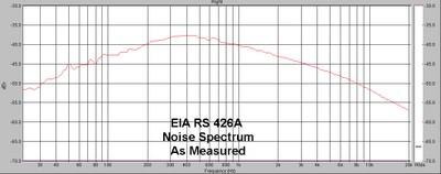

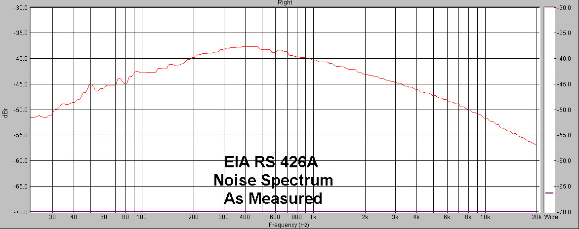

OK, we have proven we can be cruel, now let’s be kind to the speaker and give it a really big number (we want to make the boss and his customers happy). Instead of using a standard such as the EIA RS-426A spectrum, (Circa 1980, and this has been replaced by standard “B” which has more LF energy) let's use simple white noise (that stuff you hear in between FM radio stations or when your TV station goes out.)
RS426A Best
EIA RS426A Measured Noise Spectrum

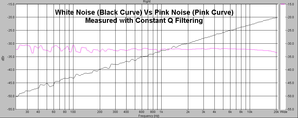

Editorial Note on White & Pink Noise
White noise is so called because it is like white light in that it has equal energy per unit hertz. Pink noise is white noise RED shifted (so now it is pink). When you red shift a spectrum, you bias it toward low frequencies, as in a source (like a train) which is moving away from you so that its motion increases the distance between the sound pressure waves, making the sound lower as the source moves away from you (Doppler shift). Pink noise has equal energy per octave, so the energy from 100 to 200 Hz is equivalent to the energy from 200 to 400 Hz White noise on the other hand, will have twice the energy (+3db) from 200 to 400 Hz, than it contains from 100 to 200 Hz
White vs Pink Best
White Noise vs Pink Noise

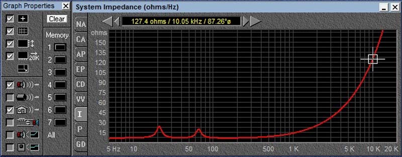

So, if we suddenly use white noise to test a woofer, and we let the frequencies go from 20Hz to 20KHz, half of the energy is contained above 10kHz where the speakers Impedance is VERY high, and therefore the current drawn by the speaker is VERY low. Therefore the actual power dissipated in the speaker (as opposed to apparent power which calculates power into the nominal impedance) is also VERY low. Let's consider the woofer modeled below, with a typical 2 millihenry VC inductance.
Impedance full range
Impedance Full Range
As we can see from the Impedance magnitude graph, by the time we are at 10kHz, this speaker is already at 127 ohms. The current it is drawing is less than 7% of what it would were it actually 8 ohms (8/127 = 0.063). Since 50% of the power of this signal is actually above 10 KHz, the actual power delivered is far far less than what we would calculate into the nominal load impedance. Hence the apparent power handling is far greater than in fact the real power dissipated in the speaker. Using white noise and calculating power handling with the nominal impedance will yield a figure far greater than the 500 watts determined with EIA standard noise.
