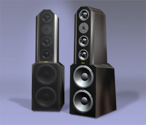

EgglestonesOne time during lunch with a client during a CES show, he asked me if I heard the $100,000 loudspeaker by company “x”.  I told him I had, and he asked me almost shyly: "So, what did you think?"  (This speaker had used compound loading on top of compound loading, so where you saw 1 loudspeaker, there were another 3 behind it).  "I thought the smaller cheaper one sounded a lot better", was my reply.  The client perked up and chimed in with “So did I!”, sounding as if I had just told him the Emperor had no clothes. It was now apparently "safe" for us to talk. People have the expectation that if a speaker is bigger and more expensive, it is also better.  Not so fast... it is not always so.  In the ultra-high-end market, the relationship between cost and performance is not so obvious or linear.  This does not mean you cannot compete with a $100,000 speaker with a $10,000 one.  And it also does not mean a $250 speaker has a chance against the $100,000 or $10,000 speaker unless the engineer who put together the expensive unit really did an incredibly poor job of designing.
Despite the fact that this is common knowledge among engineers who practice their art in this business; and despite the fact it may seem like common sense to most of our readers, there does and will continue to exist in the online audiophile community outrageous claims. Claims that you cannot buy a better speaker at any cost at price points where budget is making decisions on what parts you can afford to put in the box.  Those who have “drunk the Kool-Aid”, especially when their budgets won't allow for champagne, are usually the biggest followers of such false profits.  The only real profits, are the ones the manufacturers deposit from the sale of a high margin product. (The holy grail of retail).
