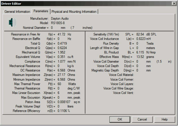

The WT3 allows you to save up to 20 impedance plots in memory, though it provides no direct way to name them. This isn’t an issue if you’re working with only 2 plots. But if you’re working with 20 plots, how long before you forget just exactly what plot # 7 is? (WT3 does allow collections of saved impedance plots to be saved as a Project file). To be fair, it should be mentioned you can save 3 tabbed pages worth of text data per driver measured (the Workbench Measured parameters are filled in automatically as measurements are taken), using the handy Driver Editor utility, shown at right.
