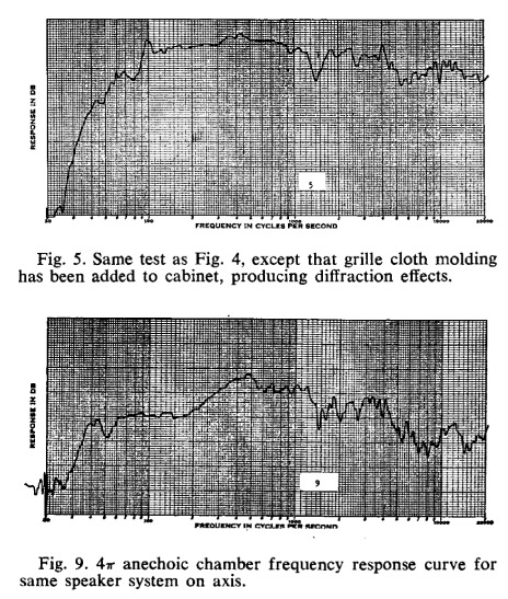

Regarding half-space measurements, they originally were the result of Acoustic Research’s (AR’s) exhaustive measurements back in the 1960’s. AR was one of the first speaker companies to do detailed, repeatable scientific speaker measurements and publish them with accurate explanations that the average consumer could understand. Back then, many speakers were in fact mounted on “bookshelves,” with books all around the speaker, constituting a measurement environment that did, indeed, approximate a true 2 Pi (half-space) environment.
When that same speaker was mounted on a stand somewhat away from the major room surfaces (the side wall, the wall behind it, and up from the floor below it), the speaker would exhibit what today we call the “baffle step” phenomenon.
AR Baffle Step
The above curves of the famous AR-3a from 1968 clearly show that. In the top figure, the 3a is in a pure 2 Pi environment (“bookshelf,” surrounded by books), and its LF-to-midrange response is smooth and predictable.
In the lower curve, the 3a is stand-mounted away from the walls. You can clearly see the lowering of the woofer’s response level as the frequency transitions from a 2 Pi environment (in the midrange, where the speaker’s baffle is large enough to provide that environment) to a 4 Pi environment in the lower bass. Interesting that AR recognized this and identified it in 1968. They were ahead of their time. But not until Roy Allison’s Allison speakers of 1974 were there speakers that took this into specific account. Allison’s 1973 AES article The Effect of Room Boundaries on Low Frequency Power Radiation is particularly illuminating.
