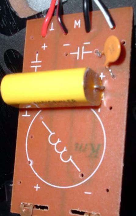

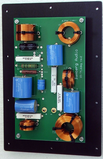

The most obvious visual cue is simply size.  A small cheap crossover is just that.  Small and cheap.
basic xover2    Quality Crossover
Poorly designed crossover (left pic);    a high quality crossover (right pic)
The crossover (above left pic) is from a two-way bookshelf speaker system we have previously reviewed.  The speaker system employs a stiff cone driver which has no crossover circuit (namely a LPF) to limit its bandwidth to reduce its audible break up modes at higher frequencies.  The manufacturer did use a poly cap in series with the tweeter instead of an electrolytic capacitor which is good news.  But, we've seen examples of crossovers worse off than this that instead employed electrolytic capacitors which was done solely for cost savings as these parts have higher resistance and performance variances than quality and more costly poly designs.  This is bottom of the barrel crossover design unbecoming of any serious loudspeaker design, despite the claims of “science and research” behind its products.  At low power levels these speakers don't sound bad but once the volume is cranked up, audible driver break up was identified by our panel of listeners in blind comparisons.
The crossover image (right above pic) is of a much higher caliber design by an engineer making no outrageous claims.  Instead, the engineer understands the importance of proper crossover design and execution to get the most out of the drivers.  The designer invested an appropriate portion of the budget of his product to arguably one of the most important aspects of the speaker design – the crossover.  Notice how air core inductors are used in critical circuit paths and they are properly oriented and spaced from adjacent magnetic inductors to avoid unwanted cross coupling.
The tweeter circuit runs vertically up the left side of the photo. The woofer circuit is on the right.  You can see how the inductors are located in the corners, while the smallest inductor is in the middle of the board.  Tweeter/woofer nearby inductors are oriented at dual-right-angles with each other.  There literally is more woofer/tweeter crosstalk from single-wiring than there is through the inductor mutual coupling.

Bottom Line:  The KISS principle doesn't always work when it comes to building a crossover network for a loudspeaker.  Take pause if you open the speaker box and see a 2 or 3 element crossover like the above left picture above, recognizing this was, in our opinion, done for cost reducing purposes and or design incompetence.  While the speaker can still offer respectable performance nonetheless, it's likely not "state of the art" in performance like you would find in more robust and often more expensive alternatives.

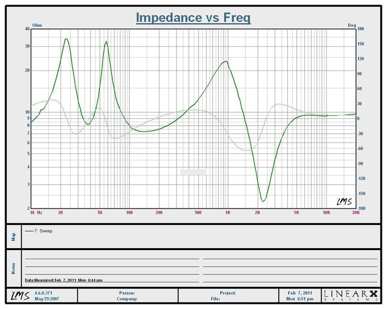

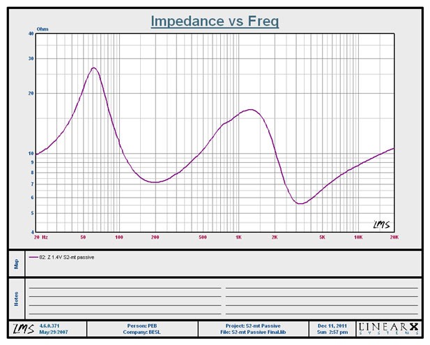

GranteedEV;853899
It has to be something along those lines because the graphs don't seem to match up above 1khz. The impedance peak on Dennis' graph is half an octave higher with higher magnitude, and there's no impedance dip. The behavior near tuning is different too, but I think the boxes used are not the same (one being a bookshelf (?) fand the other being a more damped tower (?))
It sounds like someone misread the schematic.
Jim told me the crossover design was not his own and after I found this issue he said he was discontinuing the product. Perhaps he has a redesign now. I have no way of knowing. I tried to review 2 pairs of speakers from Salk and both pairs had issues and there is no room in my schedule at this time for a 3rd try. Perhaps later in the year we can try again as I still have high hopes for his products.
GranteedEV posts on January 03, 2012 11:19
It's all good, Gene. I spoke to Dennis and he said he's pretty sure the crossover guy in the Salk facility wired these speakers incorrectly. Fortunately you found the issue through testing, though. I don't know if any production models were accidentally wired backwards as well or if it was just this pair, but the problem has been resolved.

It's all good, Gene. I spoke to Dennis and he said he's pretty sure the crossover guy in the Salk facility wired these speakers incorrectly. Fortunately you found the issue through testing, though. I don't know if any production models were accidentally wired backwards as well or if it was just this pair, but the problem has been resolved. And I do believe Salk still offers the Ellis 1801 as a current model (it is still on their website). Of course, I am sure it's a properly wired version.
gene posts on January 02, 2012 22:30
Ah, the name is on the graph, Gene... It's a little late for that.
Crap I replaced the trace with "Sweep" but didn't see it where the filename called it out. I will change out the image. It wasn't my intent to give Salk a black eye, especially since they no longer make that speaker.
I fixed the image and my apologies to Salk.
