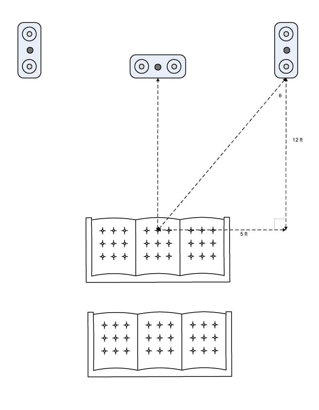

Right Speaker DiagramWhen choosing a center channel for your home theater, it’s important not to apply absolutes as they will only reduce your viable options.  Most people not using front projection systems or utilizing transparent screens deal with height restrictions and thus require a speaker that has a narrow vertical height.  In this case an MTM is the obvious choice. Ideally one would be advised to use identical vertically mounted speakers for the front three channels. But, even in this “ideal” setup, you still will NOT get a perfectly timber-matched blend of the front three speakers at the sweet spot (see Figure 2), much less any other listening position. The reason is you will be directly on-axis to the center channel but not the front main speakers. Take our first example where we are sitting on-axis with our center channel 12 feet away.  This puts either front left and right speaker about 23 degrees off-axis to us assuming they are 10 feet apart and equidistant from the center channel.  Using a liberal amount of toe-in on the front channels can help this.  Using excessive toe-in may adversely affect the other seats while also limiting the width of the sweet spot.  This doesn’t preclude the fact that it’s generally sound advice to match the front three speakers, but even so understand that perfect blending is basically impossible to achieve in a real world environment.

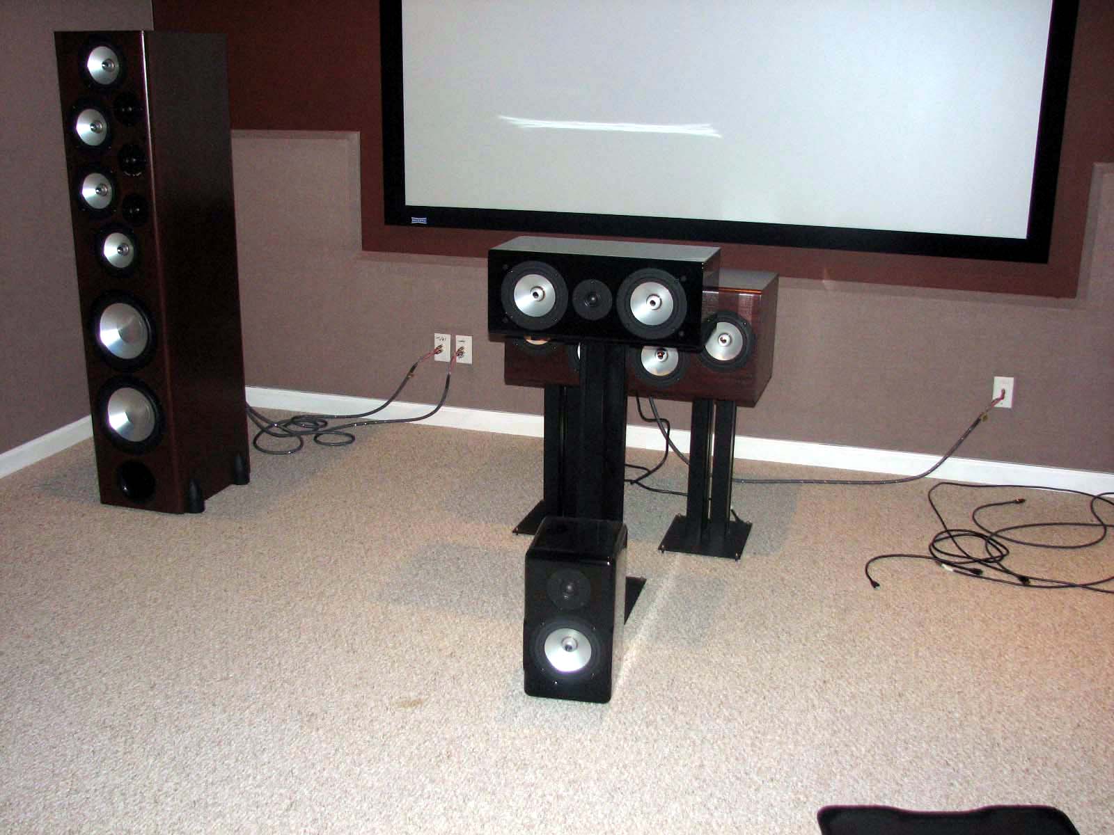

As an electrical engineer, I’ve been trained with the mantra that the best way to illustrate a point is through proof and measurements.   As such I grabbed an RBH Sound 661-SE/R MTM speaker and my beloved Status Acoustics Decimo two-way bookshelf speakers to pull some measurements.  The Decimo is not only the best sounding bookshelf speaker I have heard to date, but it also measures phenomenally well on and off axis.  Both speakers utilize the identical Scan Speak 9500 tweeter, and the same 6 ½” aluminum phase plug driver.  The 661-SE/R however utilizes two mid bass drivers, in an MTM orientation.
Center Speakers  Theater Chairs

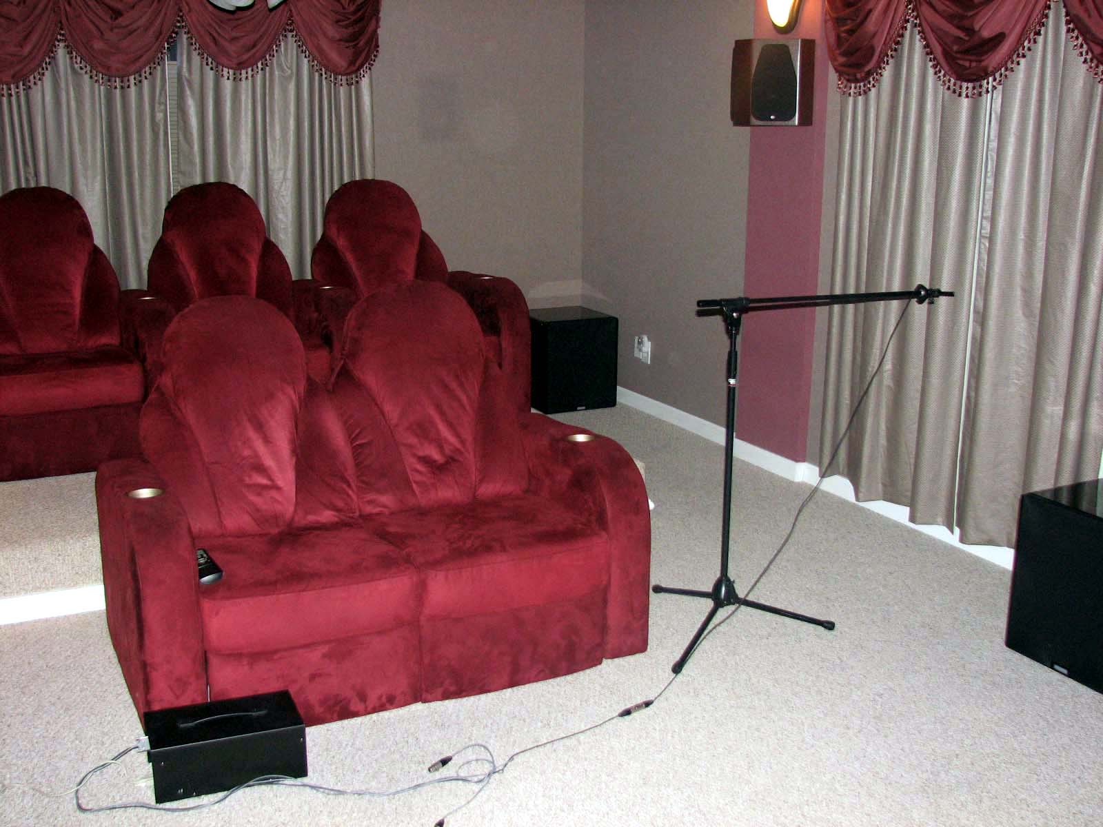

Left Pic RBH 661-SE/R & Decimo; Right Pic Mic in seated area
I positioned each speaker on a 30” stand and pulled measurements at the listening position of my front row 12 feet away which represents 0 degrees or on-axis, 3 feet shifted to the left or 14 degrees off-axis and 6 feet shifted to the left or 27 degrees off-axis.  Note the 6 foot measurement placed the microphone only 20 inches from my left sidewall.  I never position a seat this close to a sidewall, nor do I recommend it for anyone, not even the mother in-law. The microphone was placed at ear height for all of these measurements.  I pulled these 3 measurements for the MTM vertically and horizontally mounted and the two-way bookshelf vertically mounted.  I didn’t have a W(T/M)W on hand so the two-way was the closest I could come and in fact could arguably produce more ideal off-axis measurements.

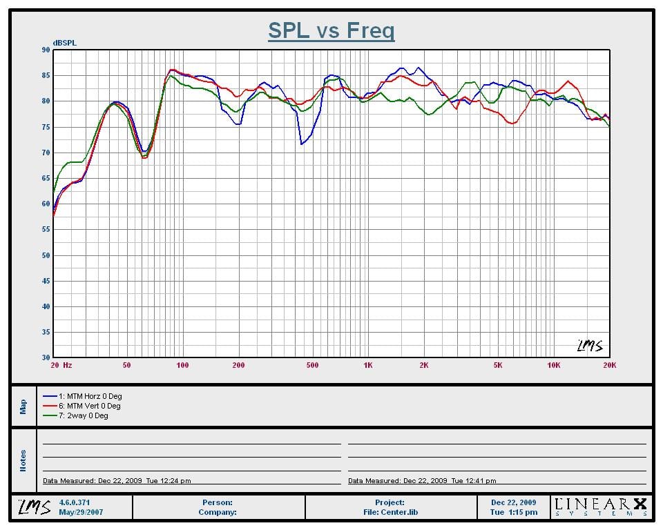

Measurements 0 Degrees
1/4th Octave Frequency Response 0 Degrees Off-Axis
Blue: MTM Horizontal; Red: MTM Vertical; Green: two-way bookshelf
I had to boost the two-way speaker 5 dB to match the output of the MTM; 3 dB related to sensitivity, and another 2 dB resulting from the MTM being a lower impedance speaker (6 ohms vs the 8 ohm MTM).  This is a significant power boost required and something to consider for those wanting to use a two-way speaker as a center channel when they are already using more efficient MTM designs for their main channels. The vertically mounted MTM measured almost ruler flat from 200 Hz to 2 kHz while showing a slightly tapered response in the 3-7 kHz region.  The MTM actually measured better in the 3-7 kHz region when horizontally mounted though it did exhibit 10 dB dip centered at 450 Hz but considering it was very narrow in bandwidth, its audibility is questionable playing real program material.  The 200 Hz dip exhibited by the horizontally mounted MTM and the two-way bookshelf is likely a measurement anomaly related to the microphone position relative to the floor.  The two-way measured similarly good to the MTM vertically mounted.  So far all these speaker orientations seem to indicate measurably good results.

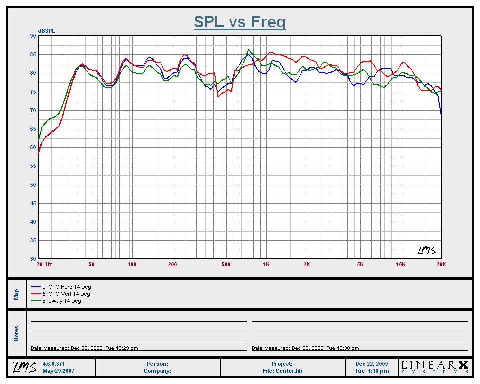

 Measurements 14 Degrees
1/4th Octave Frequency Response 14 Degrees Off-Axis

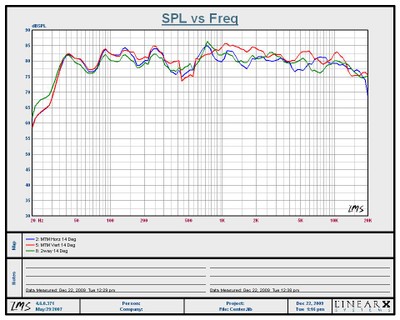

At 14 degrees off axis, this represents the left seat in my front row of my theater.  The MTM vertically and horizontally mounted measured similarly good.  The horizontal orientation produced a slightly reduced output in the 1kHz to 2.5kHz range which again arguably looked more linear when compared to the entire frequency spectrum.  If you compare the measurement of the horizontal MTM to the two-way, they look almost identical.  So let me get this straight, a horizontally mounted MTM in a real theater room measured this well at a real world listening position that was off axis from center?  Yes it did!

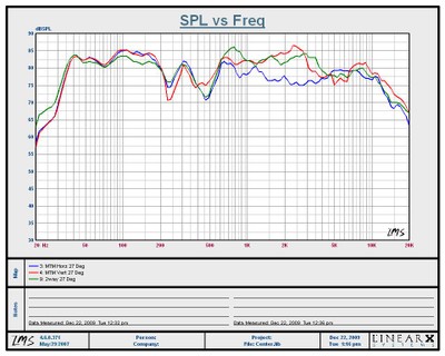

At this measurement position the MTM measures very similarly whether oriented horizontally or vertically with the exception of a 5 dB boost centered around 2 kHz in vertical orientation. Arguably the MTM measured more linearly at the primary listening position when horizontally placed.  As we indicated earlier, the reduced output of the off-axis MTM is actually beneficial when the listener is placed near a sidewall.  The two-way again measured nearly identical to the vertically mounted MTM.  Hence even sitting near a sidewall we see the MTM does a good job whether placed horizontally or vertically.   It’s important to note that this is a very well executed MTM design and your mileage may vary depending on how well the manufacturer executed the crossover and chose the correct drivers to match the system.

Gene - Thanks for doing all that. It puts things into proper perspective. Like so many things where people don't fully understand the details, they interpret advice in a black or white fashion. Yes, it would be somewhat better if an MTM speaker stood vertically. But a horizontal MTM is much better than no center channel speaker, and as you showed, better (for different reasons) than a vertical MT speaker.
The best part was where you showed just how far off-axis you would be while sitting in a typical 3 cushion-wide sofa 12 feet away from the speakers. It isn't far enough off-axis to be real trouble.
Again, reality trumps conventional wisdom.
