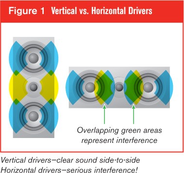

A few other things to mention and ponder: While it’s true that dual horizontal midrange drivers covering the same frequency range will overlap and “picket-fence” with each other at some angle off-axis, what is also true is that in the crossover region, where the midrange driver is crossing over to the tweeter, their output also overlaps and causes interference in the horizontal plane. So it’s not just the dual 5-inchers, it’s also where the 5” crosses over and overlaps with the tweeter. Even if it were a single 5” mid crossing over to a 1” tweeter, if they were mounted side-by-side, there would be a lot of crossover-region interference in the horizontal plane.
So the interference between dual midrange drivers of an M-T-M center is only half of the reason that horizontal centers have problems. The side-by-side positioning of the tweeter and midrange is the other half—and maybe even worse.

All serious bookshelf and floorstanding audiophile music speakers have one thing in common, regardless of what kind of bass loading they use, or their cone materials, or their crossover types, or cabinet bracing, or anything else: All of them have vertically-oriented midranges and tweeters. Nice and straight, in a line, up and down.
The reason? All of those companies’ engineers are good and they all know the same basic laws of acoustics. One of which is that side-by-side drivers that overlap in the crossover region will interfere with each other in the horizontal plane….so it’s much, much better to throw that unavoidable, inevitable interference into the vertical plane, where it’s far less critical and detrimental. (Remember, it’s only about a 10-inch window, vertically, that the speaker has to deal with, not 4 or 6 or 10 feet, like it is horizontally.)

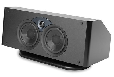

An interesting compromise is the approach that some companies take with their center channel box speakers. (See figure 4, an Atlantic Technology center channel speaker.) They use an “optimized” M-T-M-type of design, whereby the tweeter is raised well above the horizontal centerline of the two midranges. We’ll call this the “raised-tweeter” approach.
Atlantic 4400 C
Figure 4.  Atlantic Technology 4400 C Center Channel
The raised-tweeter approach to center-channel design preserves the few advantages that a horizontal MTM has (higher sensitivity, increased power handling, etc), but significantly improves on a horizontal MTM center's greatest shortcoming—its very restricted horizontal dispersion. Raised tweeter centers are much better than a conventional MTM center in that regard, both because the tweeter is not in the same horizontal plane as the woofers and because elevating the tweeter allows the woofers to be brought in significantly closer together. (Remember, two identical drivers covering the same frequency range behave as if they were an oval driver of their combined outer distances apart. Driver directionality is primarily a function of the relationship of the radiated wavelength to the effective piston diameter of the driver. Other factors can also affect directionality, such as cone shape, cone stiffness, breakup modes, among others, but the first determinant of directionality is driver size.) Bringing the dual midranges in much closer to each other minimizes the distance between their acoustic centers, for an effectively smaller radiating dimension, which maximizes their horizontal dispersion.

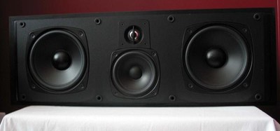

Center 3 wayA true 3-way center [W(T/M)W] with a vertical midrange and tweeter can undeniably be superior (assuming the same quality components as a good 2-way, as stated above), but it costs a lot more to manufacture than a 2-way MTM.   So, if the manufacturer is trying to hit a price point, a raised-tweeter center clearly outperforms a conventional MTM center, but for the same cost.
A well-designed 3-way crossover typically has at least double the number of elements of a 2-way crossover, and those elements (especially the woofer chokes) are a much larger value and hence more costly. That means that a 3-way crossover is usually more than double the cost of a 2-way crossover. Then you have the extra driver (a separate midrange), and you have a much more complicated cabinet to assemble (the routing, the internal midrange sub-enclosure, more bracing to reinforce the routing, etc). That's why a good 3-way center is always at the higher end of the price spectrum.  The picture at the beginning of this article (courtesy of Snell Acoustics) combines the best of both worlds yielding a true 3-way design while also implementing a vertical MTM for better horizontal dispersion and higher output capability than a typical 3-way single midrange alternative.  This is typically not a very popular option because it also requires the cabinet height to increase which is often a deal breaker for those attempting to squeeze in a center channel below a display or screen without obstructing the view.
If, as a manufacturer, you're trying to hit a low-to-mid price point and you're limited by your budget to a 2-way design, then you're best off doing an elevated tweeter design and it'll be better for the same cost than a conventional 2-way horizontal MTM.
