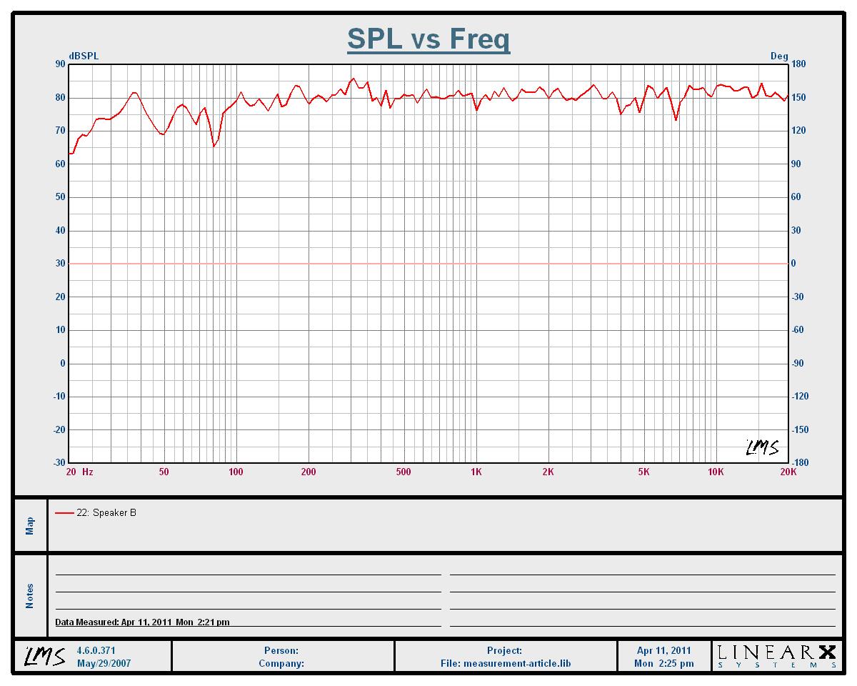

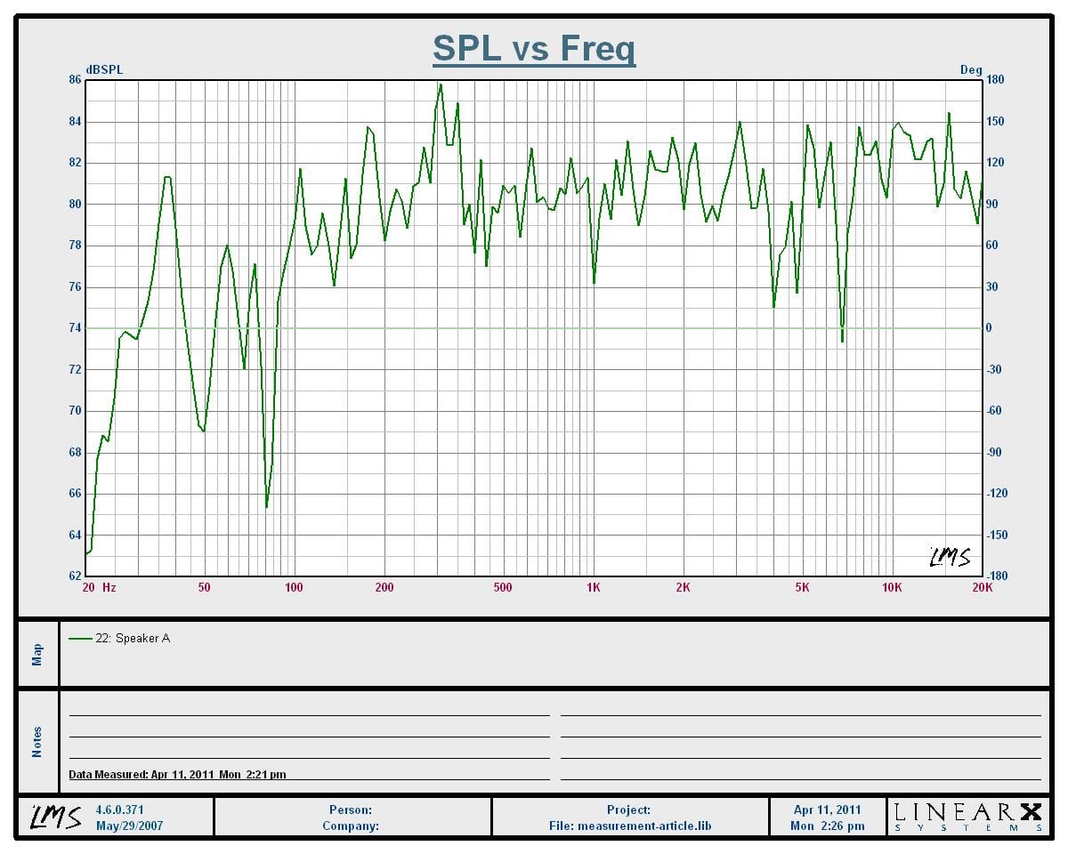

Below are measurements of two loudspeakers.  Take a look at the graphs and ask yourself which speaker you would prefer assuming the goal is the most accurate and "linear" frequency response from 20Hz to 20kHz.
Scaling
Speaker A2  SPKB2
SPL vs Frequency Response of SPKA (left pic); SPKB (right pic)
After looking at the graphs, surely most consumers would prefer SPKB because the measurement is much flatter and smoother .  Truth be told you are looking at the exact same speaker and the exact same graph.  The difference is actually in how I chose to display the data collected, but be assured, the data is exactly the same in both curves.  The measurement was taken in-room 8 feet away from my right front reference speaker (RBH Sound T-30LSE).  The measurement was not time gated and thus taken steady state so the room influenced the measurement. The only difference between these two above graphs is the dB scaling, which is the vertical axis.  The SPK A graph has a 24dB scale in the vertical axis while SPK B has a 120dB scale (known to engineers in the business as the marketing curve). The larger the scale (dynamic range) in the vertical axis, the less detail you see about the measurement.  I can't tell you how many so called "professional" reviews I see on other A/V websites and print publications that use 120dB or greater scales to give the illusion of a smooth linear response for the speaker they are reviewing.  We personally like to use 60dB scales for all of our loudspeaker measurements and often use smaller vertical scales if we want to zoom in on a problem area.  (Most engineers use either a 40 or 50dB log scale for displaying data.  This goes back to (possibly precedes) the available parts used in the old analog style graphic level recorders made by the sound measurement company, Bruel & Kjaer).The two most popular potentiometers they sold for audio measurements were 40 and 50 dB. You could even slow the measurement speed down on the old B&K plotters, effectively smoothing  the printed plot to yield a nicer looking graph.

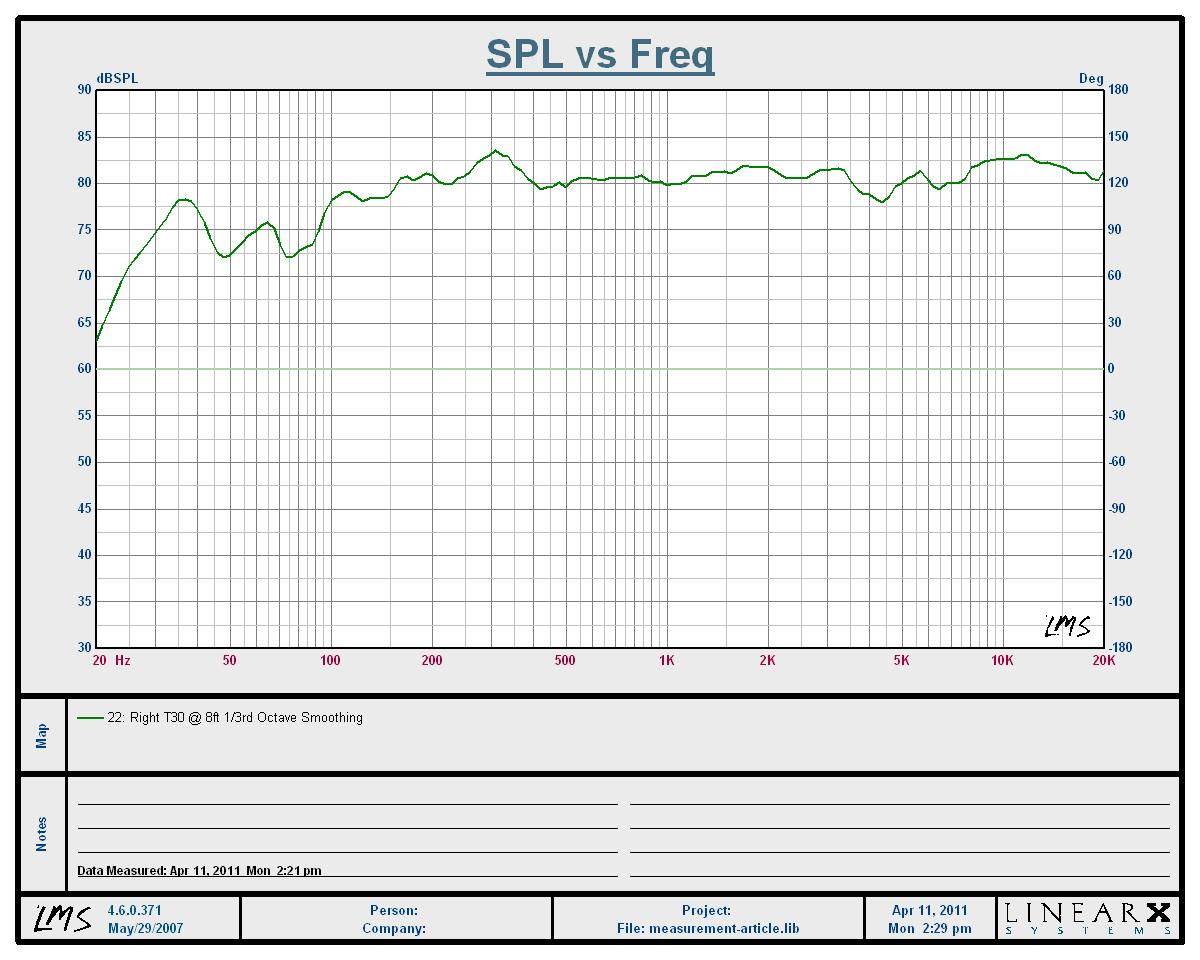

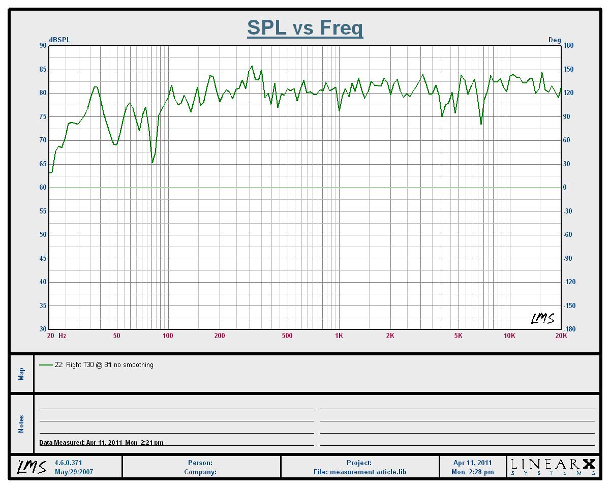

   SpkA-60dB  SpkA smoothed
SPL vs Frequency Response of No Smoothing (left pic); 1/3 Octave Smoothing (right pic)
Here we have the same speaker, same measurement again with the scale set to 60dB.  The left pic is  not smoothed while the right picture uses 1/3 octave smoothing.  In order to get an accurate measurement, it's important to have a large enough collection of data points in the measurement, else the finer details will be missed and the overall measurement may not reveal the problem areas of the speaker under test.
Why not use 1/3rd Octave Resolution?
3rd OctaveIt’s a common misconception that 1/3rd octave spectral analysis is a good enough approximation of the perceptual critical bands over the mid and high frequency range.  Some have argued that our hearing discernability is limited to this resolution.  In reality, these bands define the bandwidth over which spectral information is summed for estimates of loudness and in the simultaneous masking of tonal signals by broadband noise (see: Toole, CH19, pg450).  Within these bands the beats from multiple tones influence the perceptual quality of "roughness".  Differences in roughness contribute to the distinctiveness of sounds and timber.  1/3rd octave smoothed measurements mask associated performance issues in speakers which is why according to Dr. Toole higher resolution is needed (1/20th octave in the frequency domain) to really get a better picture of the loudspeakers true response.  Since the majority of our loudspeaker measurements are done in-room, we typically use 1/12th octave smoothing which isn't perfect but does give you a much better idea of speaker performance than the typical 1/3rd octave resolution graphs found in most print and online A/V magazines. Loudspeaker designers typically use higher resolution measurements in their design process for troubleshooting purposes.
Smoothing is typically not needed for nearfield measurements, or those done in anechoic chambers since the room is taken out of the picture and  loudspeaker performance can be assessed without the normally significant influence the room plays on the sound which reaches the listener.  Smoothing is a useful technique  for in-room measurements which if not abused can still produce a relatively accurate performance graph of the speaker while removing many of the room reflections and their substantial influence on what we hear in the real world. This is known as smoothing by spectral averaging, which can be interpreted as we know exactly where we measured it but we are not sure what we measured.  The alternative technique is to use spatial averaging which is very useful when measuring in the near field (1-2 meters typical) of a complex source, aka a loudspeaker system, where we know that there will be acoustical interference errors. So, what we do is make a few high resolution measurements at slightly different angles and average them. This can be interpreted as we have a very good idea of what we measured, but we are uncertain as to exactly where in space it applies. In loudspeaker measurements the latter is actually more useful and something we plan on doing more of for our in-room loudspeaker measurements.  We (reviewers/manufacturers)  have long relied more on the “listening window” data for direct sound estimates than on the solitary “on axis” response.

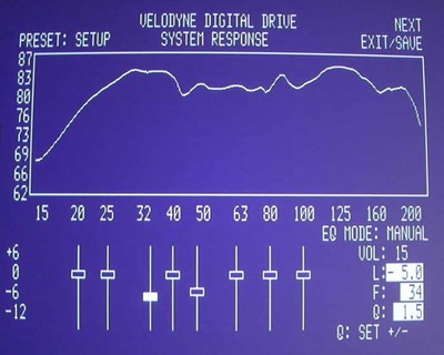

SMS-1
Velodyne SMS-1 Frequency Response Graph
Be careful with measurement devices such as the Velodyne SMS-1 whose output is limited to 1/3 octave resolution.  This resolution is too crude for performing any type of high Q room correction as the measurement system will likely miss those room modes (in-room peak) and nodes (in-room dip) in the frequency response sweeps.  Such low resolution measurement systems do a poor job of seeing the higher Q problems which typically plague rooms, and need to be removed with a scalpel, not a saw.  It's important to have enough resolution to accurately dial in the response.  It is recommended to instead use an external measurement device with at least 1/12th octave resolution for fine tuning of bass response or limit your corrections to very low Q adjustments. The frequency response scale of your RTA should be set to plot between 10Hz to 200Hz with a maximum of 60dB vertical dynamic range to get a clear picture of what is going on with your systems bass response.
