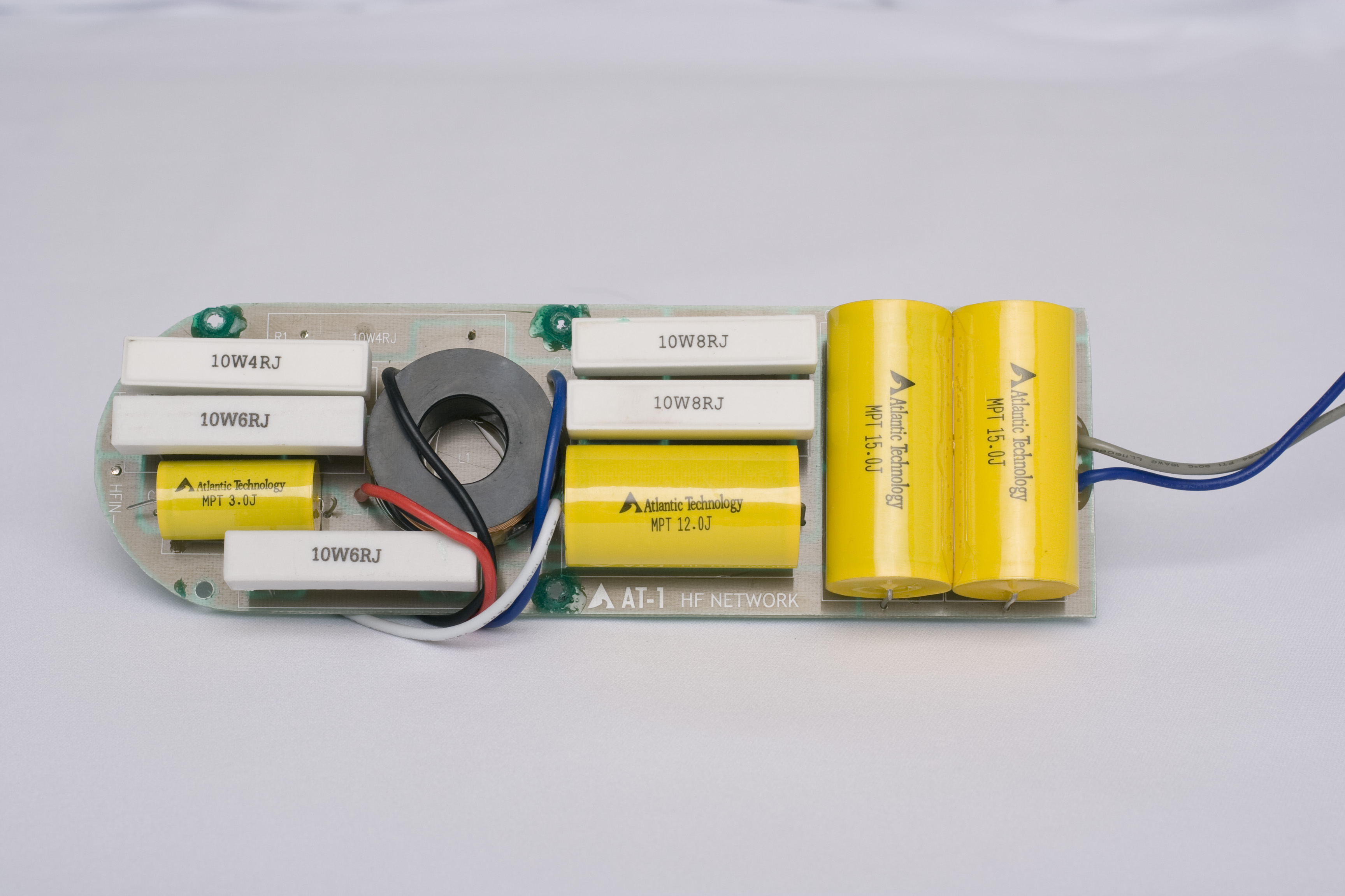

Crossover with Air Cores & Poly CapsWe feel that one of the most important design aspects for a “high-end” speaker is component tolerance. (I’d opine that Atlantic’s definition of what price constitutes high end is likely a lot lower than some other companies’.) Drivers need to have very, very close frequency response consistency from unit to unit. Crossover components have to have similarly close tolerances. Typical drivers can vary +/- 2 or 3 dB from unit to unit and average crossover components are toleranced to within 10% of nominal values. If these tolerances stack up in the wrong direction, your oh-so-carefully designed speaker can easily drift several dB off its performance target. Crossover frequencies can shift from 500Hz to 450 or 550Hz—that is obviously audible, regardless of the so-called ‘type’ of component being used.
So, clearly-defined goals, a solid, verifiable engineering approach to attain those goals, and components (drivers and crossover elements) that adhere to tight tolerances. That’s for starters, and that’s 99.99% of what’s required for a truly excellent speaker, high-end or otherwise. Call it what you like. If it doesn’t pass this test, nothing else matters.
All the items you bring up can be discussed in terms of one thing: Is it audible or not? I recall an incident at another speaker company I was at before Atlantic Technology. It was a very well-known company whose products were highly-respected and prized for their performance-to-price ratio. We were doing a new family of clearly higher-end speakers, and we employed poly by-pass caps on a later prototype. The President—well-known for his solid engineering approach but famously skeptical of ethereal high-end features— came in to listen to this newest version and immediately proclaimed that it was superior in an A-B comparison to the version he’d heard earlier that only had electrolytic caps.
“What’s different? Let me see the curves.”
“The curves are identical. The difference is by-pass caps.”
“D*mn!! I hate when those high-end things make a difference!”

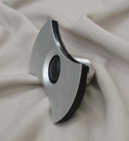

IWCB TweeterMost of the individual items you’ve listed probably relate more to their suitability for a specific design goal than being generically high-end per se. Rear chambers on tweeters to lower their Fs is important if it’s a 2-way design and your goal is a lower woofer-midrange crossover point to achieve wider midrange dispersion. Don’t want an 1800 Hz crossover because you’re not looking for the widest-possible midrange dispersion? Then you don’t need a low-Fs rear-chambered tweeter. It is design goals, not arbitrary components, that matter.

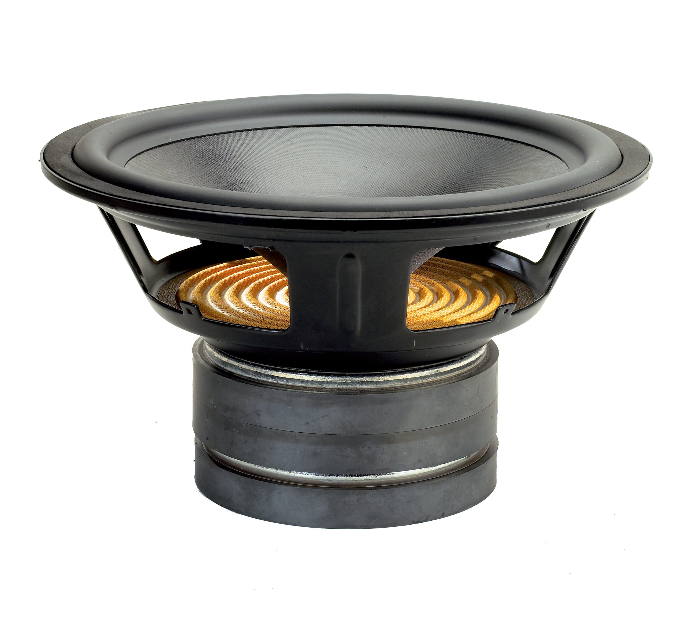

Vented woofer pole pieces are fairly standard on good designs, to give woofers higher power-handling and greater reliability. All Atlantic Technology woofers use vented pole pieces, even though not all of our speakers would be considered “high end.”
Air core coils can get pretty large, physically, and they introduce more resistance in the circuit than iron-core coils. Of course, conventional iron-core coils are prone to saturation and subsequent audible distortion at high drive levels. Laminated-core can work very nicely, can be physically-smaller than air-cores of the same value and usually have lower resistance. A good designer will choose what’s appropriate to achieve the performance target, rather than what looks more impressive on the marketing spec sheet.

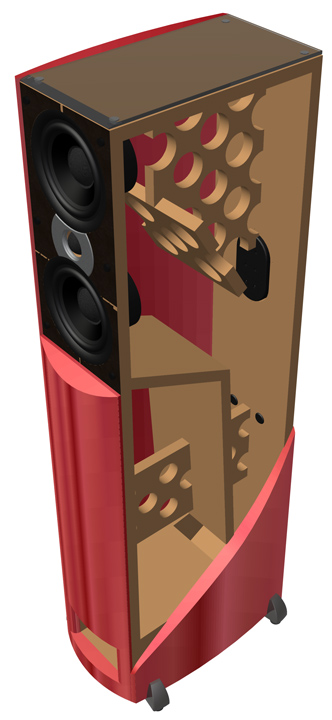

AT-1 CabinetThere is probably no disagreement about reducing cabinet resonance/vibration. This is one aspect of higher-end speakers that they all share in common. Bracing, constrained-layer damping, sound-deadening lining on the interior of the cabinet, solidly-mounted drivers by way of thick baffles or interior support, these are all important features. Lower-cost speakers just don’t have the room in the budget for this, and therefore many budget speakers have enclosures akin to empty milk cartons.
Our cabinet designs have been more intended to redirect and reduce resonances, instead of the usual brute force method of more bracing is better. MDF panels have a tendency to resonate in the frequency band of dialogue if braced improperly. We use asymmetrical bracing to help reduce the resonance. Asymmetry is very important in all aspects of audio, from bracing placement in a cabinet to sub placement in a room. Whenever you can avoid stacking up multiples of resonant frequencies on each other, you’re going in the right direction. Mathematically-unrelated (and therefore frequency-unrelated) distances/dimensions are always a good thing.
The “Swiss Cheese” aspect of the CDFF brace in the AT-1 helps to dampen the brace itself. We use a rubbery paint to coat the inside of a heavily-ribbed plastic midrange enclosure on one of our in-wall speakers that does the same thing. The enclosure is really ‘dead.’ Common-sense stuff that has real acoustic payoffs.

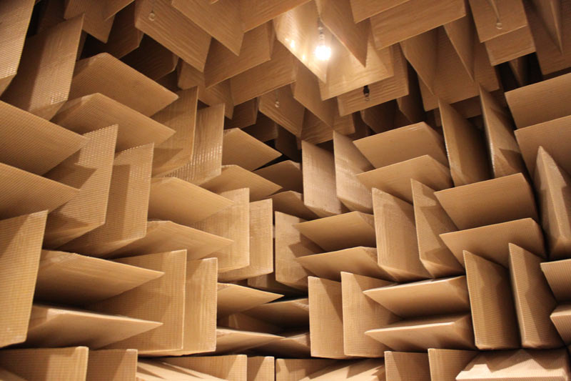

Are Anechoic Chambers really necessary?
Microsoft Anechoic ChamberThere are those that argue an anechoic chamber is an absolute necessity for designing and measuring loudspeakers.  The reality is gating measurements have really rendered the anechoic chamber far less necessary than before. For bass frequencies, no reasonably-sized anechoic chamber is valid much below the upper bass/lower mid region. If you’re measuring a sealed system, then you can bury the speaker in the ground outside, with its front baffle flush with the ground, for a perfect 2-pi measurement environment. Edgar Villchur of AR used to call this “God’s anechoic chamber.”
For ported/vented systems, the situation is a bit trickier, and anyone who claims that it’s not is either not being totally honest or they just ‘don’t know everything they don’t know,’ as the saying goes. There is the vent contribution and the contribution from direct driver radiation. But….there’s a rather complex formula for determining exactly how those two contributions should be weighted, based on the area of the vent and the area of the driver, the distance of the vent from the driver, their phase relationship, all kinds if things. D.B. Keele had a great article in Audio magazine about this about 20 years ago, and it illustrates very clearly the somewhat ambiguous nature of getting ironclad, dead-accurate LF measurements from vented systems.
