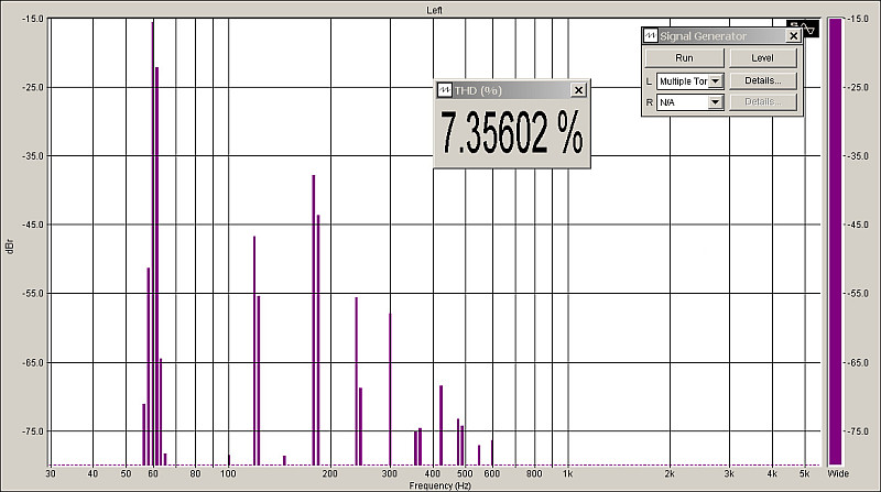

The purpose of this subwoofer shootout is simple: compare products for performance using measures and techniques as defined by the CEA 2010 standard.   The CEA 2010 standard is a means for measuring the maximum output of subwoofers at the two lowest audible octaves, 16-32 & 32-63 Hz.   Unlike a traditional harmonic distortion number, the CEA number attempts to weight different harmonic distortion components based not only on their amplitude relative to the fundamental, but on their separation in frequency as well.
Example of Product with Excessive 3rd Harmonic Distortion
Fundamental Frequency =60 HZ, 2ND = 120 HZ, 3RD = 180 HZ, 4TH = 240 HZ, 5TH = 300 HZ, ETC.
Above is a spectral plot of the output of a 12” subwoofer in a box tuned to 40 Hz.  While this author found this level of third harmonic distortion easily perceptible, I must note that this output would be considered well within the CEA third harmonic distortion limits imposed by the CEA standard.  One of those individuals who had taken part in the creation of the standard has personally voiced opinions to me that perhaps the CEA standard is too lenient.   I have also heard this comment from some of the vendors who submitted product for our own testing.  Those vendors, such as SVSound, who held themselves to a higher standard than the CEA published “acceptable” distortion limits, actually placed themselves at a disadvantage because they had the system “draw the maximum line” at a location lower in distortion than CEA allowed for what it considers to be acceptable at maximum usable output. One must bear in mind, that both an amplifier with a built in compressor, as well as a loudspeaker, do not have a brick wall limitation in performance.  (While technically possible to build an amplifier this way, the resultant distortion it would produce when it hit the threshold would be egregious.  Some of you already know it, and refer to this as “Hard Clipping”.)  When an amplifier is rated on power, the number is meaningless if not accompanied by a distortion figure, and whether or not the output is peak or RMS (which most of us think of as continuous instead of transient or short term.)  The same is true when testing subwoofers for maximum output.  You might be able to drive them past their intended maximum limit, but at what price in distortion?  The CEA standard not only attempts to define that limit, but does so in a completely quantifiable way.  Note the graphic below titled Signal Spectrum.

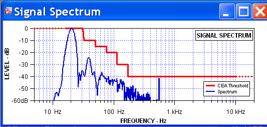

20 Hz Fundamental output within CEA allowable distortion limits
Please note the stepped red boundary which looks a bit like the side-view of a staircase.  That red line represents the CEA 2010 Sub-Woofer standard limit on distortion.  It does not represent a certain amount of distortion in absolute terms.  It does shows the acceptable upper limits of distortion as a percentage of the fundamental output. (The test frequency).  Note the center of the large “finger” shape in blue.  It is centered at 20 Hz, in this case the test frequency.  Notice a second finger centered at exactly twice the frequency, 40 Hz.  That is second harmonic distortion.  For this product, that is the dominant distortion when driven at 20 Hz to this output level.  (It may well change if driven harder towards its physical limitations).  Note also, the level of 0dB at the peak output centered at 20 Hz.  This is NOT a measurement of the output in dB relative to any particular sound pressure.  The program captures the signal output, and transforms the signal into a spectrum.  Whatever the sound pressure is at the driving frequency (in this case 20 Hz), this peak value will be considered the reference, or “0 dB” value.  It means that the other frequencies present are measured RELATIVE to the fundamental, which is why distortion can be expressed as a percentage.  Notice that as the harmonic frequency is farther and farther away from the driving frequency, the CEA limitation, (like your ear) is more and more intolerant.  The red stepped line means that the second harmonic distortion can be up to 10 dB less than the fundamental, the third an be up to 15 dB less, the fourth and fifth 20 dB less, and so on. This is weighting the distortion spectrum in a way that corresponds to how the human ear-brain mechanism responds.   Since the distortion components are all below the threshold of the stepped red line, (CEA standard limits) this speaker at this test volume passed.

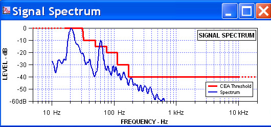

During my testing, I was sitting about 40 feet away (to the side) of the units under test.  While I cannot determine how different the spectrum of sound was at the microphone relative to my position, on a relatively small number of occasions when the software recorded the output as a "FAIL", or "PASS", I might have decided from listening alone, that should not be the case.  Despite that, I would argue that the CEA 2010 standard is as good or better than any other metric I can name for relating subwoofer distortion to usable output.  The vast majority of the time, my ears would draw the line at the same levels the software would report a "FAIL".  Let's take a look at the graphics shown to the test operator in the image below which shows a failure due to an excess of third harmonic distortion (60 Hz resulting from a 20 Hz input).
Excess Third Harmonic Distortion as per CEA 2010 Standard
As we can see from this example, the distortion of this speaker under test is predominated by third harmonic distortion (60Hz), and it rises in excess of what the Red stepped curve would allow as a maximum limit.  At this point, we have crossed the line (literally) and are “in the red”, so the SPL produced by this speaker was not considered “usable”.  That is, in a nutshell, how this program works.  It produces ratings of Pass or Fail only.  The only two discernible frequency components in this upper graphic are the fundamental driving frequency (test pulse centered at 20 Hz) and the 3rd harmonic distortion, centered at 60 Hz.  During testing, the frequency center is changed from 20 to 63 Hz in 1/3rd octave steps (20, 25, 32, 40, 50 & 63 Hz).  Unlike a traditional tone burst, which consists of a single frequency, this stimulus has a 1/3rd octave width.  Traditionally 1/3rd octave is considered to be “critical bandwidth” of the human ear, meaning we lack the ability to distinguish tones that are within this close to one another in frequency.  What does that mean?  Well, take a look at the first graphic (#1).  You can take note of the single vertical blue line which looks like it is centered at or about  550Hz.  This is a very narrow-band noise, which likely has less to do with the speaker under test than it does to noise being emitted by a nearby factory.  This line is how a traditional tone burst might appear, very narrow in comparison to the 1/3rd octave pulses used in testing.   The advantage of 1/3rd octave signal pulse for testing, is that it will tend to average a speakers strengths and weaknesses over that 1/3rd octave.  It is ENTIRELY possible for a speaker to have a big HUMP centered at EXACTLY 40 Hz, while at 35 Hz, it might have a huge and narrow notch.  A traditional 40 Hz tone burst would show a huge output yet would be blind to the notch.  Since 35 Hz is not a standard frequency center, this defect might go unnoticed by tone burst testing stepped in a similar way, 1/3rd octave at a time.  With the 6.5 cycle burst from Don Keele's CEA test software, running on the graphics program Igor Pro, the nature of the signal is to be DOWN -3dB at a 1/6th octave increment on either side of the center frequency.  (Meaning these pulses are 1/3rd octave wide). This is in fact quite similar (though not identical) to the kind of signal proposed by Siegfried Linkwitz to be used for testing on his site.
