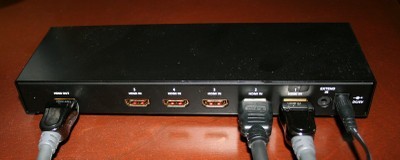

Now, for those wanting to spend a little extra, you can always purchase an external IR-controlled HDMI switcher which will feed more source components into your AV receiver. If you have a programmable remote (preferably with macro controls) you can include commands to switch the inputs as needed to correctly route the signal to your AV receiver. 3-port HDMI selection switches are available from just $99 from companies like Impact Acoustics.
HDMI switcher

Oppo makes a 3 input HDMI device as does Impact Acoustics. I really like the Radiient HDMI switchers that have models with at least 4 HDMI inputs.
