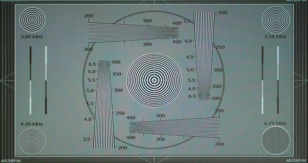

AVIA Pro Resolution test fullResolution Tests
We are checking to see that the DVD player output shows full DVD resolution at 6.75Mhz. We are also checking to see how well it scales by observing single pixel spacing around the perimeter of this test pattern. This is typically a pass/fail test.

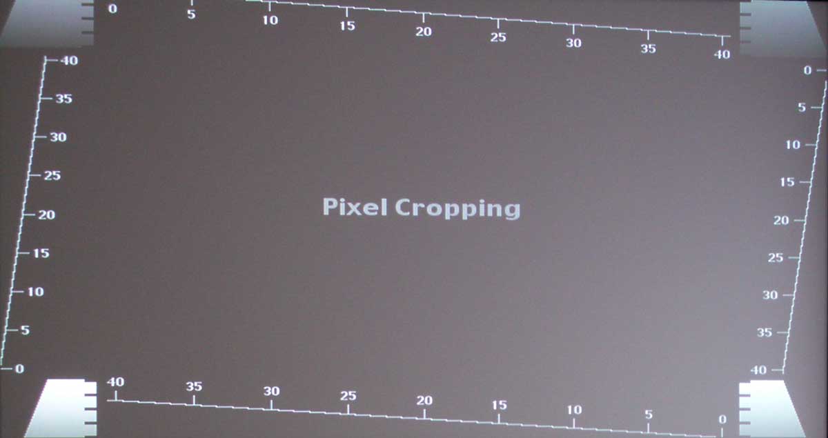

AVIA pixel croppingPixel Cropping
Using a pixel-accurate test pattern we can determine how many pixels are cropped, if any, from each side of the picture frame. Full credit is given for less than 4 total cropped pixels. More than 7 pixels fails.

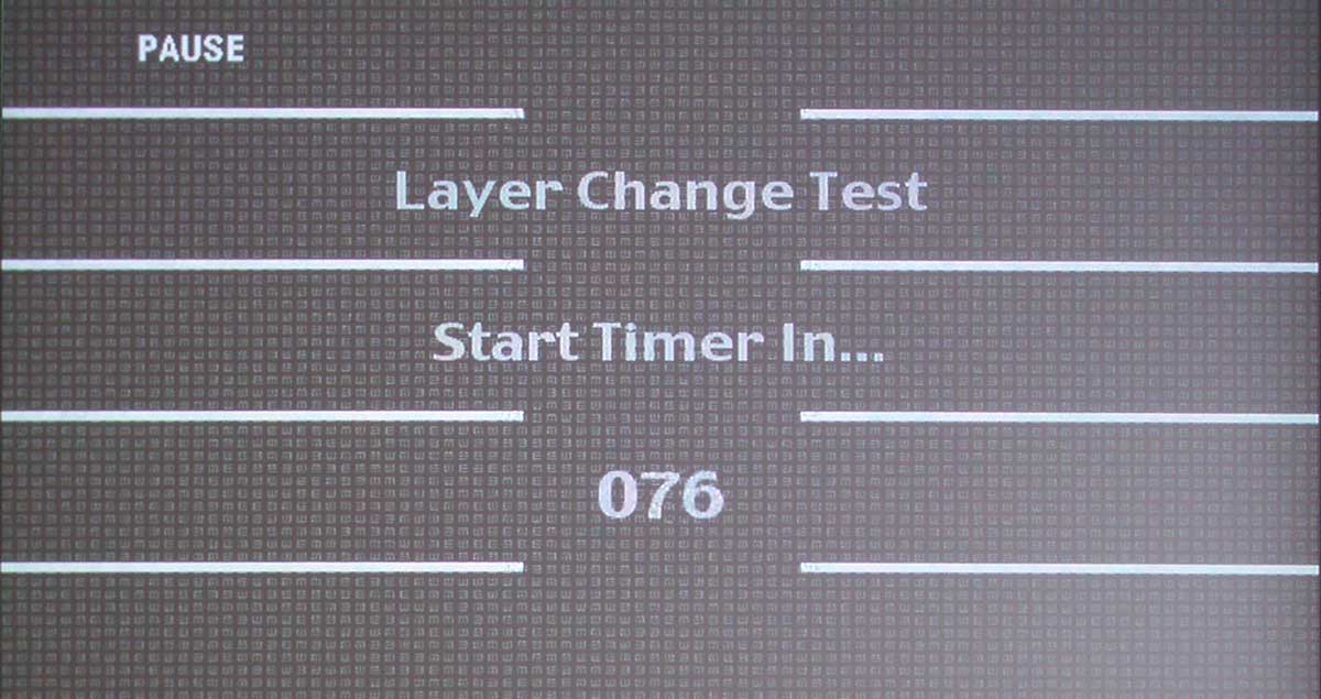

AVIA Pro layer change delayLayer Change Delay
DVD players vary in the amount of time they take to complete a layer change. We test using AVIA Pro's layer change test to time the transition. Full credit is given for anything under 1 second, while anything over 2 seconds fails.

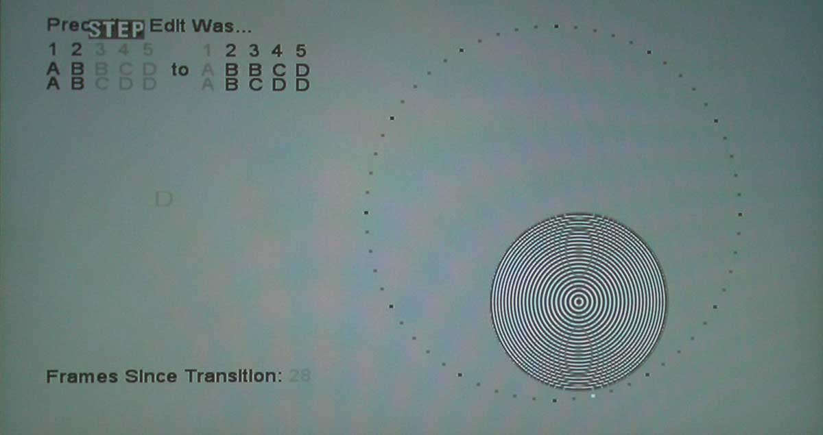

AVIA Pro Moving Zone Plate editsMoving Zone Plate - Edits
Building on the previous Zone Plate test, this adds testing of deinterlacer accuracy and recovery. This represents what players go through during scene edits that alter film cadence or vary between 2:3 and 2:2 (film and video) rates.

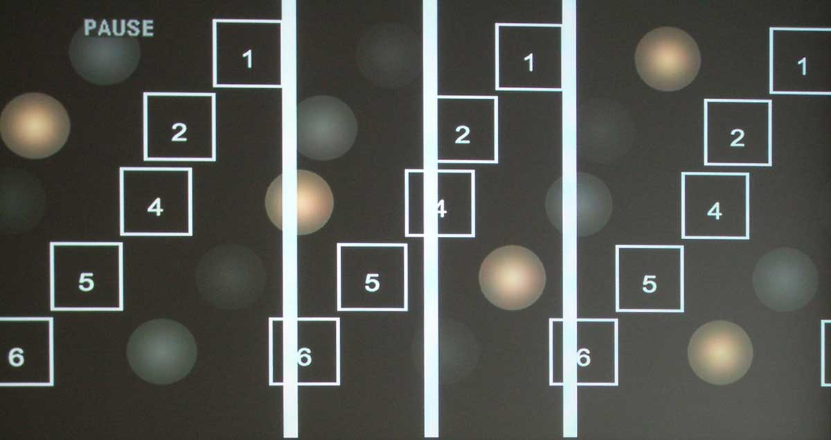

Rainbow Dither
AVIA Pro Rainbow Dither
The rainbow dither sequence tests for poor temporal dithering. Temporal and spatial dithering is an effective way to increase the effective bit depth of an image, rendering still image gradients smoothly. When these same images are put in motion, however, bit depth may decrease and show visible contouring or banding. As you can imagine, this would affect real-world pictures quite a bit with regards to quick pans and high speed motion. This test pattern is also helpful for quickly evaluating rainbow effects in DLP systems - but that is not being tested or graded in these tests. This is a pass or fail test.
