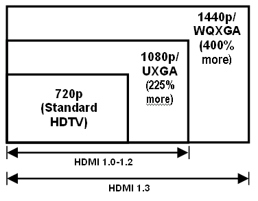

-  Higher resolution
 HDMI 1.3 can provide over 450% the resolution of 720p HDTV, and over 225% of 1080p HDTV for greater detail and larger display sizes.
 HDMI 1.3 supports video resolutions up to 1440p

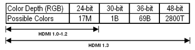

-  Deep Color
 HDMI 1.3 supports 30-bit, 36-bit and 48-bit (RGB or YCbCr 4:4:4) color depths, up from the 24-bit depths in previous versions of the HDMI specification.
 -  This will enable HDTVs and other displays to go from millions of colors to billions of colors.
-  Eliminates on-screen color banding, for smooth tonal transitions and subtle gradations between colors (See picture below)
-  Enables increased contrast ratio
- Deep Color displays can represent many times more shades of gray between black and white. At 30-bit pixel depth, a four times improvement would be the minimum, and the typical improvement would be eight times or more.
The chart below illustrates the relationship between bit depth and the number of possible colors:
