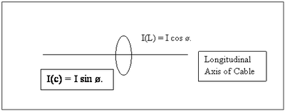

In the case of a spiral shield cable the shield current 'I' follows the spiral and is at an angle ø with respect to the longitudinal axis of the cable, as shown in the figure below.
The total current 'I' in the shield can be decomposed into two components. The longitudinal current I(L) along the cable axis is equal to I cos ø, and the circular current I(c) perpendicular to the cable axis and around the circumference of the cable is equal to I sin ø. This is shown in the figure below.
The longitudinal current I(L) acts the same as the shield current on a solid homogenous shielded cable.

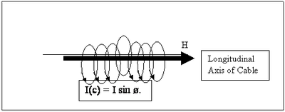

The circular current, however, forms a solenoid (coil of wire, or inductor) along the axis of the cable and produces a magnetic field along the axis of the cable. This magnetic field will increase the inductance of the shield.
In the case of an infinitely long cable (an approximation to a long skinny cable) the continuous circular current sheet will produce a longitudinal magnetic field 'H' inside the shield and no magnetic field outside the shield, as shown in the figure below.
This is just the opposite of the magnetic field produced by the longitudinal shield current, which exists outside the shield with no magnetic field inside the shield.
