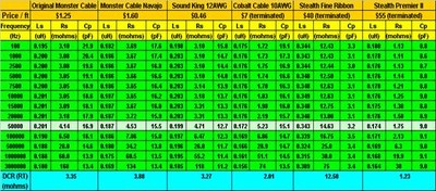

Tabulated below are the cable metrics of six different speaker cables.
Table 1: Measured RLC Parameters of Various Speaker Cables
Cable Metric Definitions
- Rdc - Commonly referred to DCR which is the series resistance of a cable at zero frequency.

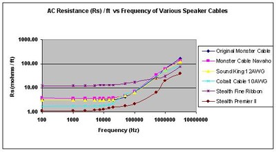

- Rac - The resistive portion of the cables series resistance as a function of frequency due to skin effect.
- Rs - Total Series Resistance (mohms) measured tip to tip at one end of the cable while the other end is shorted. Note: Rs = Rac + Rdc (minus instrumentation inaccuracies identified below)
- Ls - Series Inductance (uH) measured tip to tip at one end of the cable while the other end is shorted.
- Cp - Parallel Capacitance (pF) measured tip to tip at one end of the cable while the other end is open circuited.
Cable Measurement Test Set-Up Notes
All of the above measurements were completed on a fully calibrated and certified, WAYNE KERR Model# 3260B Magnetics Analyzer. The 3260B was calibrated for two different bandwidths for greater accuracy (100KHz or less - for audio frequencies, All Frequencies - for greater than 100KHz measurements). The measurements and calibration process was repeated twice for consistency. All cable lengths were between 6 to 12 feet and divided by their length for a normalized per foot measurement. The Monster Cable and Sound King cables were unterminated (bare wire), while the Stealth cables were terminated with spades and the Cobalt cables were terminated with banana connectors. Special care was taken to ensure solid contact was made with these cables when all Rs, and Ls measurements were taken.
At low frequencies the results illustrate Rs being lower than Rdc, which is inaccurate, as Rs tends towards Rdc as frequency approaches zero or DC. The LCR measurement derives Rs from signal phase and amplitude, while a DC meter measures exactly what it is looking for, thus this discrepancy is likely due to a meter resolution issue, as the meter in AC mode does not sport the high accuracy it would in DC mode. The cable should ideally be modeled as multiple parallel resistors, and those resistors treated as a lumped element in series with an ideal inductor. Each resistor is a frequency dependent element, and the inner ones fall out as the frequency increases. It is important to note the difference in measuring techniques, and caution the reader not to attempt to derive any relationships with the two numbers, as the absolute accuracy between the methods has not been established. However, the rising trend of Rs vs frequency is indicative of increased Rac due to skin effect and should also be noted.

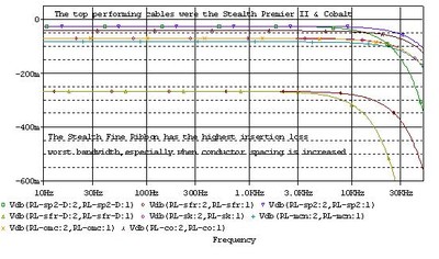

As we can see by the graph above, one of the most expensive cables (Stealth Fine Ribbon) in this comparison has the highest measured inductance. In fact, the manufacturer of this cable ships these cables and the Premier II two as separate loose conductors. The measurements above are based on keeping the two conductors as closely together as possible, using electrical tape every foot to ensure no open loop areas. When the conductors are left dangling on the floor like the manufacturer recommends, inductance measurements of these cables more than doubled! See tables 3 and 4 for the resultant impact this had on frequency and phase response.
