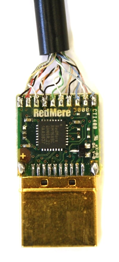

But now, HDMI cables developed with RedMere technology are taking a different approach. The cables are downright thin - and I'm talking super-thin, with wires that measure just 2.5mm in thickness. The cables contain Redmere's MEA1689 Integrated Chipset that allows sustains speeds of 3.4Gbps per channel (10.2 Gbps total). The MEA1689 is a compact module which fits inside the sink-side (display-side) casing of an active HDMI cable assembly. The cable is actually directional, so you have to pay attention to the markings to make sure the electronics are on the display/sink side.
redmere internals
MEA1689 Chipset Features:
  • Separate data equalization performed for each channel for up to 3.4Gbps
  • Clock equalization up to 340MHz
  • DDC rise time accelerator using active I2C accelerator device
  • Contains RM1689 devices for HDMI active cable equalization
  • Low power
  • No external power required
  • Supports up to 40m 1080p
  • Module size 15mm x 26mm

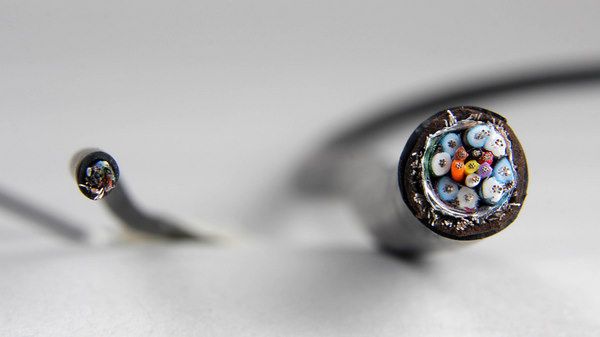

The sample cable we received can safely bend a full 180 degrees within a 3/4-inch radius. That's amazing. It's also got a HDMI connector at each end that is only 1-1/2" long, not including the 3/4" of strain relief. RedMere claims that this amounts to about a 75% reduction in cable size and weight.
Now apply this to your electronics. What kind of cable are you really going to want to connect from your iPad, iPhone, camera, or other small portable device to your TV? A gigantor cable that drags your phone off the table and onto the floor? Hardly. RedMere's technology has, for the first time, resulted in cables that are actually practical for connecting our small portable devices together. This is BIG news and really does alot to redeem HDMI in our eyes. Maybe the cable isn't a lost cause afterall. Maybe the embedded technology will continue to drop in price and companies like MonoPrice and others will be allowed to license and use it in less-expensive products en masse.
