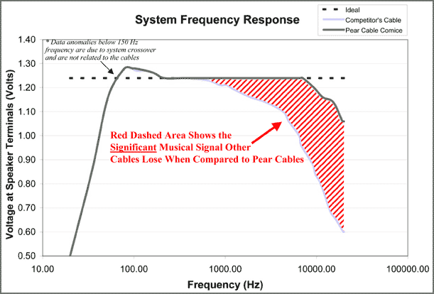

This is not to say that Pear Cables do not offer a sonic change. We now turn back to the anonymous frequencycomice fr plot response plot that compares two unnamed cables, one a Pear, and the other some competitor.
It is clear from the plot that neither cable can make a 20 kHz bandwidth with a flat frequency response. The Pear shows roll off somewhere between 8 kHz and 9 kHz, and while the other cable is indeed worse, neither is very good. Nevertheless, Pear applies bold hatching to highlight the difference in area under the curves to emphasize the superior Pear design.

Sonic neutrality is a flat frequency response from 20 Hz to 20 kHz; any deviation from flat response is quite simply coloration. The measurements are presented as voltage loss, but this is a technical slight of hand. Not presenting the plot in the more customary decibel is perhaps just enough to throw off the non technical buyer from the fact that expensive Pear Cables do not pass signal over the full audio band and is clearly is acting as a low pass filter for high frequencies. Based on the shape of the curve, I would conjecture that the cable is appealing to Audiophiles with solid state amplifiers who crave the rolled off sound of a valve amplifier, which is, of course, coloration.
As to the competitor, we have no idea who this is, for all we know, it may just be a straightened coat hanger jammed into the speaker terminals. While the competitor clearly performs worse than the unnamed Pear Cable does, the Pear still is not good. This is simply a tactic to deflect attention away from the shortcomings in the Pear cable: see, look, these guys are worse.
If Pear has spent as much time and money engineering the impedance of the Anjou speaker cables to provide a sonically neutral response as they claim, the cable response should be flat and only produce a uniform loss resulting in a slight decrease in overall volume.
What happens when the resistance gets too high? First, there is power lost in the wire and the speaker will not play as loud. More important, as the resistance in series with the speaker increases, it makes the amplifier look more like a current source. This means the speaker frequency response will tend to follow the rise and fall of its impedance curve. The greater the impedance variation, the more noticeable the response changes will be. If the speaker has constant impedance versus frequency, the only change will be reduced output.
