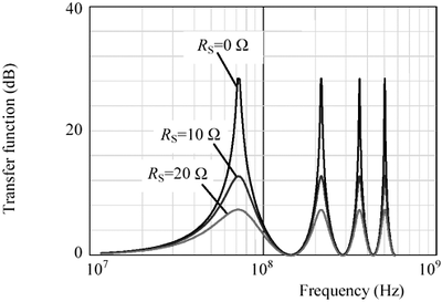

Scientific information: an unsourced statement about RFI effects on speaker cables from the American Radio Relay League, an amateur radio association:
Although this high frequency noise cannot be heard directly, it has been well documented by professional organizations such as the American Radio Relay League that RFI can still be a problem in audio applications.
Pear Cable: Anjou Speaker Cable
Expert opinion: testimonial by some guy named Richard from the Bay Area Audiophile Society supposedly based on blind testing:
The Comice Silver Interconnects kick some audio butt.
- Richard, Some Guy
The ARRL is not a professional organization, it is an amateurs or ham radio organization.  While the ARRL does provide an extensive array of educational and general technical information about radio broadcasting for its members, as an amateur organization, it is not a suitable to support professional opinions or conclusions as an engineering reference.
Furthermore, without any particular source cited for the statement there is no way to evaluate the applicability of what the ARRL might have said regarding RFI and audio to this particular audio application.  A group like the ARRL is much more likely to be discussing the problems of parking several thousand watts of RF broadcast amplification next to the neighbor's consumer audio gear than to be discussing the need for very expensive audio cables to solve the problem of random stray radio interference on someone's hi-fi.
