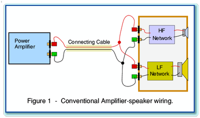

In the conventional wiring arrangement shown in Figure 1, the
HF and LF input terminals are wired together in parallel at the
speaker, and just one pair of connecting wires are employed to link
both speaker units to the amplifier. In most cases “bi-wiring” means

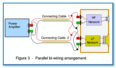

In the modified arrangement shown in Figure 3 both
cables are used “in parallel” to connect signals to both speaker units.
The question now becomes, “Are the arrangements shown in Figures 1, 2,
and 3, all going to produce exactly the same results in use?”

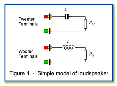

Before analysing the (possible) effects of bi-wiring we need to
establish a suitable simplified model of the loudspeaker. One of the
simplest possible arrangements is illustrated in Figure 4.
In this model the cross-over (filter) networks are deliberately assumed to be about as simple as possible. A series inductor,
, is uses to prevent high frequencies from reaching the woofer, and a series capacitor,
, is used to prevent low frequencies from reaching the tweeter. Each actual loudspeaker unit is regarded purely as an effective Radiation Resistance value,
and

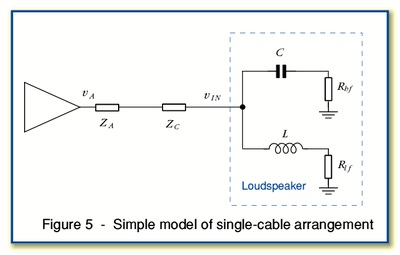

When using the loudspeaker modelled here we can now represent the situation when employing a single cable (i.e. not bi-wired) by the circuit shown in Figure 5.
Here we can represent the output impedance of the power amplifier as a series impedance,
, and the impedance of the cable by
. Note that
does not represent the characteristic impedance of the cable as a
transmission line. It is simply the series resistance and/or inductance
of the cables being used.
When the amplifier asserts an output (a.c.) voltage of
this will result in a voltage,
appearing at the loudspeaker terminals. In this simple case we know our
loudspeaker has an input impedance (tweeter and woofer sections linked
in parallel) of
. Hence we can say that
In situations where the cable and amplifier impedances
are frequency dependent (and not simply resistive) this will lead to a
frequency-dependent degree of attenuation, and some relative phase
dispersion. However if
and
are substantially resistive and independent of frequency the main
result is a small reduction in the volume of the resulting sounds. The
total load seen by the amplifier will be
at all frequencies in this situation. Hence the power efficiency of the system at all frequencies will be proportional to
The circuit is a fairly simple one and has only one current node. This means we can immediately say that
where
is the current being produced by the amplifier at any instant.

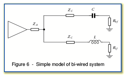

The situation when using a bi-wiring arrangement may be represented by
the circuit shown in Figure 6. For simplicity it is assumed that the
two cables are identical.
As with the previous case, if we assume the cable impedances are essentially resistive then their effect is to increase the total resistance seen in the high-frequency and low-frequency ‘arms’ of the circuit by the same amount. At first sight this seems to imply that we have essentially just altered the overall load by the same amount as before. However this may not be the case as the presence of the separate cable impedances will independently affect the nominal turn-over frequencies of the low-pass and high-pass networks employed. The special case we initially envisaged was that the turn-over frequencies (as well as the load resistances) of the two arms were identical. This meant their parallel combination was purely resistive. However we may now have ‘unbalanced’ the arrangement so that this is not longer true.
As with the single-cable arrangement, the system illustrated
in Figure 6 has a single node. Hence we can say that the power
efficiency will simply depend upon how
may vary with signal frequency. We may therefore look to see if the
total load impedance now varies with frequency as if it does, this
implies that the above bi-wired arrangement may be expected have a
frequency response that differs from that produced with a single cable.

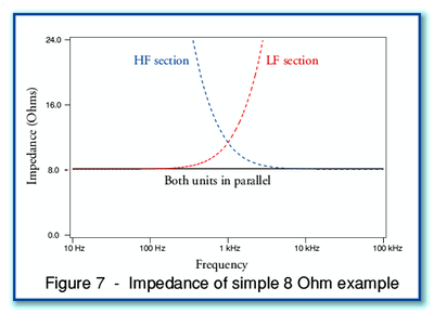

To assess the implications of the model of bi-wiring we have produced
we can now examine the results of choosing some example values. For
simplicity, the following assumes that the nominal impedance of the
loudspeaker units is such that
, and that the nominal cross-over frequency is
kHz. Figure 7 shows the input impedance of the resulting loudspeaker
system as a function of frequency. Note that the frequency scale is
logarithmic, and that in each case it is the magnitude (modulus) of the
impedance that is plotted as a function of frequency.
Figure 7 and the graphs that follow have been plotted
from numerical results obtained from some simple C++ programs. The
results shown in Fig 7 confirm that our simple model has the property
that the impedance of the LF and HF sections when used connected in
parallel is equal to
at all frequencies. This may be understood in terms of regarding the
variations in impedance of the LF and HF sections cancelling out.

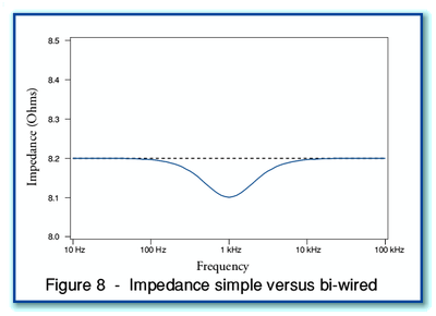

Let us now consider using an amplifier whose output impedance
is 0·1 Ohms, and cables whose series resistance is 0·1 Ohms. For
simplicity, we ignore cable inductance and assume that the cable is
essentially purely resistive. We can now compare the results of using a
single cable of this type (arrangement as shown in Fig 5) with using a
pair of identical cables (arrangement as Fig 6). Figure 8 shows the how
the total impedance seen by the amplifier varies with frequency in each
case.
The broken black line in Figure 8 shows the impedance
seen by the amplifier when using a single wire. Since this means the HF
and LF units are connected together in parallel at the speaker end of
the cable, the speaker looks like an 8 Ohm load at all frequencies. The
signal voltages being generated by the amplifier see this impedance
through the series impedance of the amplifier output and cable, thus in
this case producing a total impedance of 8·2 Ohms at all frequencies.
The solid blue line in Figure 8 shows the impedance seen by
the amplifier when bi-wiring is employed. In this case an independent
0·1 Ohms of cable impedance is seen in series with the HF and LF
sections. The parallel combination is then seen in series with the
amplifier’s output impedance. The bi-wiring arrangement can be seen to
modify the impedance of the system as seen by the amplifier in a
frequency dependent manner. The chosen cross-over frequency for this
example was 1 kHz. Looking at Figure 8 it can be seen that changing
from using a single cable to a bi-wiring arrangement caused a change in
overall impedance which is most noticeable at this frequency. In this
case it can be seen that at 1 kHz the total impedance of the system
seen by the amplifier is 0·1 Ohms lower when bi-wired than when a
single cable is employed. This change may be regarded as a consequence
of the separate cable impedances altering the effective roll-over
frequencies of the HF and LF sections so that they are no longer
identical. The result is that the system’s impedance value is no longer
constant over the whole frequency range.

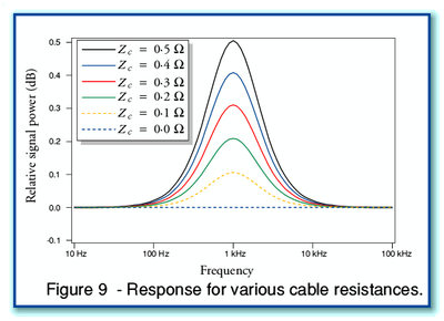

Figure 9 illustrates some examples of the changes in
frequency response which the alterations in system impedance imply may
produce. The curves are for a series of different choices of cable
series resistance/impedance,
In each case the amplifier output impedance is assumed to be 0·1 Ohms.
Hence we can use this set of plots to get an impression of how the
behaviour may vary if we change the cable resistance but use the same
amplifier and speaker in each case. Looking at the plots we can see
that for these specific examples we happen to get a variation in signal
level at the crossover frequency which, in decibels, is approximately
the same as the chosen cable series resistance in Ohms.

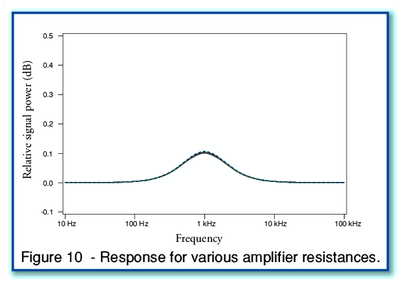

Figure 10 shows what happens if we keep the cable
resistances fixed at 0·1 Ohms, and vary the output impedance of the
amplifier. As with Figure 9, a set of curves are plotted, but in this
case for
0, 0·1, 0·2, 0·3, 0·4, and 0·5 Ohms. Looking at Figure 10, we can see
that all these plots are very similar. Indeed, they are so close
together on the graph that it is not obvious how many curves are
plotted. Considering Figures 9 and 10 taken together, leads to the
implication that – in terms of comparing bi-wiring with using a single
cable – changing the cable resistance may have an effect, but that
varying the amplifier’s output resistance has little or no effect.
The above results imply that bi-wiring may alter the frequency
response and that, when using a very simple speaker system with an
impedance of around 8 Ohms, this variation may be of the order of 0·1
dB when using cables whose series resistance is around 0·1 Ohms. Thus,
in principle, it seems possible that bi-wiring may alter the system’s
frequency response. The details of any change will then depend upon the
series impedance of the cables, and the impedance properties of the
loudspeaker.
