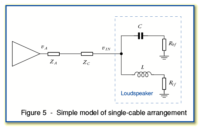

When using the loudspeaker modelled here we can now represent the situation when employing a single cable (i.e. not bi-wired) by the circuit shown in Figure 5.
Here we can represent the output impedance of the power amplifier as a series impedance, , and the impedance of the cable by . Note that does not represent the characteristic impedance of the cable as a transmission line. It is simply the series resistance and/or inductance of the cables being used.
When the amplifier asserts an output (a.c.) voltage of this will result in a voltage, , appearing at the loudspeaker terminals. In this simple case we know our loudspeaker has an input impedance (tweeter and woofer sections linked in parallel) of . Hence we can say that
equation
In situations where the cable and amplifier impedances are frequency dependent (and not simply resistive) this will lead to a frequency-dependent degree of attenuation, and some relative phase dispersion. However if and are substantially resistive and independent of frequency the main result is a small reduction in the volume of the resulting sounds. The total load seen by the amplifier will be at all frequencies in this situation. Hence the power efficiency of the system at all frequencies will be proportional to .
The circuit is a fairly simple one and has only one current node. This means we can immediately say that
equation
where is the current being produced by the amplifier at any instant.
