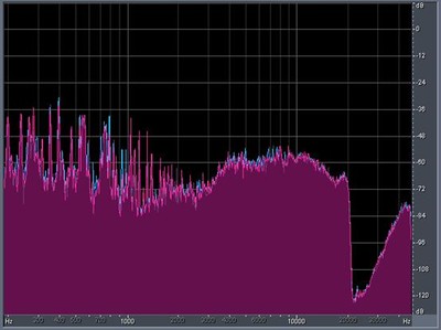

The SACD layer exhibits exactly the same brick wall at 20kHz but layered with the rising DSD ultrasonic noise from about 24kHz onwards:
Frequency analysis around
3:45 of Track 1 of SACD layer (recorded on soundcard)
I was fairly disappointed by the lack of ultrasonic frequency components on the SACD layer, as it indicates that the SACD may have been mastered from a low-resolution PCM source.
