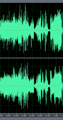

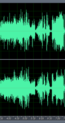

Track 11 (Nardis)
Here is a close-up showing that the SACD has much higher peaks on Track 11 ( Nardis ):
omparing an excerpt from track 11 on CD (left) and SACD (right)
Intrigued, I looked at the digital rip of track 11 from the CD layer, and found one possible explanation: evidence of clipping on the CD layer limiting the dynamics of that track. This is confirmed by the "Analyze | Statistics …" function on Cool Edit:
