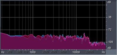

This is the noise floor from the CD recording (in the "silent" bit just before the music starts):
The noise floor seems to be hovering around the -88dB level up to 20kHz, and then drops down to below -108dB (the underlying noise floor of the sound card).

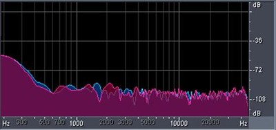

By contrast, here is the recording of the LP around the same point:
We can see why statistics often "mislead". LP's noise floor is actually quite low over most of the spectrum, ranging from -84dB around 1kHz to -96dB for frequencies above 10kHz . In other words, the LP recording has a lower noise floor than the CD recording for the majority of the spectrum (frequencies above 2kHz ).
LP's surface noise, which is responsible for the poor dynamic range, is mainly concentrated below 500Hz where the noise level is around -50dB.

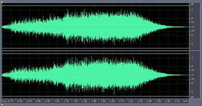

To investigate further, let's look at the actual waveforms.

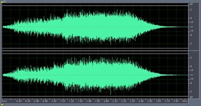

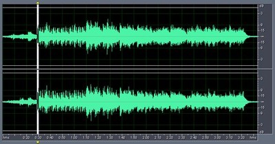

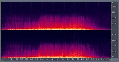

This is the waveform for the digital rip (I'll explain the significance of the highlighted selection around 30 seconds into the track later):

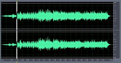

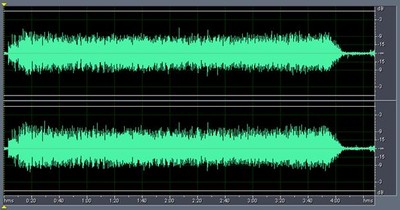

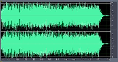

The CD recording looks very similar:

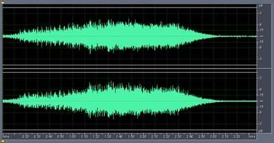

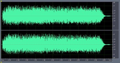

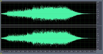

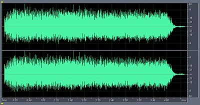

And so does the LP recording:

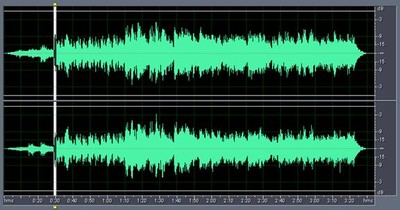

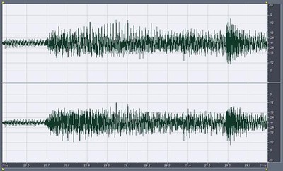

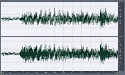

Now, let's zoom in into the highlighted section. This is the CD recording:
Note the relatively quiet section at the beginning is peaking around -24dB. The louder section that follows is around -18-12dB.
By comparing, this is the LP recording at the same section:
Notice that although the quiet section at the beginning is also around -24dB, the louder section that follows has much higher peaks, ranging from -18-9dB! This is despite both recordings having the same average RMS power (in other words, same perceived average loudness). In particular, the loud bit around 30 seconds into the track is peaking at up to 3-4dB higher on LP vs CD!

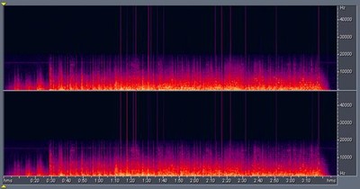

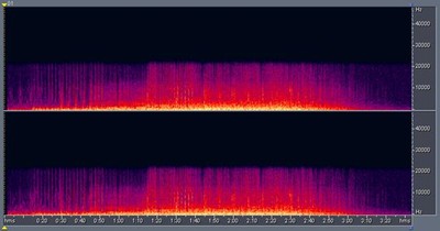

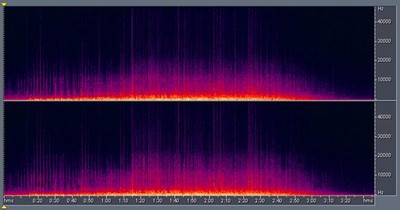

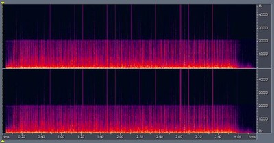

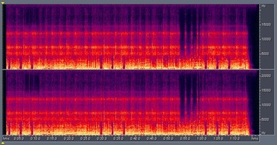

Now let's compare the spectral views of the recordings. First of all the CD recording:
As you can see, there is no spectral content above 20kHz , due to the Nyquist cutoff at 22.05kHz. The few spikes here and there are probably distortion frrom my setup.

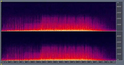

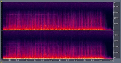

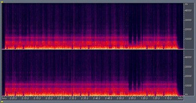

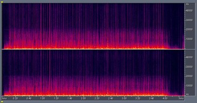

In contrast, this is the LP recording:
The LP would appear to have better frequency response, with spectral components all the way to 48kHz . However, I would caution against this interpretation of the graph (just yet). I suspect a lot of this spectral information is harmonic distortion and there is not much useful frequency content significantly above 20kHz in the original master tape. We'll investigate LP's usable frequency response in more detail later.
