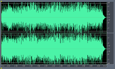

This is how the waveform looks like:

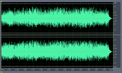

This is how the CD recording looks like:

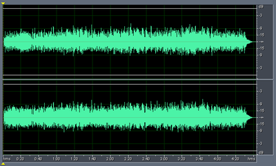

By comparison, this is the SACD recording:
As we can see, even on the same player, the SACD playback is about 4dB quieter than DVD-A. If a listener compares the two discs without adjusting for the level differences, there will be a tendency to prefer the louder version (DVD-A).
