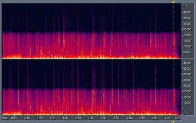

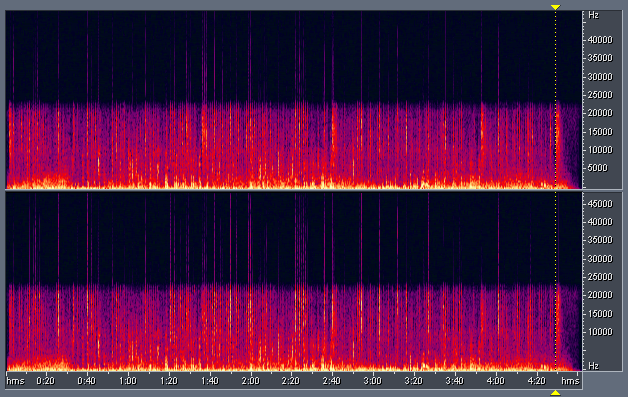

First of all, the EAC rip:
Note the total absence of any frequencies above 22kHz, as to be expected given the 44.1kHz sampling rate.

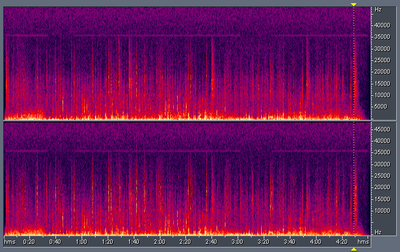

Now, this is the same CD track but as played by the Sony and captured using the Prodigy:
Interestingly, various points in the track are "corrupted" by high frequency "spikes". I am not sure what is generating this noise, but it could be a combination of the player, the amplifier and the sound card.

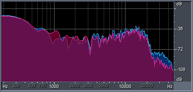

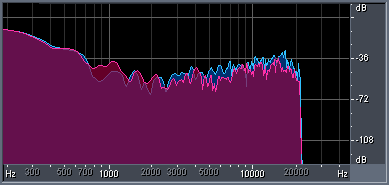

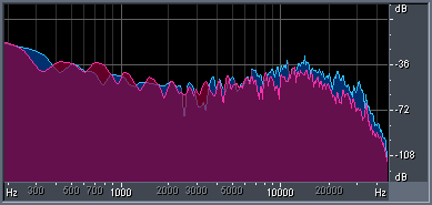

Here is a frequency analysis at 4:29 into the track (at the point represented by the yellow dotted line in the graph above):
Notice, again, the severe drop off above 22kHz. In comparison, the EAC rip at around the same point is similar, but without the ultrasonic noise:
It looks like Sony has opted for a gentler filter roll off (probably achieved using upsampling).

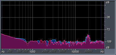

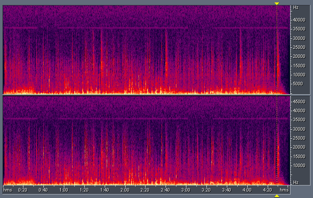

By comparison, this is the spectral analysis for the DVD-A:
Note that we have true frequency content above 22kHz all the way up to around 36kHz. The spikes above 36kHz are probably the same "noise" found on the CD version, although I cannot confirm that. The purple horizontal lines around 36kHz is probably the analog tape bias.

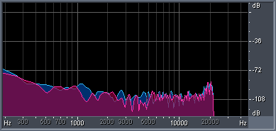

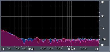

The frequency analysis around 4:29 for PCM looks like this:
Again, this confirms the presence of real musical content above 20kHz, but dropping off fairly significantly past 30kHz. I suspect there is no real usable musical information above 30kHz.

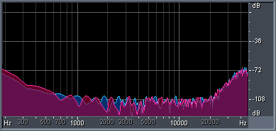

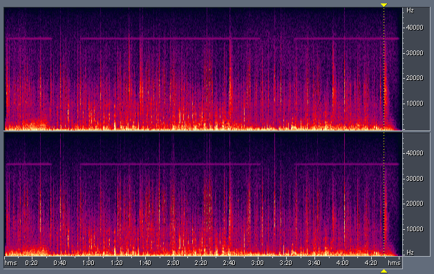

In comparison, this is how DSD looked like:
As you can see, DSD is almost as good as PCM in capturing ultrasonic frequencies, but at the cost of higher ultrasonic noise (note the purple specks above 35kHz).
Frequency analysis at 4:29 :
As you can see, DSD offers a response very similar to PCM except for the overlay of the ultrasonic noise above 30kHz.
