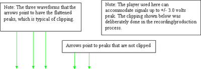

One of the major problems that have cropped up in many of the pop music releases in the past 5 to 6 years is level control. I have painfully listened to my step kids CDs and heard the shrilling sounds they conveyed. I wasn't surprised when I hooked up the CD player's analog outputs to my oscilloscope and observed levels so high that they were clipping on a consistent basis. One normally thinks of clipping as a power amplifier problem, yet clipping in the digital domain can be just as bad. But before we go further let us define a basic explanation of what digital clipping is and how it relates to audio applications.

This oscilloscope photo was taken from a recent Jennifer Lopez Pop CD release . The author has found this to be typical of many new pop music releases:
