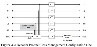

When the subwoofer channel is fed bass from the five or seven main channels all set to "small", the summed output must be attenuated to avoid overloading the subwoofer channel as can be seen in the above bass management block diagram courtesy of the Dolby Digital Decoding Guidelines specifications. The summed output can then be boosted in the analog domain to properly match the other channels. Early DVD-A / SACD player models didn't properly handle this and often resulted in anemic bass response. Denon was the first receiver manufacturer to address this via their analog inputs by offering a +10/+15dB bass boost for the subwoofer channel. Others soon followed suite by either adding the gain back in their players to resolve this issue or offering the boost option in their complimentary A/V receivers external multi channel analog inputs.
Both Oppo Digital and I re-tested the BDP-83SE player to verify its bass management system adhered to the functionality shown in the above block diagram.

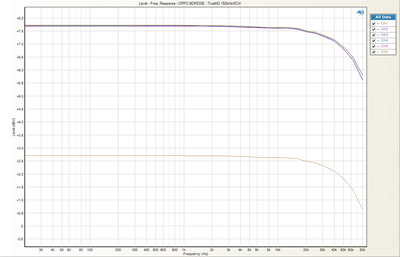

Oppo BDP-83SE Frequency Response (all channels "large")
All speakers set "Large", test signal 192kHz TrueHD, 0dBFS, all channel trims set to 0.0dB
The output
level was 7.7dBV (2.43Vrms) for the 5 main channels and 2.7dBV (1.36Vrms) for the
subwoofer channel. This result indicated that all channels, including the LFE channel were recorded at 0dBFS in the test
signal. The player adds 5dB attenuation to the LFE channel so the subwoofer output is 5dB
lower than the main channels.

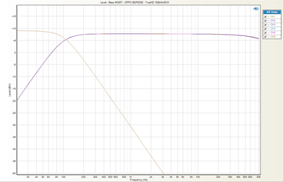

Oppo BDP-83SE Frequency Response (all channels "small")
All speakers set to "Small", test signal 192kHz TrueHD, 0dBFS, all channel trims set to 0.0dB
Recall that Oppo's implementation of 0dBFS corresponds to a 2.43Vrms output level. So by setting all channels to small and summing the combined response plus LFE channel, we achieve the following output level to the subwoofer channel:
- LFE - 5dB = 1.36V
- Left - 15dB = 7.7dBV - 15dBV = -7.3dBV = 0.43Vrms
- Right - 15dB = 7.7dBV - 15dBV = -7.3dBV = 0.43Vrms
- Center - 15dB = 7.7dBV - 15dBV = -7.3dBV = 0.43Vrms
- Surround Right - 15dB = 7.7dBV - 15dBV = -7.3dBV = 0.43Vrms
- Surround Left - 15dB = 7.7dBV - 15dBV = -7.3dBV = 0.43Vrms
Since the bass for each channel can be considered a correlated audio source, we simply sum them to get the equivalent subwoofer output as follows:
- 1.36V + 5(0.43) = 3.51Vrms or 10.9dBV for 5 channels and
- 1.36V + 7(0.43) = 4.37Vrms or 12.8dBV for 7 channels
Clearly both the 5 channel and 7 channel cases exceed Oppo's 2.43V 0dBFs reference signal level. Thus in reality the BDP-83SE does pass 0dBFS levels but not 0dBFS+ levels which result when all of the channels are set to "small" and a 0dBFS test signal is fed into the player. This was something we did not take into consideration when initially measuring the BDP-83SE. Incidentally we did measure other BD players that could properly pass a 0dBFS signal with all channels set to small but also noticed in one particular case their 0dBFS reference was only 1Vrms instead of the 2.43Vrms of the BDP-83SE. It's quite possible the manufacturer in this particular case decided to scale back the incoming signal level in the DSP prior to mixing and converting to analog for this very reason.

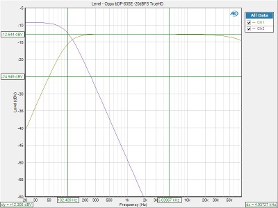

Re-Test of Oppo BDP-83SE Bass Management
Using a -20dBFS 192kHz Dolby TrueHD test signal and all channels set to "small" with trims all set to 0dB, we measured the above response curve. Channel 1 is the Main L channel while channel 2 is the subwoofer channel. As you can see the -3dB point for both the HPF and LPF's is 100Hz which agrees with Oppo's findings as well. We asked them to implement a "THX" mode that offers the following alternative filter response which they claim to be looking into at this moment:
- HPF: -3dB @ 80Hz, 12dB/octave
- LPF: -6dB @ 80Hz, 24dB/octave

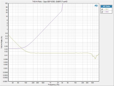

Oppo BDP-83SE THD + N
With a -20dBFS test signal, the BDP-83 was able to reproduce playback levels at impressively low distortion levels (0.03% THD + N for the subwoofer channel and 0.015% THD + N for the main channels).
